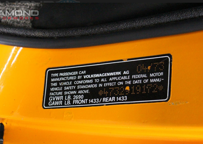

Has the VIN listed as "473291972" but assuming they mean 4732901972 which isn't in the VIN database.
Has the front euro turn signal lenses and the kit to relocate the parking light to the bottom, so some previous owner was detail oriented lol..
Rob-O
Actually looks like 4732919172…except for the tag on the top of the passenger fender. That VIN is tough to read but what I can make out likes like a 212 together, which doesn’t make sense. The seams around that area look bodgy as well.
The tag on the front headlight bucket looks correct. Of course it’s missing the money shots. Looks like a nice car but as with everything it’s best to put eyes on it before purchasing.

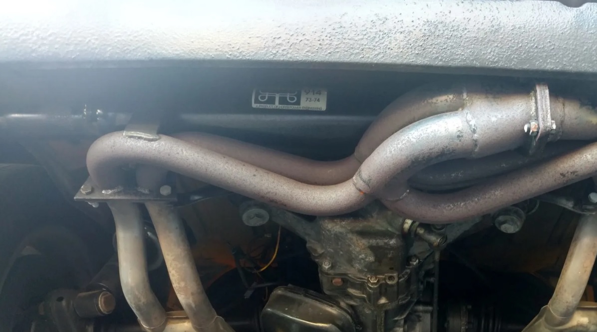

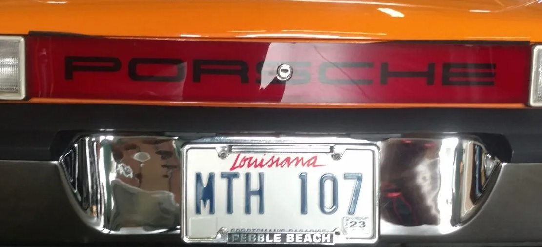

Who puts an aftermarket reflector, a rusty bursch exhaust, removes the rear trunk springs and swaps out the heat exchangers on a 6k mile car?
Also:
looks like the ignition tumbler has been swapped out.

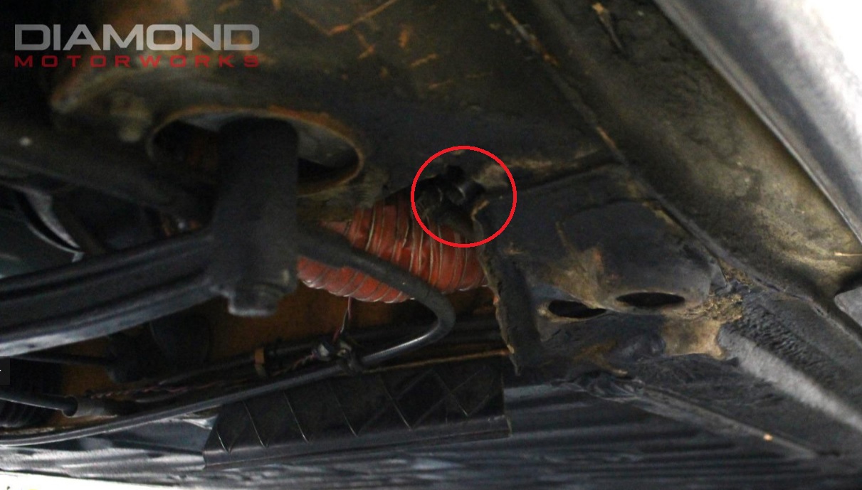

Seems to be some questionable wiring hanging down by the trans and along the lower firewall.
and is that overspray i see on the drives door VIN sticker?
Quite a few other things seem off as well. i dont buy that its only been driven 6k miles.
106k maybe... maybe

Who puts an aftermarket reflector, ............ on a 6k mile car?
i'd say its been on there since new or near new.
(fortunately it was not done to mine. smile.gif )

the BAT ad is interesting as it implies the rear reflector was fitted as part of a "special dealer package" when the car was new!!!! smile.gif pretty funny that the dealers were tarting them up like that. if you look close the rear trunk lock is drilled through the reflector which is very unusual. most later aftermarket installs used a remote release.
also came with the bursch exhaust. all is not what it seems. ie its actually original from the showroom - maybe not factory, but showroom - (but restored).

May be the connector for the original fuel pump.
What is the twisted pair of wires by the hand brake cable?

I am more concerned about the apparent VIN mis-match between the VIN tag in the trunk and the stamped passenger fender VIN in addition to the overall condition of that inner fender top surrounding the stamped VIN. Otherwise, looks like a decent car with over 100K miles.
Puebloswatcop
It looks like a nice car, however this car would never pass a certified VIN Inspection. The VIN mismatches would be a real problem. The body stamped VIN is tampered with and the VIN plate in the frunk looks like it has been tampered with as well. Would be nice to see the VIN Tag on the A Pillar

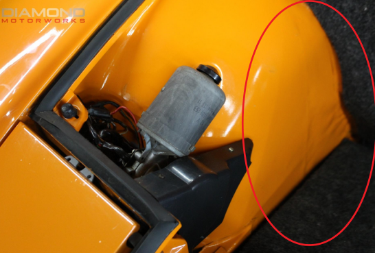

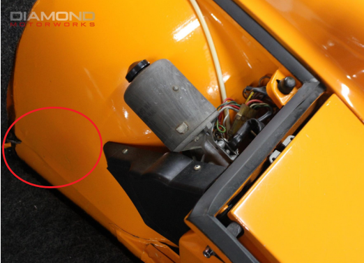

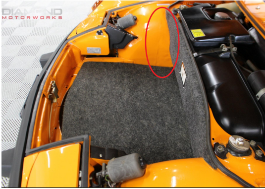

The driver side corner of my car was clipped long ago before I bought it with crappy lap welding to boot (still needs to be fixed as of 2022). It was hidden far better than this.
Driver side appears to have a slight buckling / kink from the hit too.

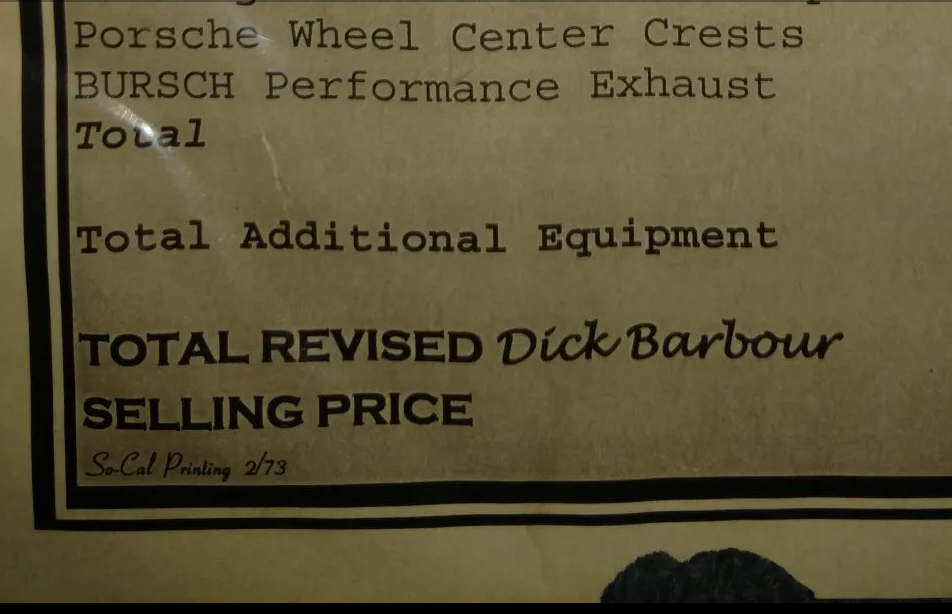

Wow, I hadnt seen the BAT ad previously but now that I have I am moving my opinion on this car from "misleading" to "outright fraud"
Way to much fishy crap with that "Dick Barbour window sticker" not the least of which being im pretty sure Dick didnt have access to a time machine to source a laser printer to produce window stickers with.
Would love to have that paper in my had to take a close look, but as someone that spent part of my life working in both printer development and forgery investigations, this sure looks like a load of stromberg.gif to me from here.
The taking a candle to the corners of the paper to make it look old is a good try though.
I can only assume the current owner realized its level of fakeness which is why it isnt included in the latest ad.

Nice!
Now in going back and looking at the BAT "window sticker" I notice it has "So Cal Printing 2/73" on it.
Yet, Vehicle was manufactured 4/73?
I guess they knew months, and months ahead of time how there were going to equip it at the dealership? There was a 2 month lag to when the car was built, and then there would have likely been another 2 months or longer for the car to ship from port, inland transport, etc.? No concern for exchange rate fluctuations w.r.t. pricing, etc.?
Sure would be awesome if we have an offset printing expert . . . . are the fonts even viable for that era of offset printing?
The stromberg.gif smell is getting worse.
Not sure about the fonts themselves (though i also questioned that) as I was not around in 1973 but I did spend a few years working for Epson in photo printer development and have spent more hours staring though a loupe at printouts than any sane person should.
I feel very confident in saying that "window sticker" came off a modern printer in a single pass vs any dealer window sticker older than maybe 20 years ago that would have had the line items entered on an impact printer of some sort (typewriter, dot matrix, etc) over a pre-printed form or card.
the paper itself also appears to be a more modern heavy weight sheet used with laser prints vs light weight perforated roll paper dealers usually use. I cant tell without having a closer look if it is ink jet or laser, but it looks like laser from here. The gradient background, the borders, the alignment, pretty much all if it screams modern computer generated printout to me.
Not to mention the fact that border perfectly encapsulates the exact number of line item options the car has...
nope, this was laid up on a computer and printed with a modern printer.
also, is it just me or do some of those prices seem a little questionable for 1973?

yup wiped out from the right side, pulled back out as best as they could, wheel well clip, fender installed improperly, (wide gap) wrinkling and distortion remain in the front trunk area. Also who would replace carpets in a car with only 5000 miles on it?

QUOTE(dr914@autoatlanta.com @ Aug 6 2022, 11:44 AM) *
You know, I have no problem with 914s that have been damaged/repaired, every one i have ever owned has been to some extent.
But trying to pass it off on an unsuspecting buyer as "unmolested" and "arguably the best in the world" along with forging documents and VIN discrepancies I take issue with. If this isn't outright criminal it sure feels close.

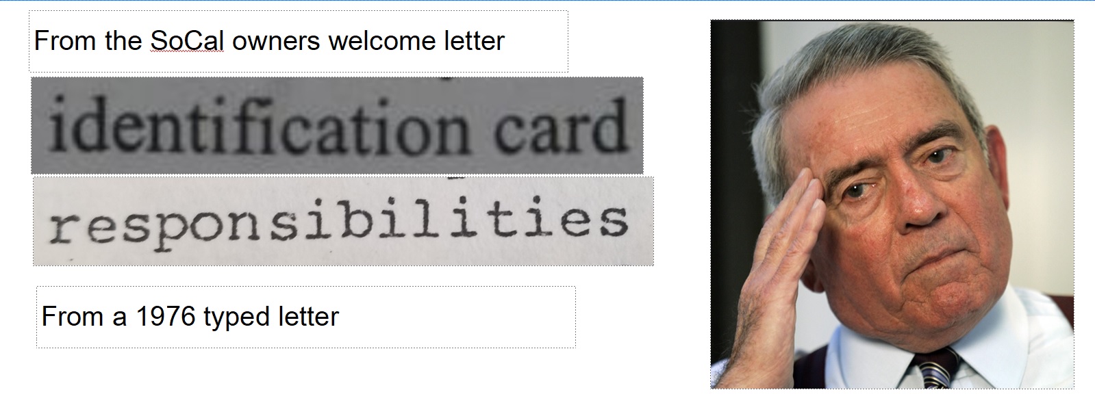

I was thinking the same about the owners club of southern California letter — looks like it's printed on a laser printer in Times New Roman. Criminal that someone would go to the trouble of creating a fake history for this car.

yep
was a world of ollivetti typewriters back then.
interesting about the dick barbour porsche thing.
can understand it would be a replacement bursch exhaust when restored.
but that the window ad is fake. real interesting.

JamesM
QUOTE(wonkipop @ Aug 6 2022, 01:49 PM) *
on + side current seller is not trying to hide front right corner replacement.
(or more total front replacement???)
conveniently concealed in older BAT ad by not going there with photos.
Im wondering if they just didn't notice it as they did seem to strategically leave out a lot of other standard shots (that were in the BAT auction) that give away the history/condition of the car. (battery tray shots from the BAT auction showing clear overspray and weld repairs to the rear trunk hinge piviot, anything showing the size of the engine that was also not mentioned in the ad, etc)
Given their careful wording in the ad and selective representation of the car in the photos I was curious if the dealer themselves were involved in the initial forgery or if they are just passing along a bad deal...
Long story sort still dont know if they are part of the fraud or just got caught in a bad deal, but they do seem to be very careful about directly incriminating themselves while at the same time hiding the reality of this car. They answered my wifes first question about the motor size and did state it to be a 1.7 but follow up questions around condition/history and they just outright stopped talking to her.
Notice how they dont directly state anything in the ad text itself. rather just post pictures of (most likely fake documents) of someone else saying how original and amazing the car is. SUPER fishy
i suspect they are looking to drop this on a sucker sight unseen who doesent ask questions.

what is most amusing is that pebble beach organisers didn't have a clue back in 99?
Given all the other BS and forgery surrounding this car I have to wonder the legitimacy of that claim as well. Also worth noting only the BAT ad states:
"The seller reports that the car was invited to participate in the 1999 Pebble Beach Concours d’Elegance, and a badge affixed to the dashboard is depicted above."
Which again was just the statement from the seller and the current seller doesn't mention that at all. Also that was 23 years ago, the car could have been in perfect condition back then? Who knows. My guess though is that the badge on the dash is just more added flair to try and represent this car as something it is not.
because they dont seem super hard to come by
https://www.ebay.com/itm/204015680353?hash=...%3ABFBMhou41M5g
Unless someone out there has documentation or photographic evidence of the car being there. I was unable to find anything to substantiate the claim.
QUOTE(dr914@autoatlanta.com @ Aug 6 2022, 12:44 PM) *
wonkipop
@JamesM
is that another fake document you can see underneath the dick barbour cigarette burn tortured window sticker?
detail from one of the BAT images previous sale.
meant to be Porsche + Audi order/sales form for car originally?
they should look like this?
fake order form would be interesting.

@JamesM
its pretty hard to find out anything about pebble beach concours 1999 on a search.
early enough not to end up instagramed everywhere.
did all my usual tricks and zero came up.
just some documentation of class winners.
which this car was not. unsurprisingly.
"The five-digit odometer shows 5,400 miles, which is most likely 105k miles based upon overall condition"

QUOTE(wonkipop @ Aug 6 2022, 03:13 PM) *
@JamesM

i think you are right about the pebble beach plaque.
someone has picked one up and screwed it on.
you could get away with a fair bit back in 2004, even more in 99.

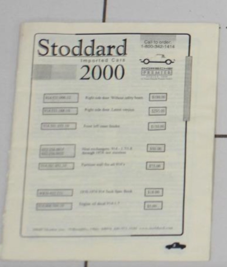

amongst displayed documents.
looks to me like mid engined views (914 owners association newsletter) that has lost its cover.
dates from 2000 (stoddard ad)?
maybe this car has a story about it or pebble beach.
dates would be right.
if anyone has those from that time its probably in there?

Yes, that's not a '73 speedo - should be 150MPH. Also, FWIW, '73s had silver PORSCHE lettering on the engine grille.
I was hesitant to think someone went to all the trouble to forge documents, but there's just too much wrong - including the way "Dick Barbour" was always inserted with a different font - even in the welcome letter. So George Duncan had so many new members to welcome (in 1973) that he pre-typed a supply of welcome letters and had them on hand to add names & dates? Using a different typewriter. Also, suspicious amount of extra info re: the Chrome Plated card holder and where you might put it.
But what finally convinced me is the proportional spacing.
Ron
nathanxnathan
QUOTE(jrmdir @ Aug 7 2022, 10:14 AM) *
ou might put it.
Ron
Spacing of modern fonts, they call it "hinting" where the font knows how close to put certain letters together.
There's an even more telling hint in your example, when an "f" and an "i' are typed next to each other the font will replace the 2 glyphs with a "smart ligature" which is a single character so the tip of the "f" sort of meshes with the dot of the "i". A typewriter would not do this.
Another tell is the double spaces between sentences. With a typewriter you would indeed have to put 2 spaces after a period to make it look right. A modern font, using hinting, automatically puts a larger space after a period. A lot of people put the 2 spaces in still — so many people that even young people that never used a typewriter think it's correct to do so. It ends up looking like there are 3 spaces (as a typewriter would make them) between sentences.
I'm a graphic designer by trade, and it strikes me as glaringly obvious that it's not legit. biggrin.gif

I have been to every Pebble Beach Concourse bar 1 since 1981 and I have never seen a 914-4 and they would never accept a 914-4.
