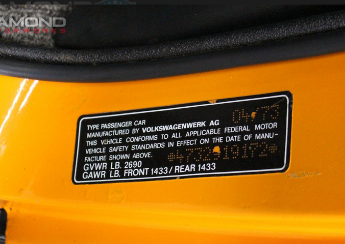

Has the VIN listed as "473291972" but assuming they mean 4732901972 which isn't in the VIN database.

Actually looks like 4732919172…except for the tag on the top of the passenger fender. That VIN is tough to read but what I can make out likes like a 212 together, which doesn’t make sense. The seams around that area look bodgy as well.
The tag on the front headlight bucket looks correct. Of course it’s missing the money shots. Looks like a nice car but as with everything it’s best to put eyes on it before purchasing.

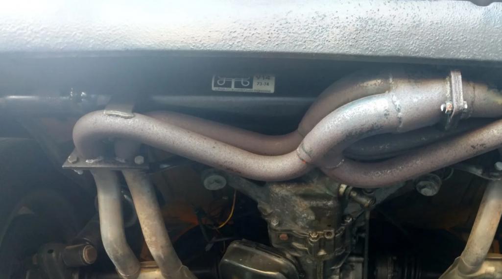

Who puts an aftermarket reflector, a rusty bursch exhaust, removes the rear trunk springs and swaps out the heat exchangers on a 6k mile car?

Seems to be some questionable wiring hanging down by the trans and along the lower firewall.

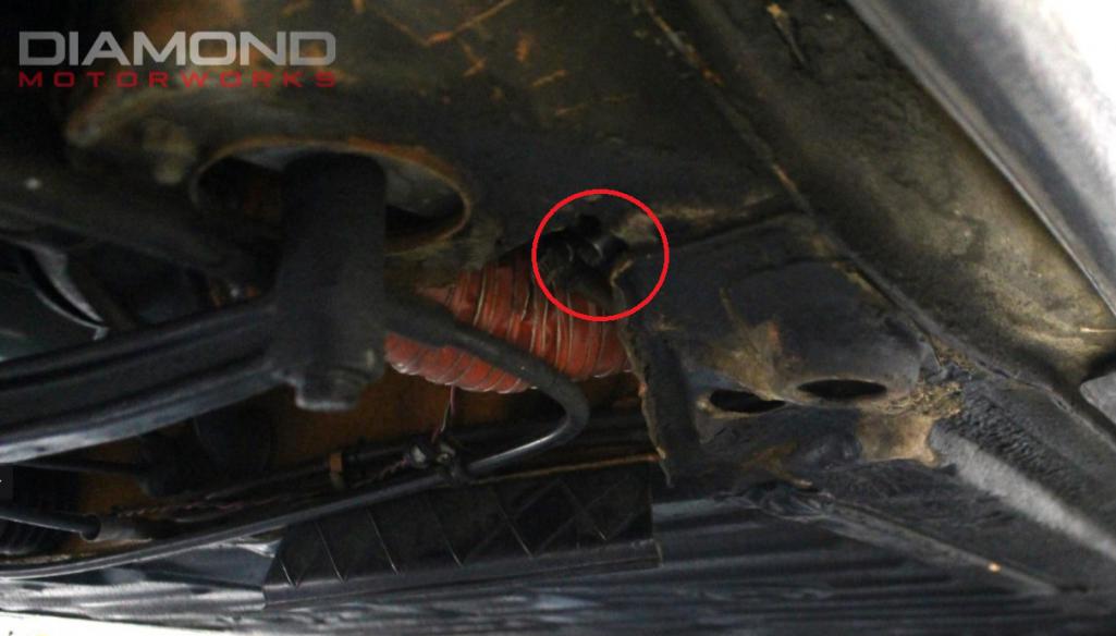

(IMG:style_emoticons/default/WTF.gif)
is that a socket?

QUOTE(JamesM @ Aug 6 2022, 02:14 AM) *
is that a socket?
May be the connector for the original fuel pump.
What is the twisted pair of wires by the hand brake cable?

I am more concerned about the apparent VIN mis-match between the VIN tag in the trunk and the stamped passenger fender VIN in addition to the overall condition of that inner fender top surrounding the stamped VIN. Otherwise, looks like a decent car with over 100K miles.

It looks like a nice car, however this car would never pass a certified VIN Inspection. The VIN mismatches would be a real problem. The body stamped VIN is tampered with and the VIN plate in the frunk looks like it has been tampered with as well. Would be nice to see the VIN Tag on the A Pillar

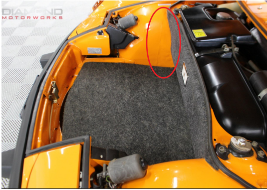

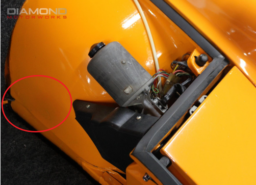

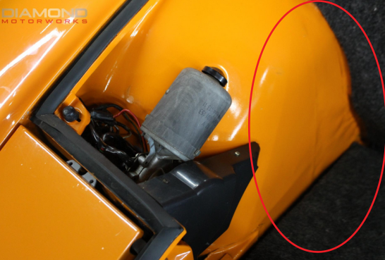

The driver side corner of my car was clipped long ago before I bought it with crappy lap welding to boot (still needs to be fixed as of 2022). It was hidden far better than this.
Driver side appears to have a slight buckling / kink from the hit too.

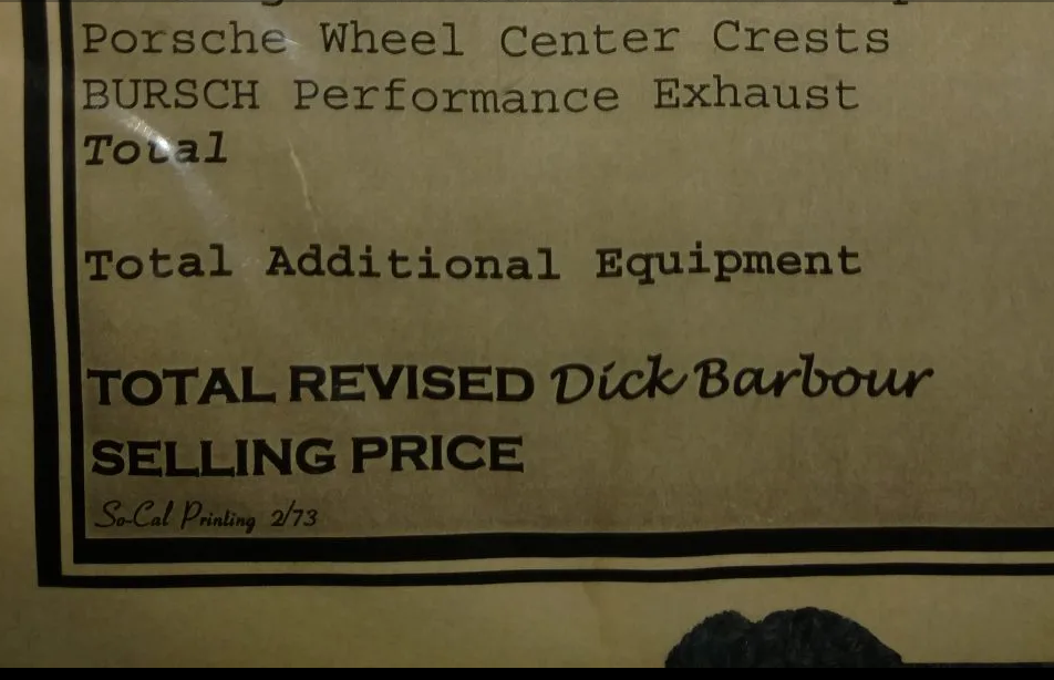

Wow, I hadnt seen the BAT ad previously but now that I have I am moving my opinion on this car from "misleading" to "outright fraud"
Way to much fishy crap with that "Dick Barbour window sticker" not the least of which being im pretty sure Dick didnt have access to a time machine to source a laser printer to produce window stickers with.
Would love to have that paper in my had to take a close look, but as someone that spent part of my life working in both printer development and forgery investigations, this sure looks like a load of (IMG:style_emoticons/default/stromberg.gif) to me from here.
The taking a candle to the corners of the paper to make it look old is a good try though.
I can only assume the current owner realized its level of fakeness which is why it isnt included in the latest ad.

Now in going back and looking at the BAT "window sticker" I notice it has "So Cal Printing 2/73" on it.
Yet, Vehicle was manufactured 4/73?
I guess they knew months, and months ahead of time how there were going to equip it at the dealership? There was a 2 month lag to when the car was built, and then there would have likely been another 2 months or longer for the car to ship from port, inland transport, etc.? No concern for exchange rate fluctuations w.r.t. pricing, etc.?
Sure would be awesome if we have an offset printing expert . . . . are the fonts even viable for that era of offset printing?
(IMG:style_emoticons/default/lol-2.gif) (IMG:style_emoticons/default/lol-2.gif) (IMG:style_emoticons/default/lol-2.gif)
Nice catch, I noticed the "SoCal printing" and that that company has only been around 15 years (and also who the hell has a printing company print individual window stickers for their cars?) but i didnt even notice the 2/73 date on it.
This just keeps get funnier... and sadder.
They put more effort into a forgery then they did just finding original parts for the car to convince people it is legit.
Morons.
Not sure about the fonts themselves (though i also questioned that) as I was not around in 1973 but I did spend a few years working for Epson in photo printer development and have spent more hours staring though a loupe at printouts than any sane person should.
I feel very confident in saying that "window sticker" came off a modern printer in a single pass vs any dealer window sticker older than maybe 20 years ago that would have had the line items entered on an impact printer of some sort (typewriter, dot matrix, etc) over a pre-printed form or card.
the paper itself also appears to be a more modern heavy weight sheet used with laser prints vs light weight perforated roll paper dealers usually use. I cant tell without having a closer look if it is ink jet or laser, but it looks like laser from here. The gradient background, the borders, the alignment, pretty much all if it screams modern computer generated printout to me.
Not to mention the fact that border perfectly encapsulates the exact number of line item options the car has...
nope, this was laid up on a computer and printed with a modern printer.
