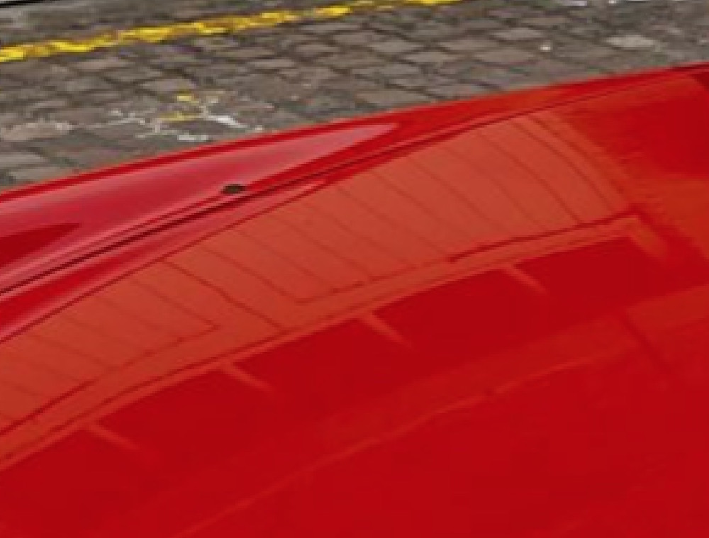

look at the door inners where the karmann badge is?
check hinge pins etc.
if it is a repaint its a very good one. better than your typical american, aussie, and esp english. in fact better than any i have ever seen.
might have been touched up here and there maybe.
very easy way to tell.
stick head up under dash and inspect under cowls and back in front trunk near bonnet hinges. paint goes thin in those areas on the factory paint cars.
restorers get way too much paint all over the car everywhere. smile.gif smile.gif
i can't see in the photos if thats the case.

reading the description i'd say that car is 99% legit.
given who owned it along the way.
dr 914 is probably right, photos look better than it actually is.
but lets not forget, the doctor has a stake in this one given his other green one.
(i see claim in description porsche once considered it best example left, but that was back in 94!! biggrin.gif ).
the dr.'s green 6 is better. that i can tell from photos.

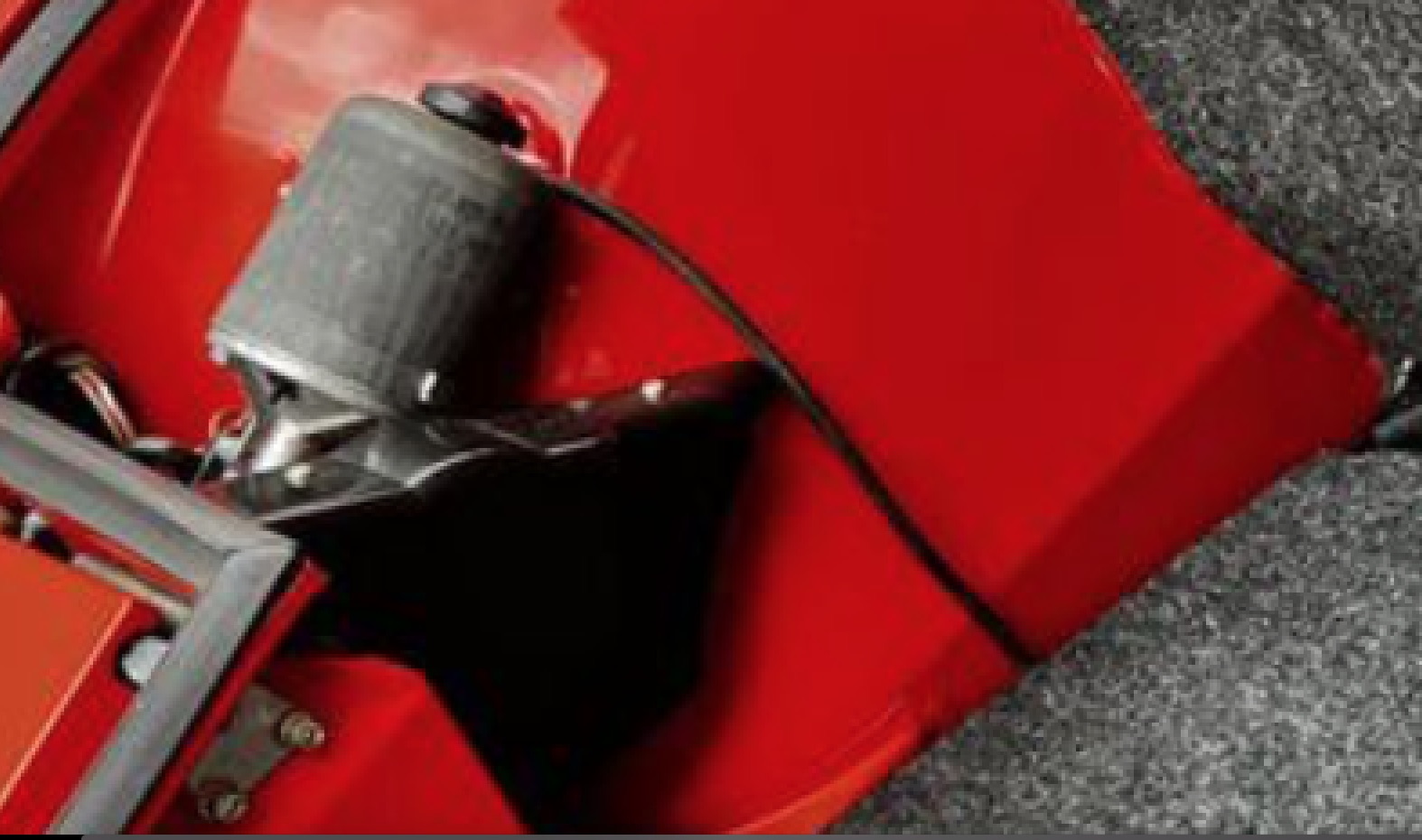

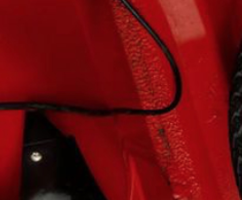

The work on this panel is terrible… why?
Pic #11 is the inner wheel well seamed in the middle?
Beautiful car but would say that the right front has been in an accident.

well spotted mr jett.
spare tyre filler tube artfully draped across to disguise it in photos!!!!?
(did 72 6s have the crazy VW spare tyre driven washer thing, i notice that in other photo of front trunk the valve and tube seem to be there. thought the 6s had the pump?)
few "stone chips" in the bonnet.
looks like they have been brushed with rust convertor.
which makes me think whatever happened on front right was back in time.

@Jett
its really hard to tell whats going on with that inner guard.
something looks like its happened.
could be as innocent as a bad gouge/scratch that has been touched up.
can't see where the repair if it is one goes at the top end or the bottom.
there are a lot of mottled artefacts in the digital photos which make it hard to really see.
maybe its a sign that some bastard did actually drive this baby pre 1979 and gave it a bit of stick and slid it into a ditch or put it through an english hedgerow. biggrin.gif
