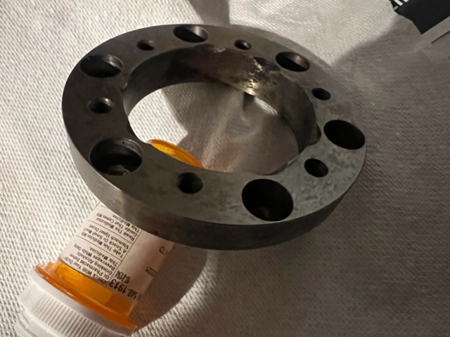

For the 5mm spacer (washer) you need for the hub to stub axle you can get washers at McMaster Carr industrial supply.
This is a 108 to 110 mm cv joint adapter. I don't know where these came from got them on trade for something else. Give CMS California Motorsports they may have these in stock.
