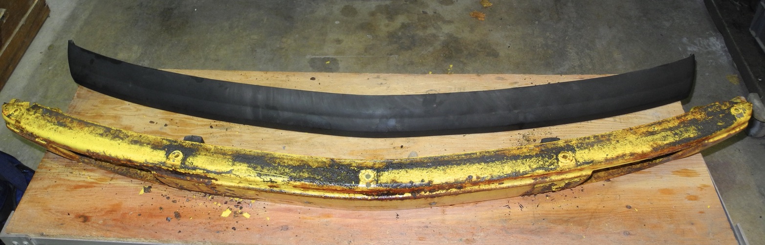

I have successfully removed the bumper top with all studs intact. Huzzah!
I've completed the first phase of cleaning the interior, which consisted of clearing out all the debris from 35 years of sitting. That also included visors, driver's door storage box, coco mats, busted inside mirror and assorted screws, bolts and fuses left in the console storage box.
I've taken pics of the aluminum rivets in the rocker covers and the newly separated bumper top, but alas I can't seem to post them at present. I know, I know, if there's no picture it didn't happen. You'll just have to wait til I get it figured out.

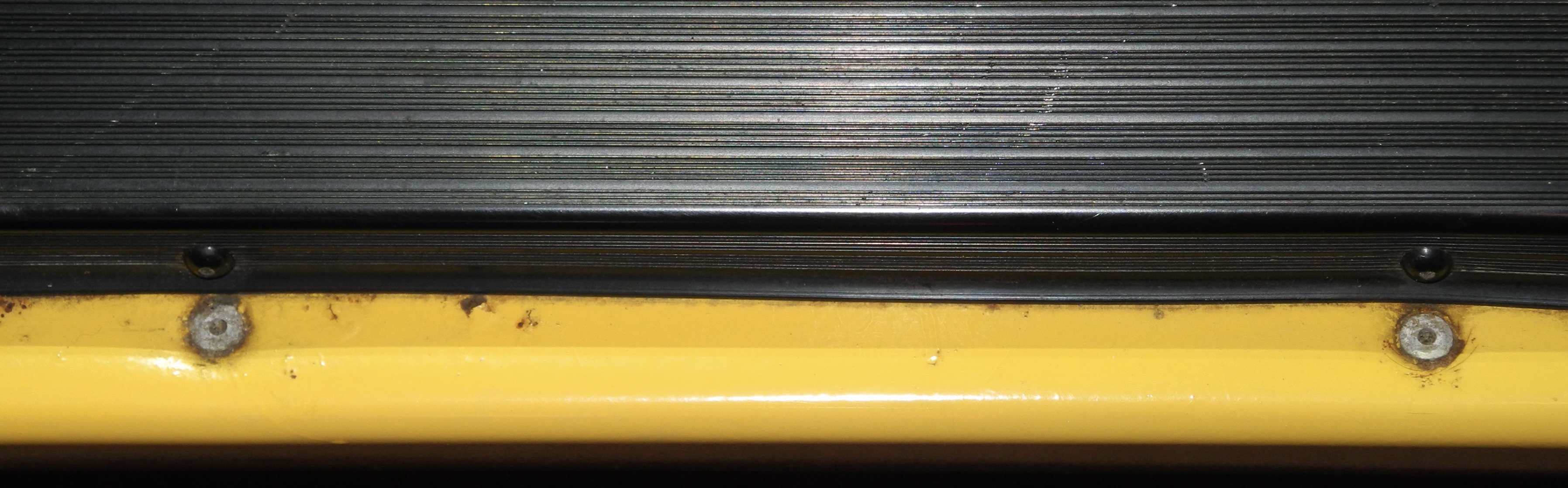

Ok Rich, tell me what you know. What I know is that the photo below shows aluminum rivets (with a peculiar head shape not available in todays marketplace from any place that I have found anyway) in the 'rocker panels' and black plastic riviets in the threshold plate as correct for a 1974 car. i *think* the clear plastic rivets are for 1973 and earlier cars.
Car acquired with ~40Kmi from the orig owner who told me the rocker panels had never been removed. VIN 4742914536

Mine look just like Jeff's:

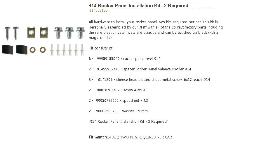

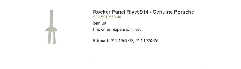

The OE fastener is the Plastic rivet also used on the threshold.
I looked for an isolated image I may have taken of my car but didnt find one.
Id take one post it, but car is remote.
Perhaps this will help -

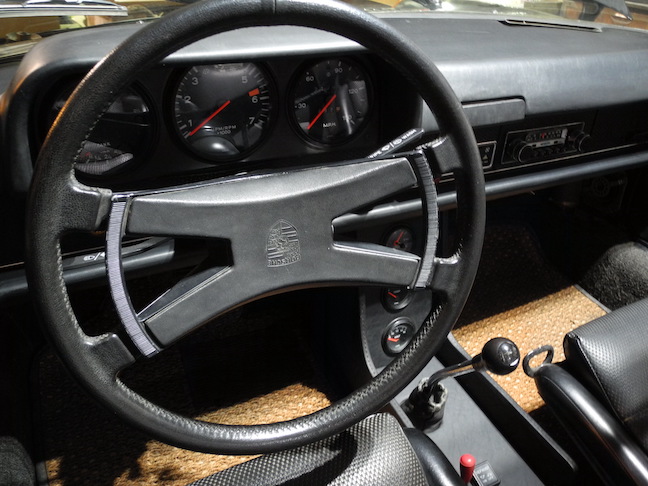

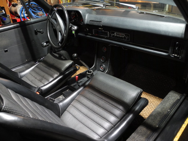

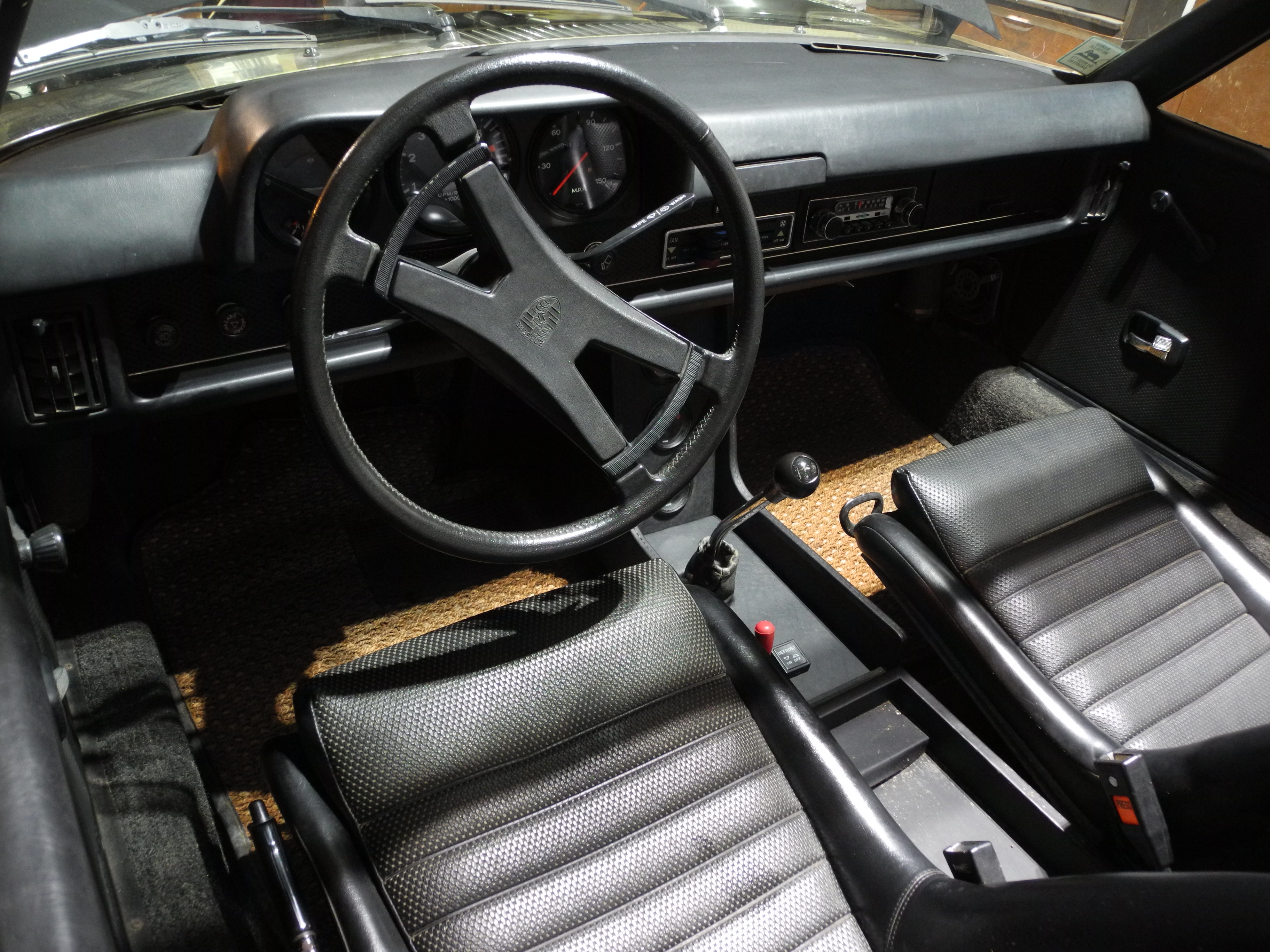

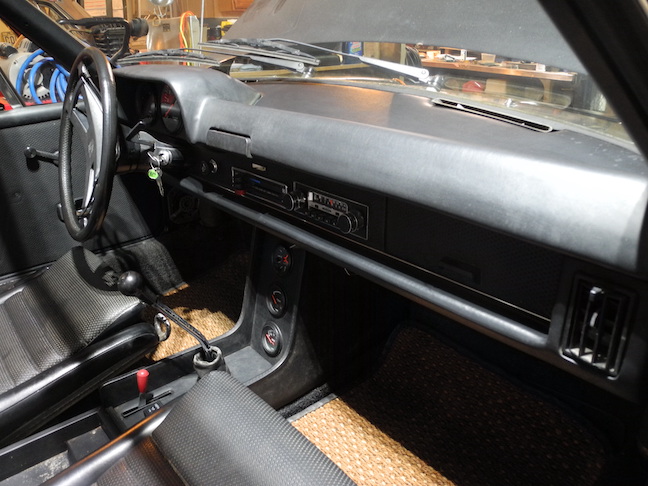

So, giving the interior a first cleaning to see what I'm working with, and confirming Dan's opinion that there wasn't a split, crack or tear in the cabin.
Here's the condition prior to any cleaning. Lots of detailing ahead.

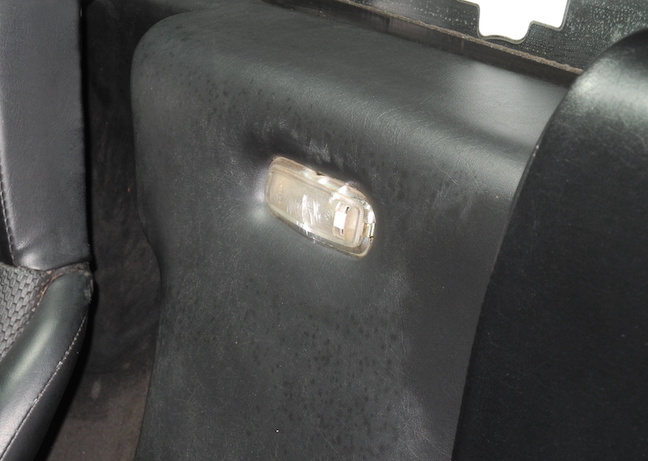

The only cracks I found were more like scratches in the backpad light.

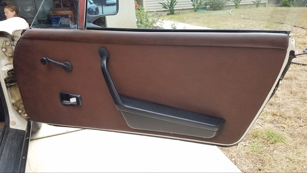

@KELTY360 - that interior is minty. steering wheel factory fresh!!!! beerchug.gif
i've got exact same cocoa mats in mine (but a little more worn biggrin.gif )
that particular "natural" brown color = the fashion item back then?
also remember my interior light when i got it back in 89 had the same melt droop in the middle top. someone had fitted the wrong bulb. too hot. biggrin.gif pretty funny.

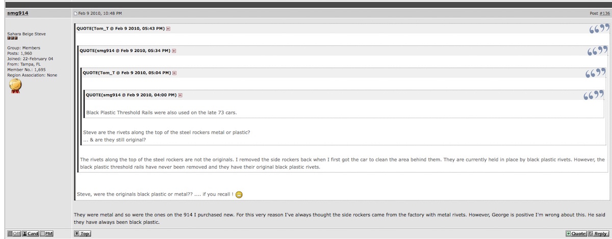

i thought to myself i know there is an in depth photographic record of S G's sahara beige 74 2.0 in originality section. went snooping to see if there were photos of sill.
uncovered a very interesting exchange.
http://www.914world.com/bbs2/index.php?sho...1921&st=120
seems to be a bit of uncertainty around the business of what was on a 74.
and maybe 73? leaving aside what was on an early car.
the black plastic rivets that S G quotes dr914 says were on all 14s def agrees with my files on 75 1.8s. they sure look like they got black rivets.
S G's comments about what were on his super clean super original car when he bought it, before he changed them to black, def agrees with my files on 74 1.8s and the 74 cars being discussed here a page earlier.
