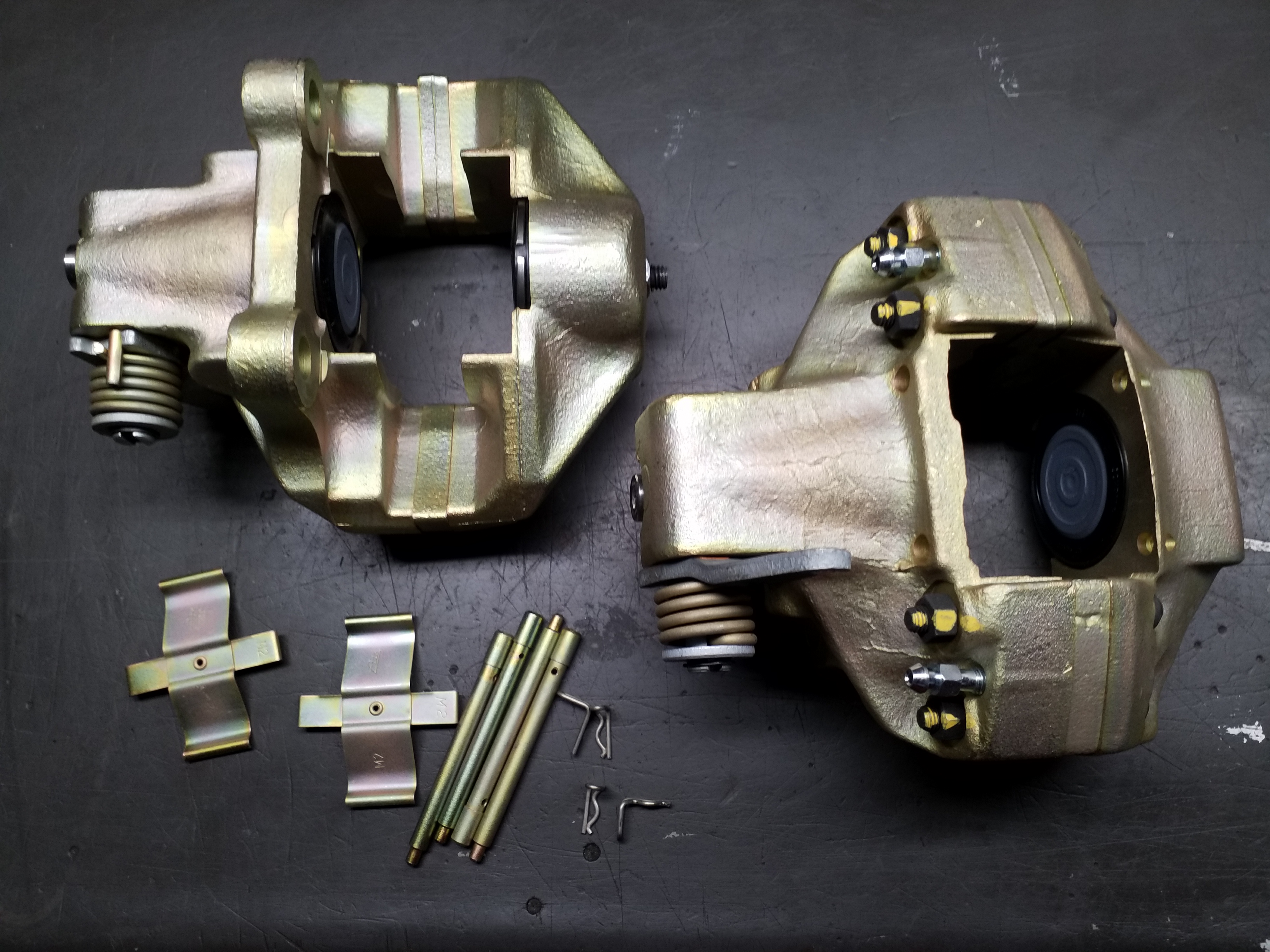

emerygt350
Eric, I was digging around on YouTube hoping for an install tips video. Is there one? Just curious about stuff like greasing the bleeders (I hate doing that but...), What are the two bleeder screws about? Since the caliper is drained does that change anything in the process? Venting strategies etc.
Just picked up the calipers from the post office. They look awesome, thanks for providing this service. Sadly just in time for a snow storm. Sigh.
