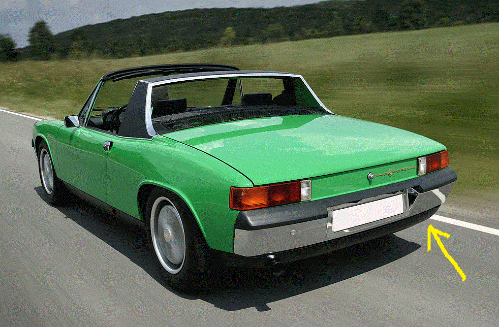

If you can accept fiberglass, this is an option. I bought one a few years ago and will eventually install it on my car when done... rolleyes.gif There are no holes, you make your own. smash.gif
https://americaninternationalracing.com/pro...e-rear-valance/
Picture from their website:

I have a short valance. I want the tall valance. Hard to tell if the AIR valance pictured is short or tall.
Can anyone address the question of the inward angle/arc comparison between the short or tall valances?

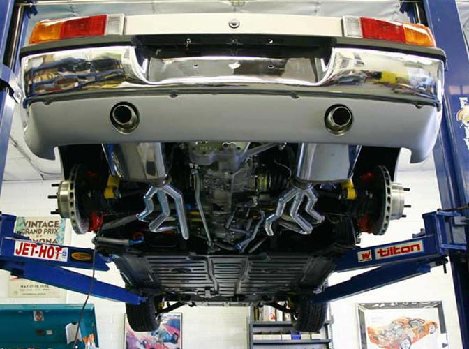

Assuming you have a narrow body car--there's a Patrick Motorsports deep rear valence with no cut outs. Could be the same as the AIR version, I don't know.
https://patrickmotorsports.com/products/bod...0c619&_ss=r
I have the wide body version, here it is when still in primer--Should be able to make it work with whatever you have going on beerchug.gif :

Thanks for the heads up. That looks great! Would you be able to take side pictures level with the valance so I could gauge the angle/arc of the rear of the valance? Thanks in advance!

The one I got from AIR was the deep one and had no holes. Agreed the image is unclear but if you look at the right corner, you can see it is definitely taller than the short one. smile.gif
