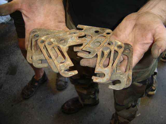

Bent trailing arm or, ... worse ...

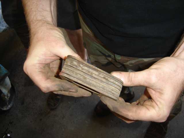

This is what came out of my car.
IPB Image IPB Image
GaroldShaffer
QUOTE(SirAndy @ Aug 29 2023, 09:40 PM) *
IPB Image IPB Image
YIKES!! This car is just a really rusty POS that someone patched together to keep it on the road.

Mine was an incorrectly mounted replacement suspension console.

So many it looks like a deck of cards. Was that a Cali car???

You don't get that much variance in a straight tub ...
After pulling the tub back to factory specs, i've been running 1 shim on each side, giving me about -1 degree of rear camber.
Without any shims, it's around -2 degrees.

My opinion- Because the passenger side suspension consoles gets damaged and weakened from water and battery acid washing over them. The quick fix is shims but they continue to fail until replaced.
