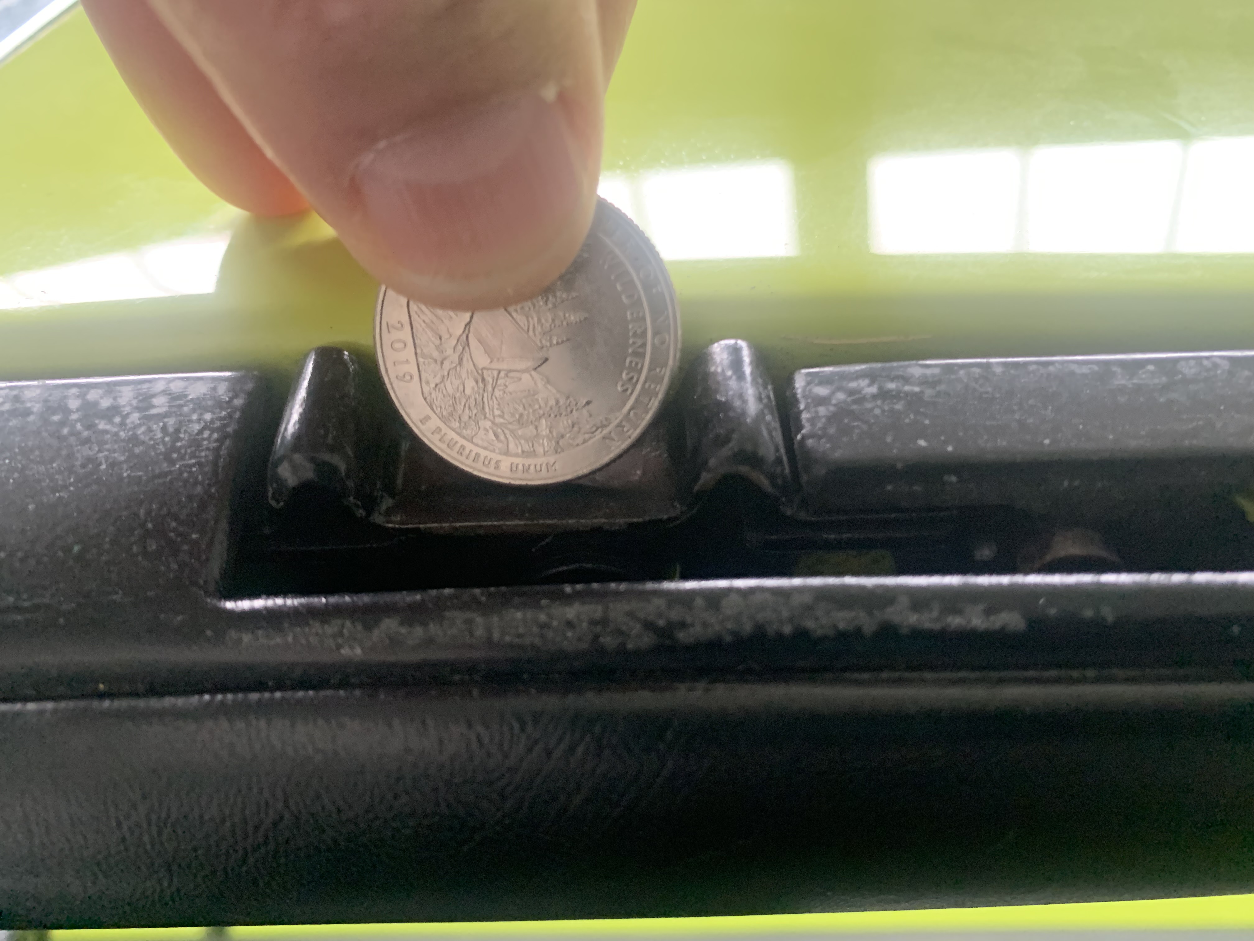

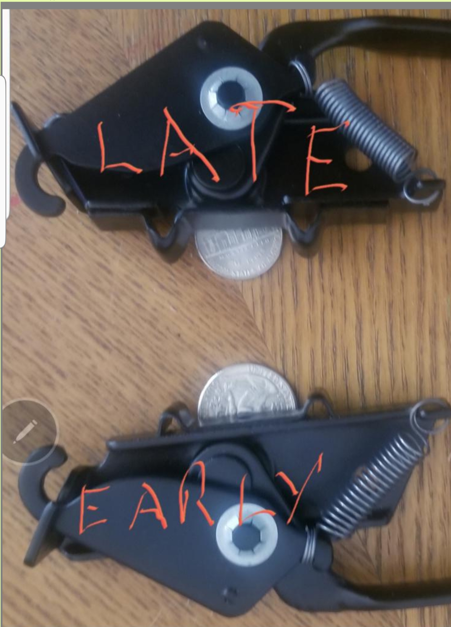

It looks like I have early latches since a quarter will fit between the bumps.

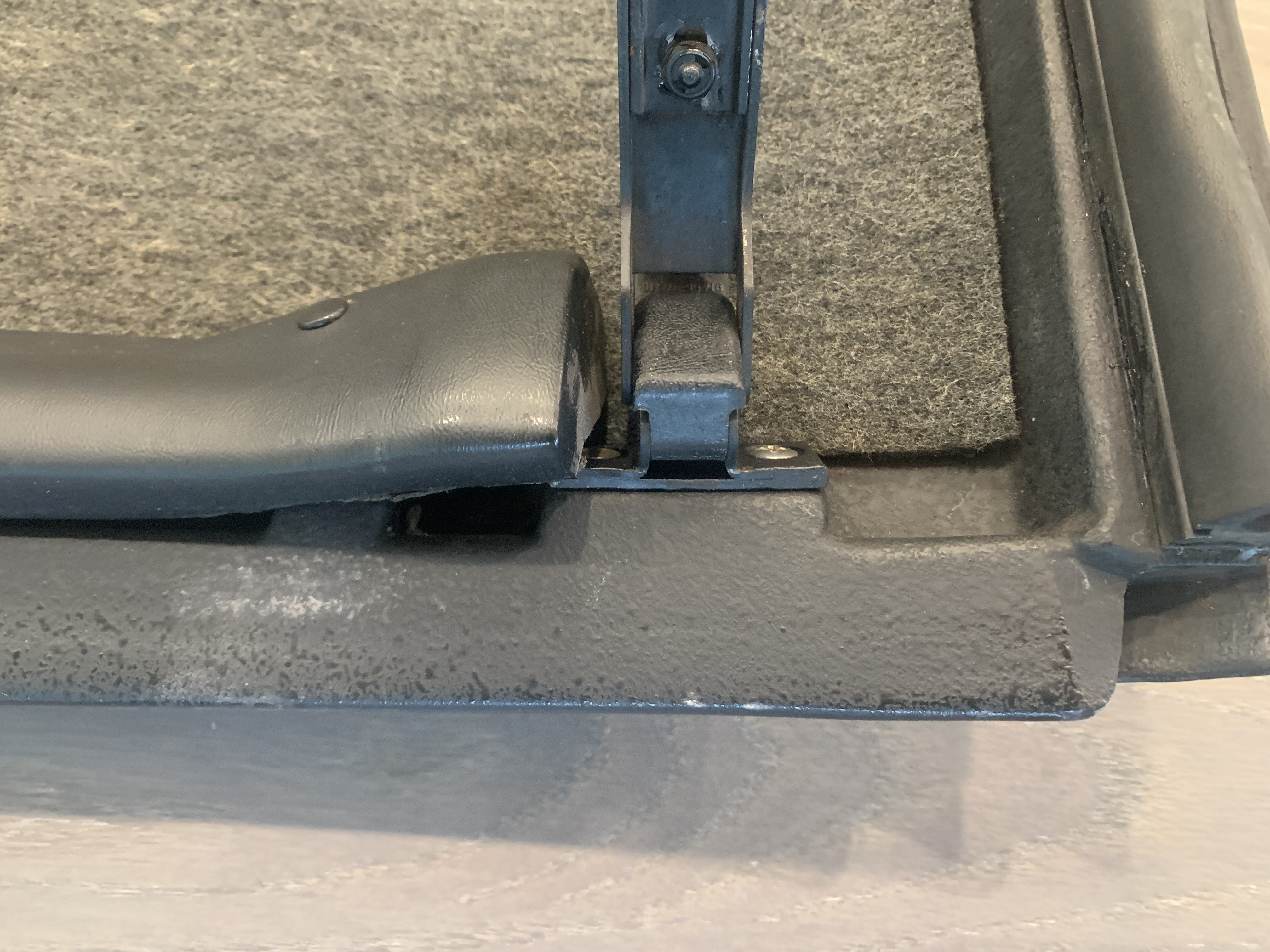

Latches:Click to view attachment

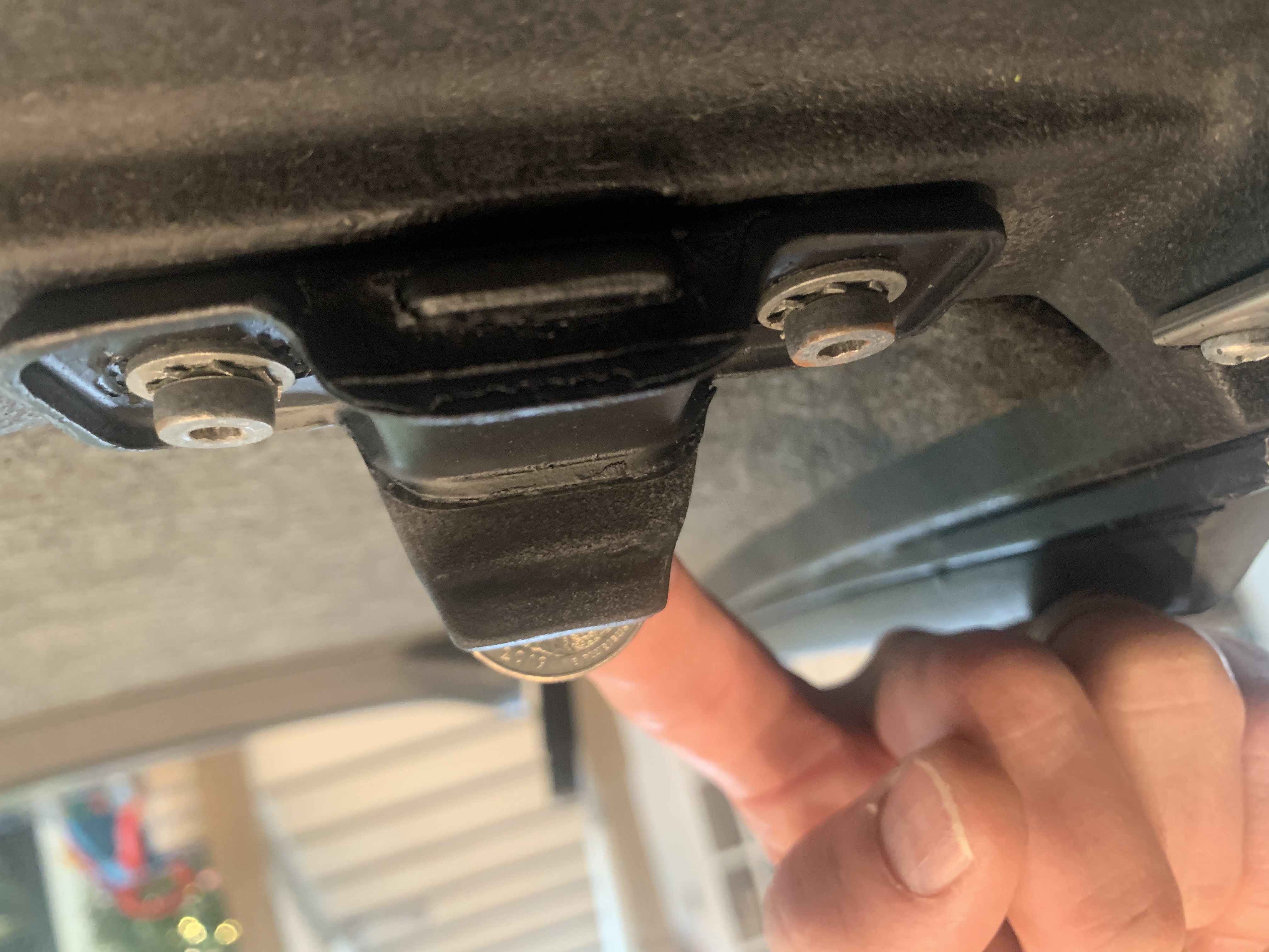

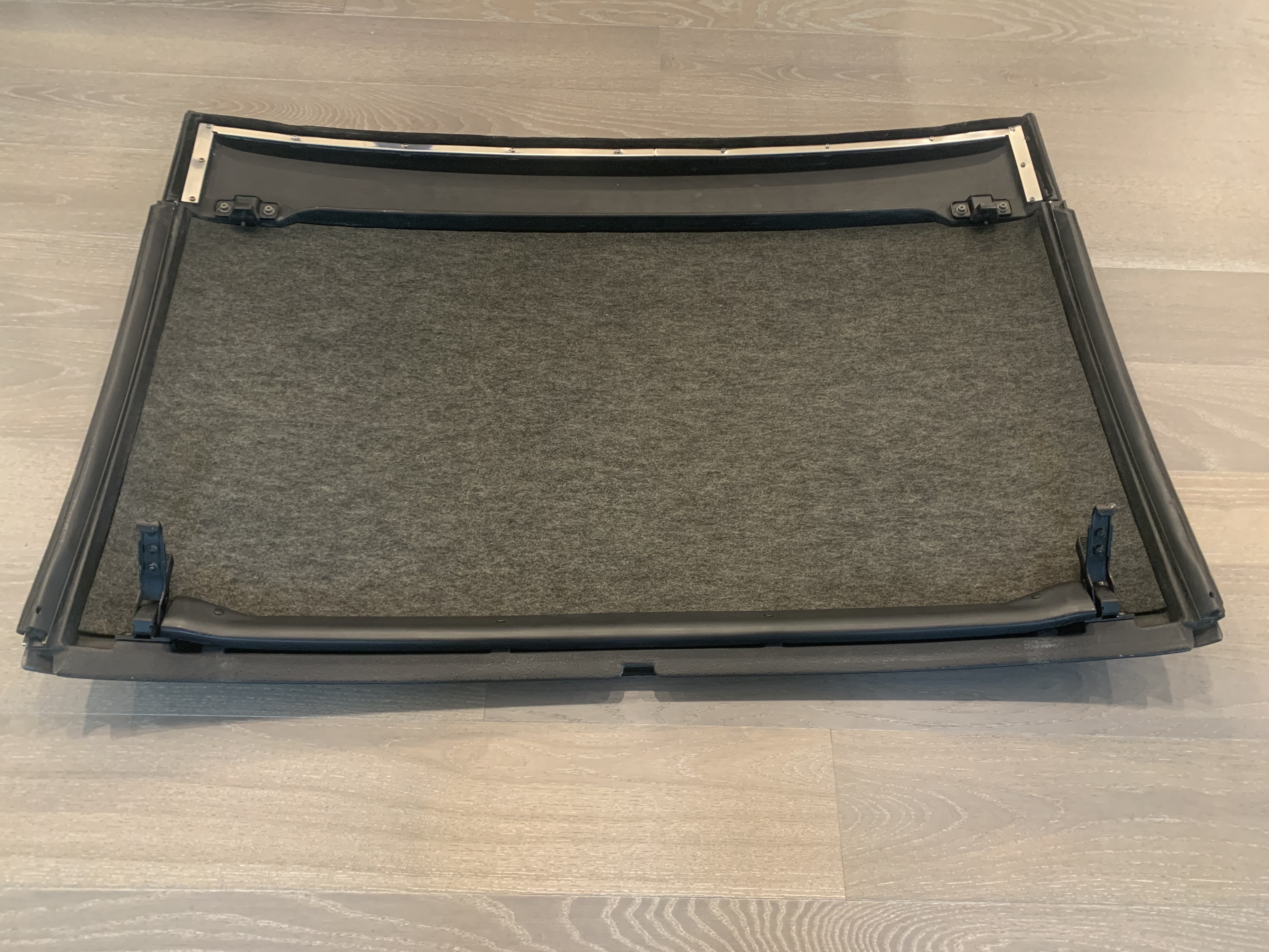

Top:Click to view attachment

I’m no expert so take this for what it’s worth, but to me it looks like your receiving piece is early and your rubber block is late confused24.gif . I’d think late ‘72 would be the all late roof related components( I have two ‘72s one early and one late, and the roofs correspond as such). If you have late scissor lifts inside the doors for the windows, you should have late roof and roof accessories. That’s my understanding.

It is hard to tell from the way you hold the quarter.
If the latch is late the quarter should fill the gap between the bumps.
Late a quarter or nickle flat on the rubber block to see if it is early or lare.
It is common for wrong tops to get swapped.
If the top and latches are mismatched I would match the replacement latch to the top. How do the seals on the top mate to the top of the window?Click to view attachment

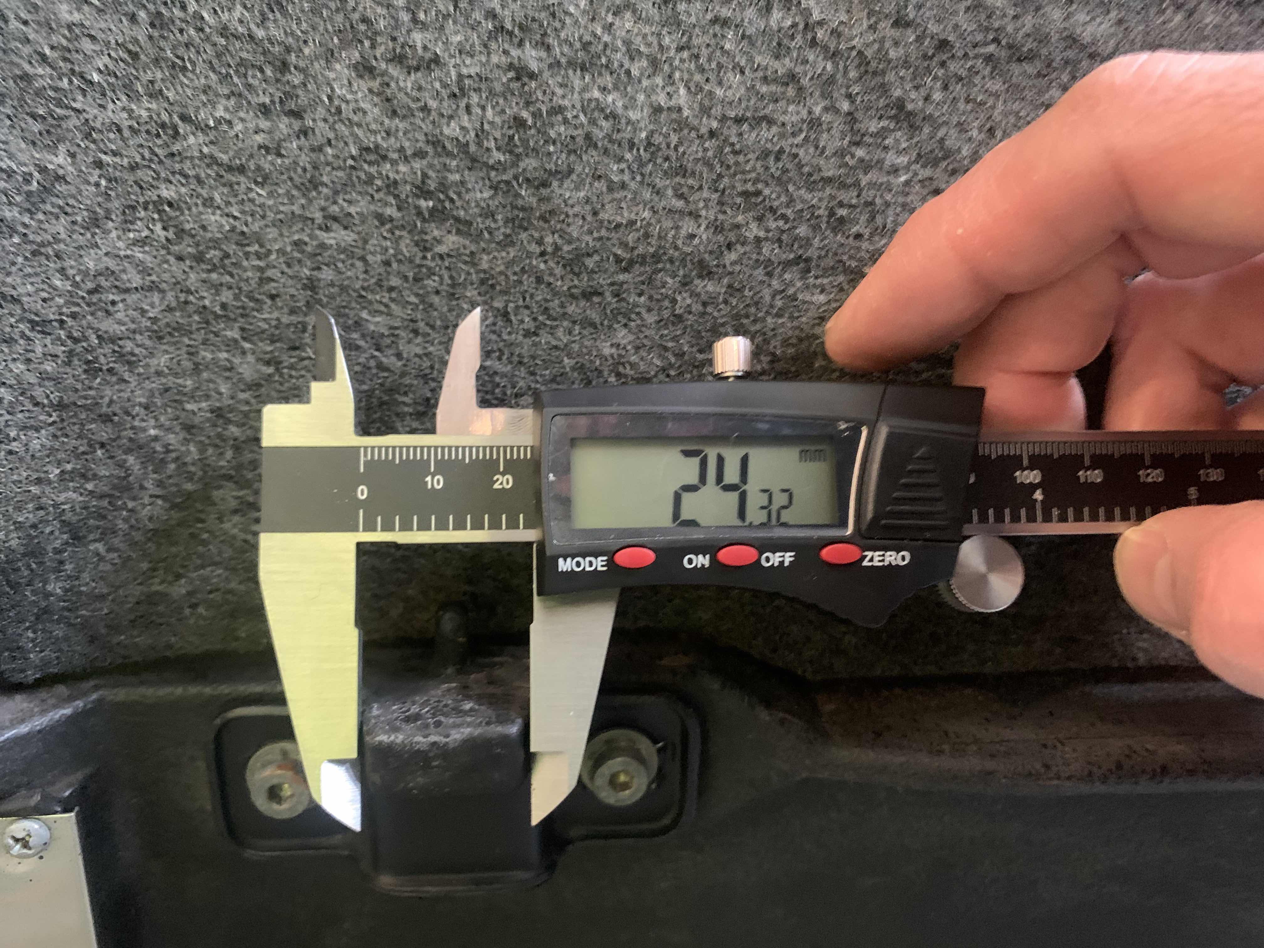

Bruce, I don't have the latches out so this is the best pic I can do with the latches still on the car. As you can see the quarter does not quite touch the bumps. Thus, these are early latches, correct?
DC_neun_vierzehn

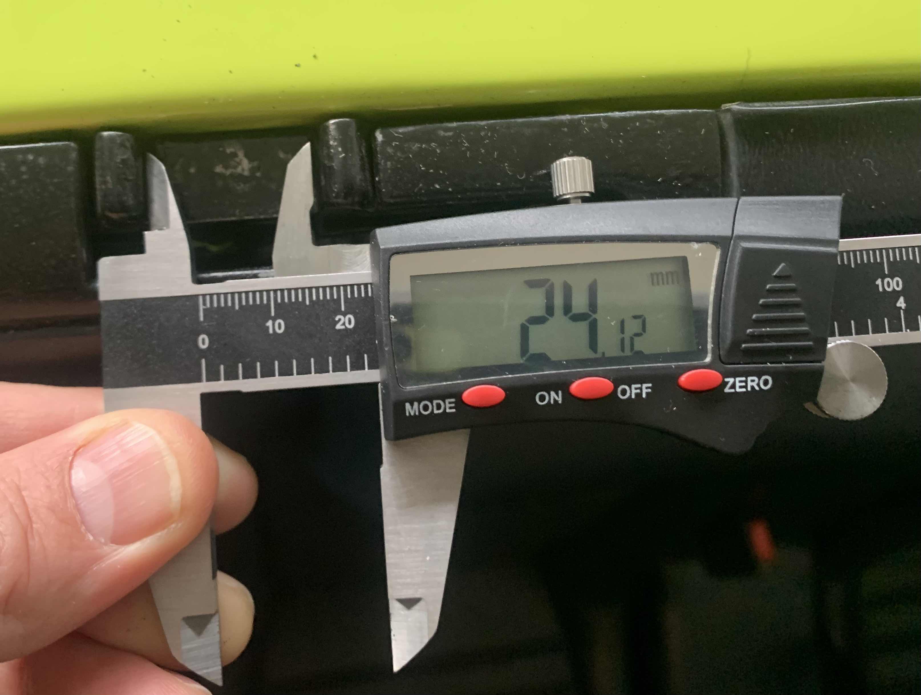

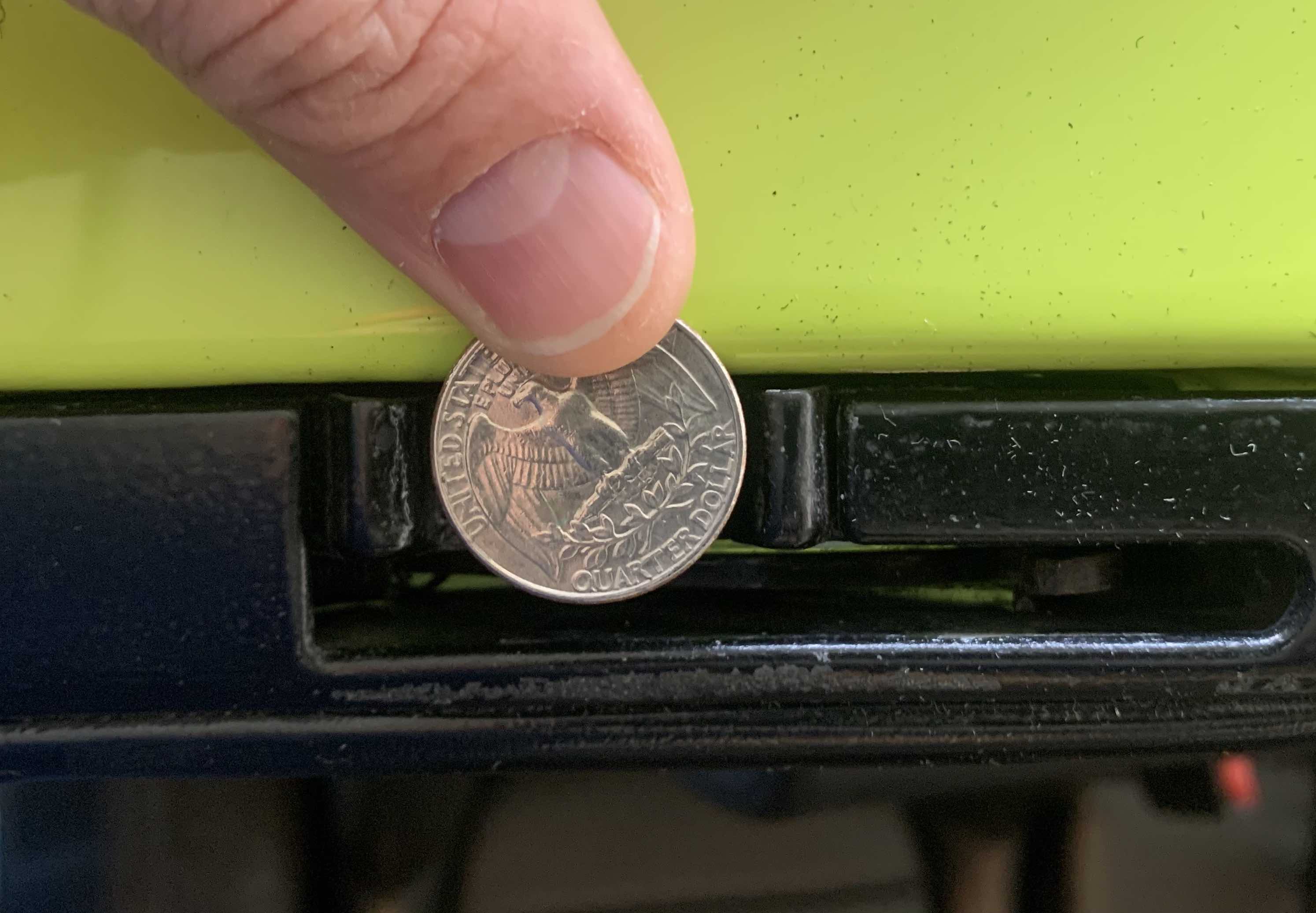

I thought I'd provide more accurate measurement images. To me it looks like the width of the rubber stops matches the latches, but maybe the rubber stops should be smaller?
This top has "worked" for as long as I've owned the car (approx. 3 years). Again, this is the only 914 I've ever owned so I have no point of reference on fitment. The latches work on this roof and with these rubber stoppers.
I think it's clear that I have a late roof and windows, but I believe I have early latches. Rubber stops ... not sure.
Looking for advice on what to do, if anything.
