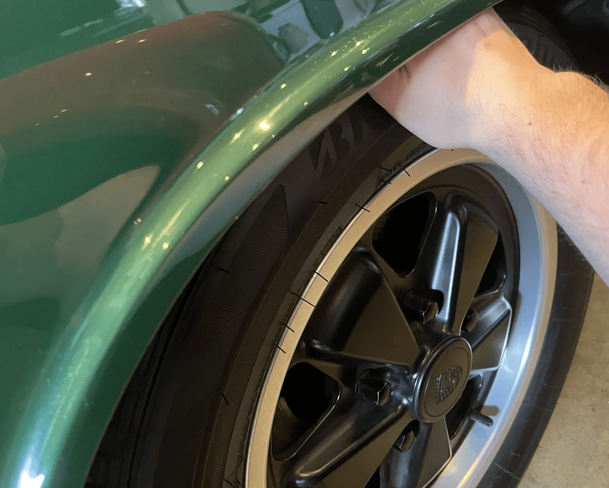

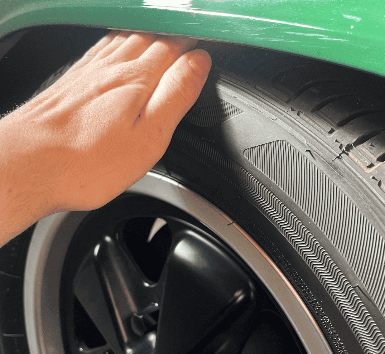

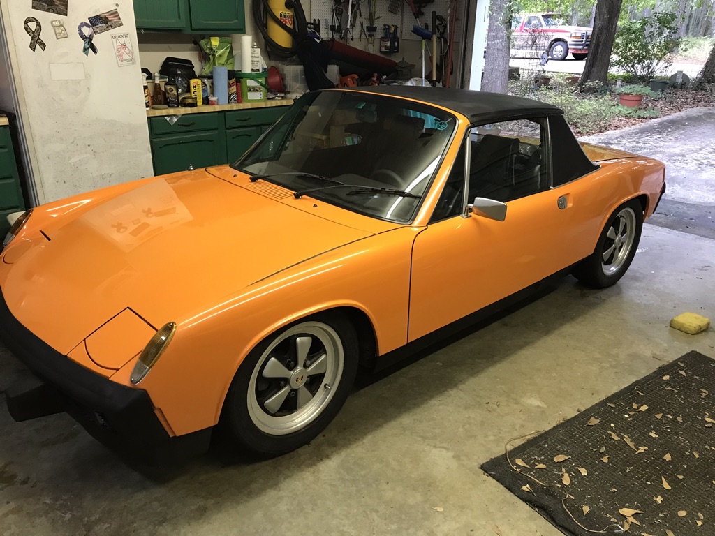

I run these wheels (Fuchsfelge Forged 'Continuation' Wheels) and almost that same tire - 205/60/R15s
Photos of the rear fitment. Rear, after rolling slightly I can just barely fit my fingers.
For the front I can comfortably fit my whole hand and see NO rubbing.
Here is a shot of the setup 'in the wild'
I think the fitment is pretty good.

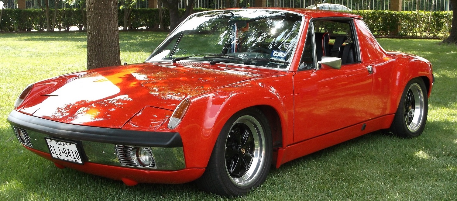

These are 8' on the front with 225-50's and 10's on the rear with 245-45's. They are replica's that someone was running on their 911 turbo. Click to view attachment

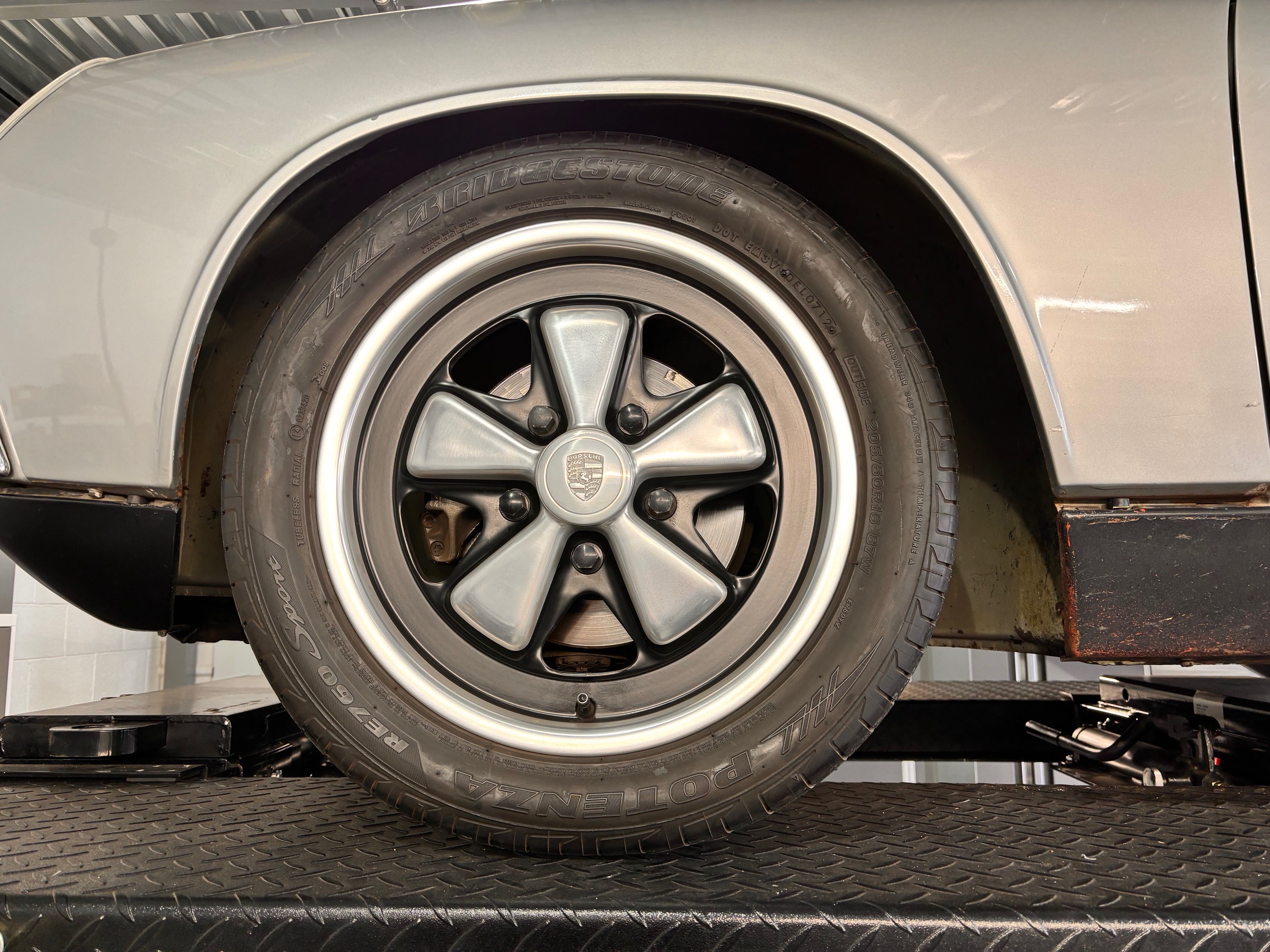

Fuchsfelge USA 16x6 wheels with 205/55R16 tires on my old '73 that was lowered quite a bit. Long before I went 5 lug the rear fenders were rolled, so I can't really speak to rear clearance. Front was fine except at full lock & low speed it would rub the inside sidewall on the driver's wheel, and the change in scrub radius made them skip a little at low speed as well.

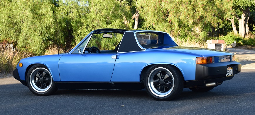

6x16's all four corners with stock size 205/55/16's. No rubbing, no modifications.

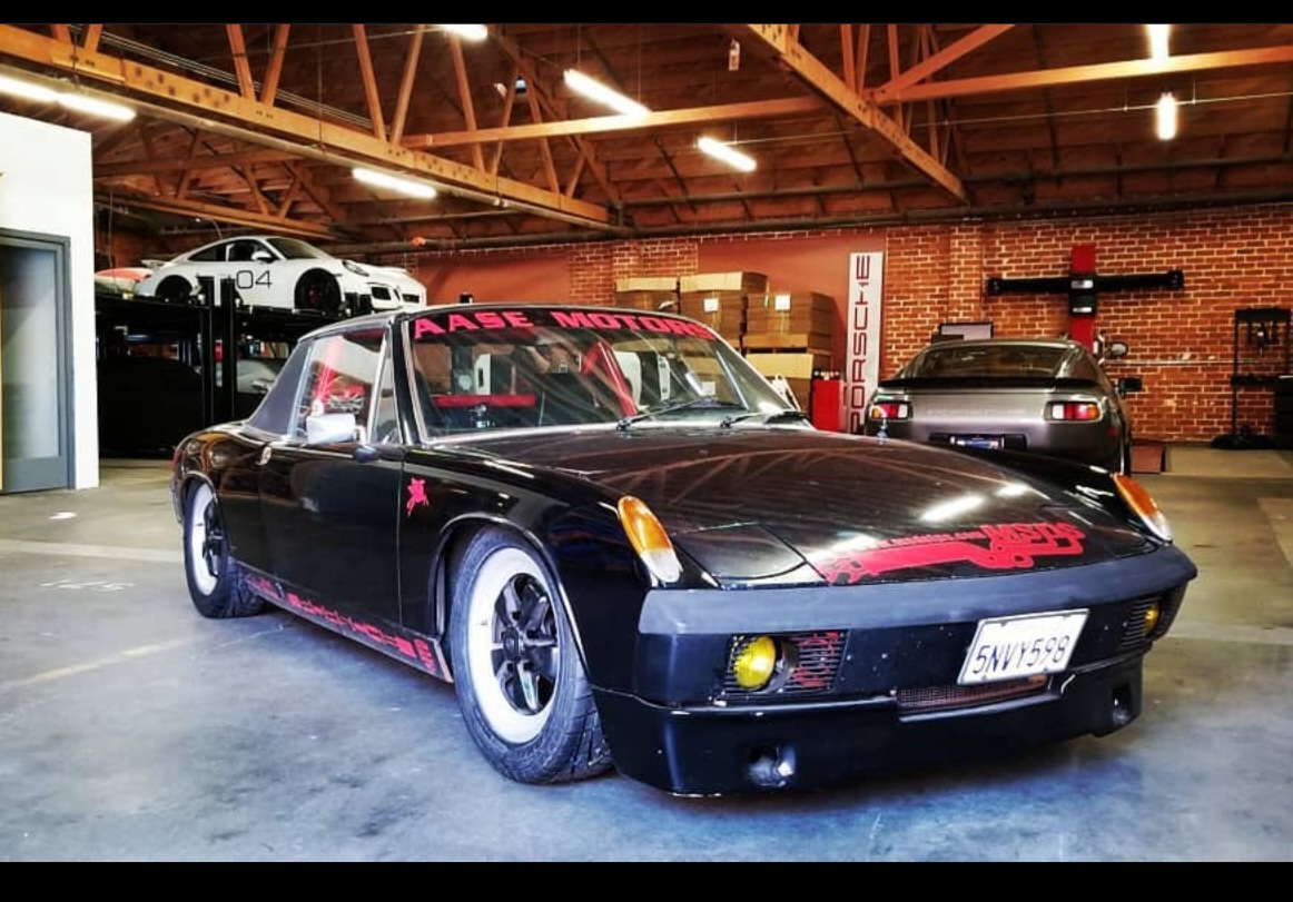

16x6" all around on this 2L

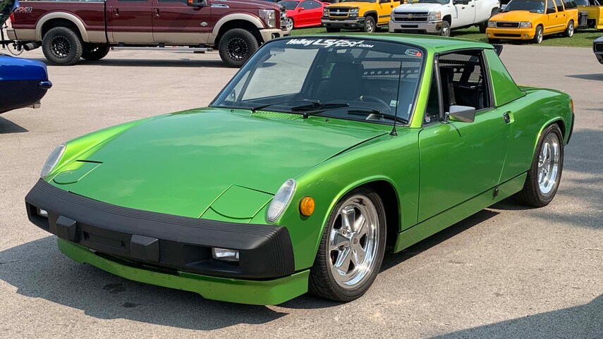

Pic of Tim’s green 914 with 16s and my copper 914 with 15 before I switched to 16s

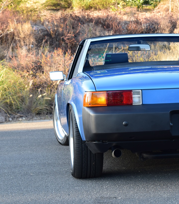

dwillouby
16x6 & 16x7
DavidClick to view attachment
If you go to 7’s, it usually requires such a skinny tire ( less than 205) that it doesn’t seem worth it. Rolling a fender lip usually cracks the paint and at least in my mind, makes the fender look poor. A six inch wheel with a 205 tire fits without mods, 95% of the time and is still a lot of tire for a light, low, mid engined car. Too much tire can also feel a lightly powered car feel sluggish. None of this is an absolute but just things to think about if you think wider is better.

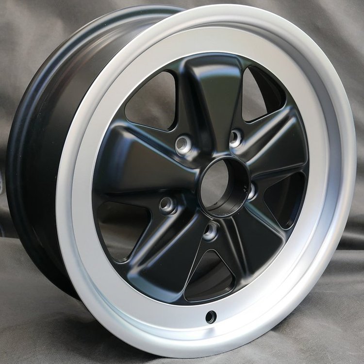

I can’t find a pic right now but I’ve seen 6x16” Fuchs painted to look like 15”. The black extends further up the face of the wheel. It’s what I would do with 16”. Otherwise, I don’t care for them over the look of 15” wheels.

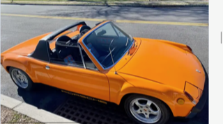

Olympic 914
7x16 w/ 205-50/16 Front + 12mm spacers
8x16 w/ 225-50/16 Rear
951 wheels 23 offset F+R
Tangerine flares.
(probably not what you are looking for)

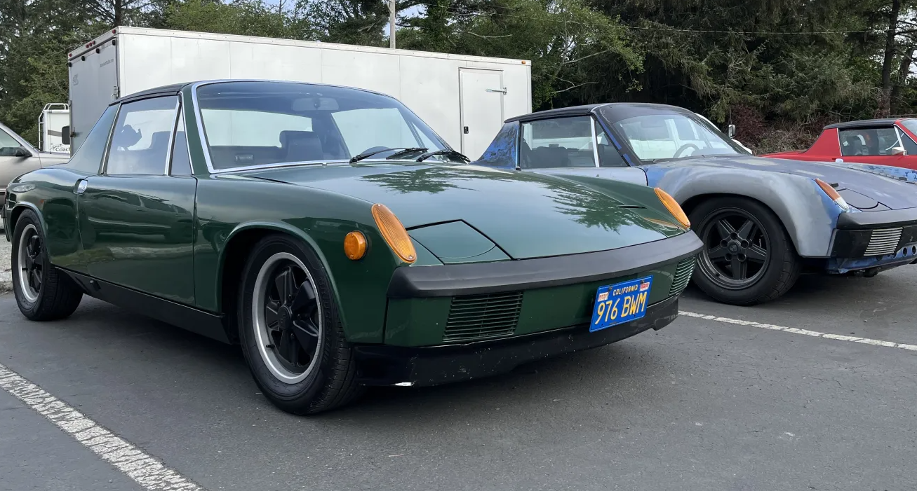

ConeDodger
Maury4
[quote name='ConeDodger' date='Jan 4 2024, 11:23 PM' post='3121881']
Maury4
[quote name='Maury4' date='Jan 5 2024, 10:36 AM' post='3121956']
[/quote]
16x6 with 195/55x16 tires.

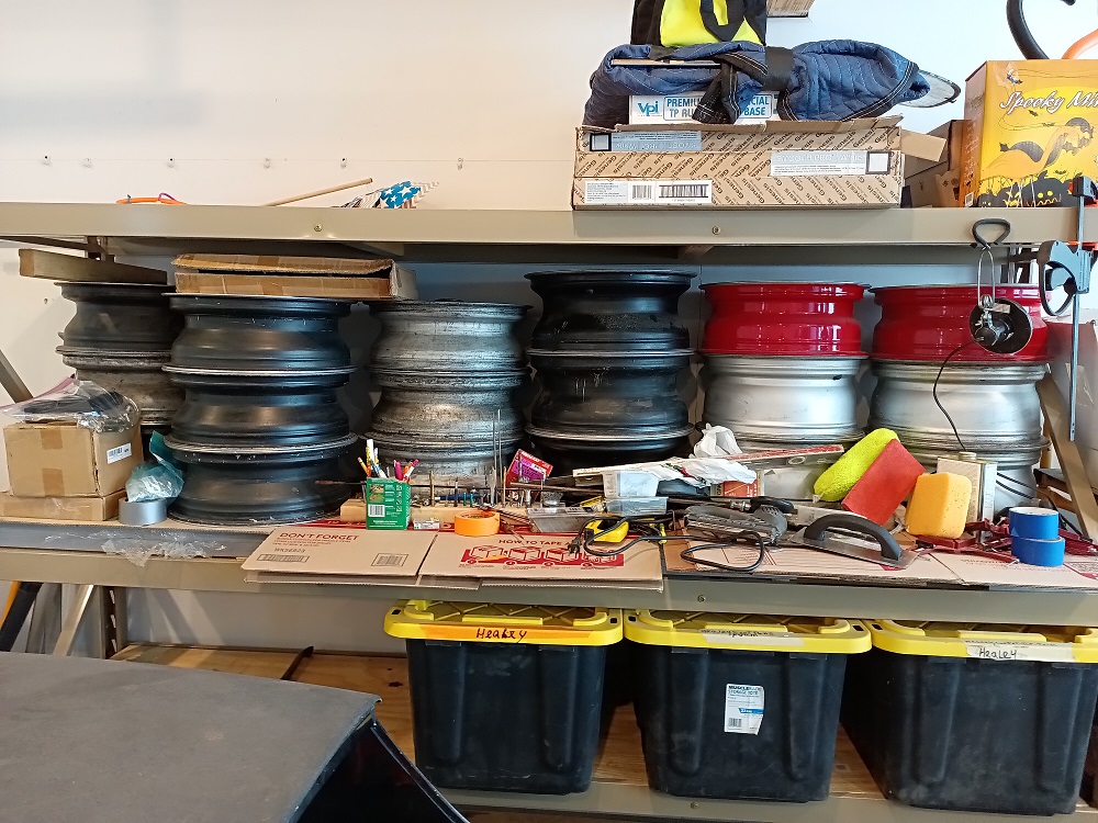

rick 918-S
On the car or off? I have a few sets of these to restore...
Root_Werks
Remember when you couldn't give a 6x16" Fuch away? Then people (like me) started gobbling them up to make modular Fuchs.

sportlicherFahrer
QUOTE(mepstein @ Jan 4 2024, 03:53 PM) *
Post #8 shows a set painted this way on my '73 biggrin.gif beerchug.gif I didn't care for the less-painted look with polished paddles on a 16x6 either. Luckily FFUSA offers them with that finish style.
