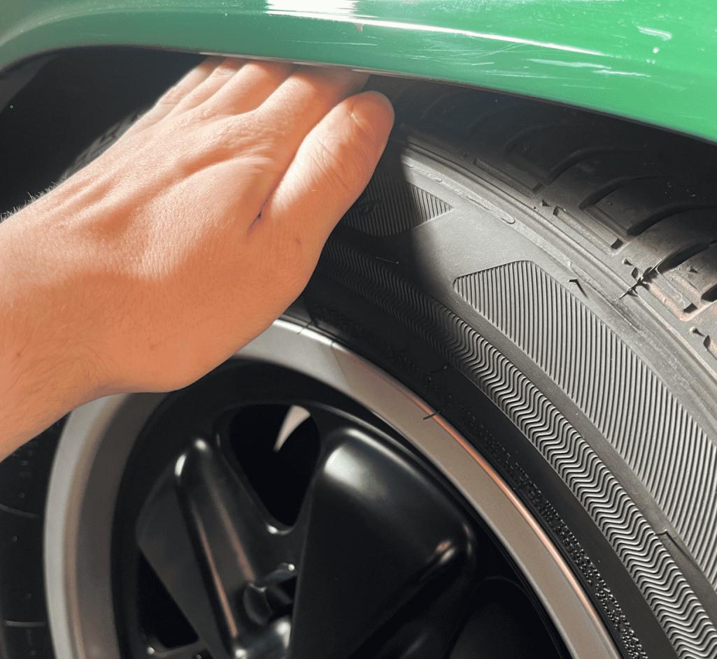

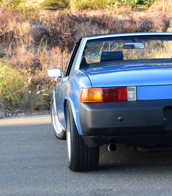

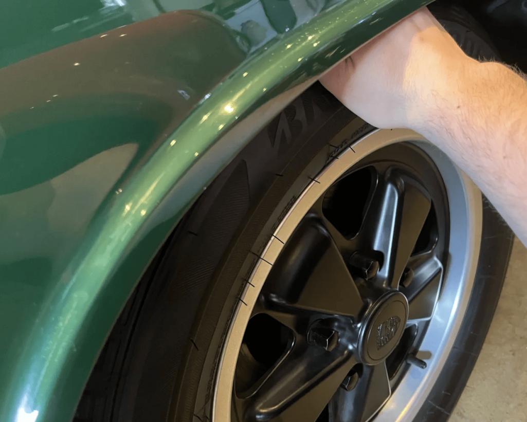

I run these wheels (Fuchsfelge Forged 'Continuation' Wheels) and almost that same tire - 205/60/R15s
Photos of the rear fitment. Rear, after rolling slightly I can just barely fit my fingers.
For the front I can comfortably fit my whole hand and see NO rubbing.
Here is a shot of the setup 'in the wild'
I think the fitment is pretty good.

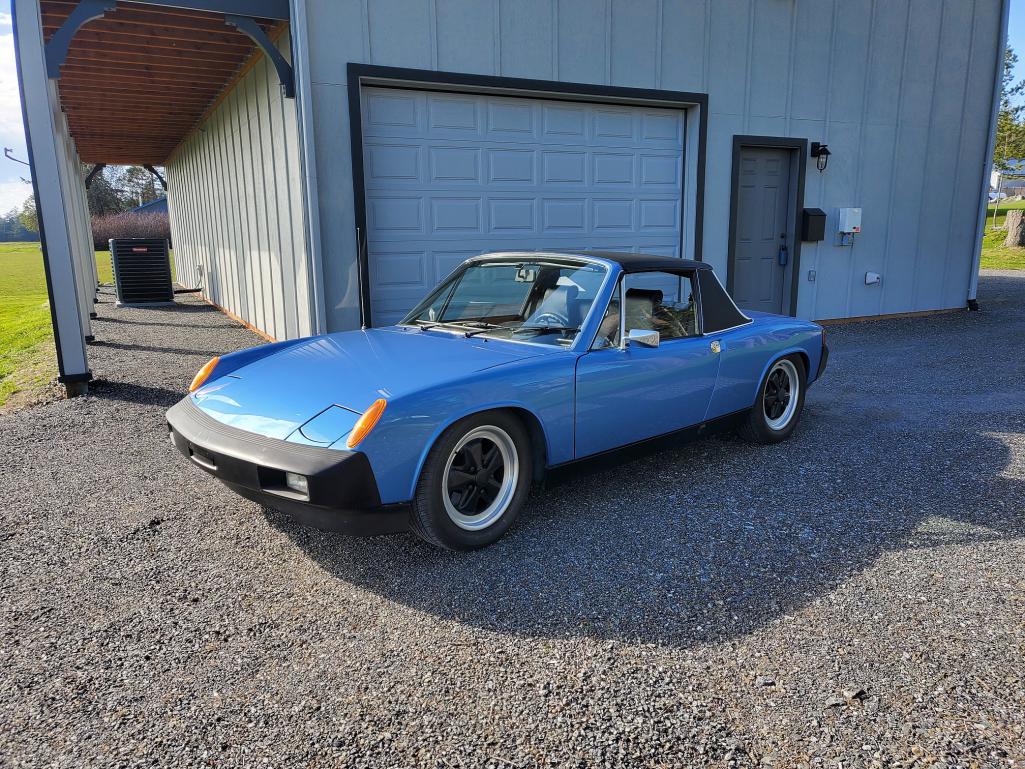

Fuchsfelge USA 16x6 wheels with 205/55R16 tires on my old '73 that was lowered quite a bit. Long before I went 5 lug the rear fenders were rolled, so I can't really speak to rear clearance. Front was fine except at full lock & low speed it would rub the inside sidewall on the driver's wheel, and the change in scrub radius made them skip a little at low speed as well.

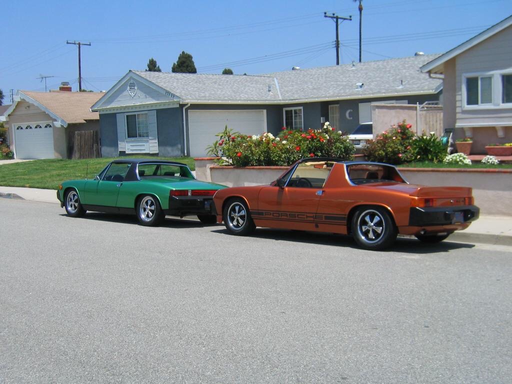

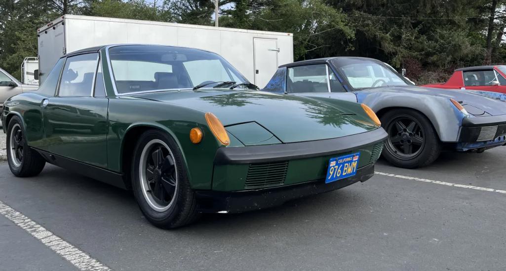

Pic of Tim’s green 914 with 16s and my copper 914 with 15 before I switched to 16s
