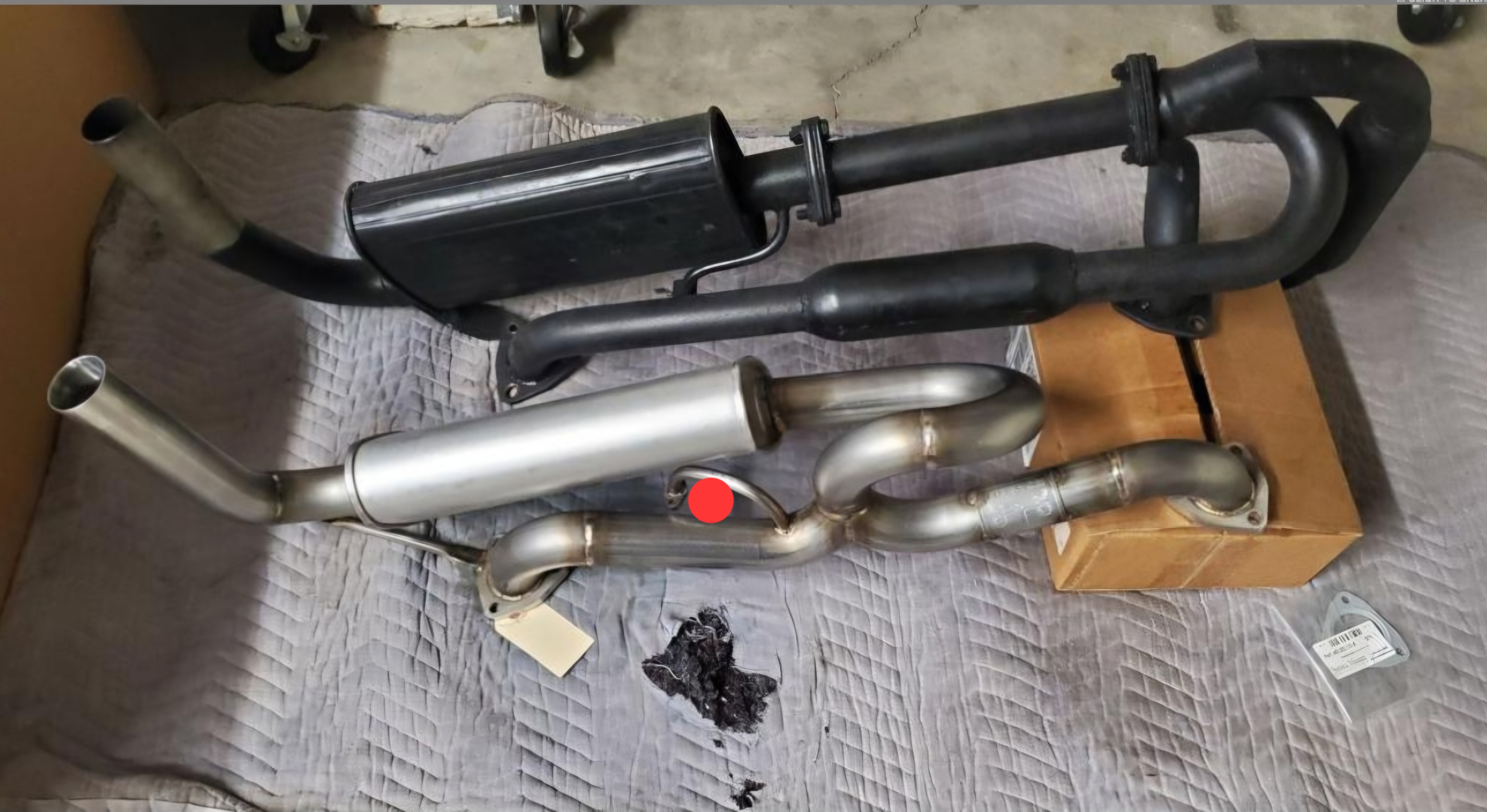

Bought my teener with three exhaust systems. Previous owner installed stainless heat exchangers (thank you) and installed a stock replacement muffler that is in poor condition.
Included in the sale is a single Bursh exhaust and quad Ansen style. Which one has a better exhaust note and the advantages of each. Help me decide. Thanks!Click to view attachment I

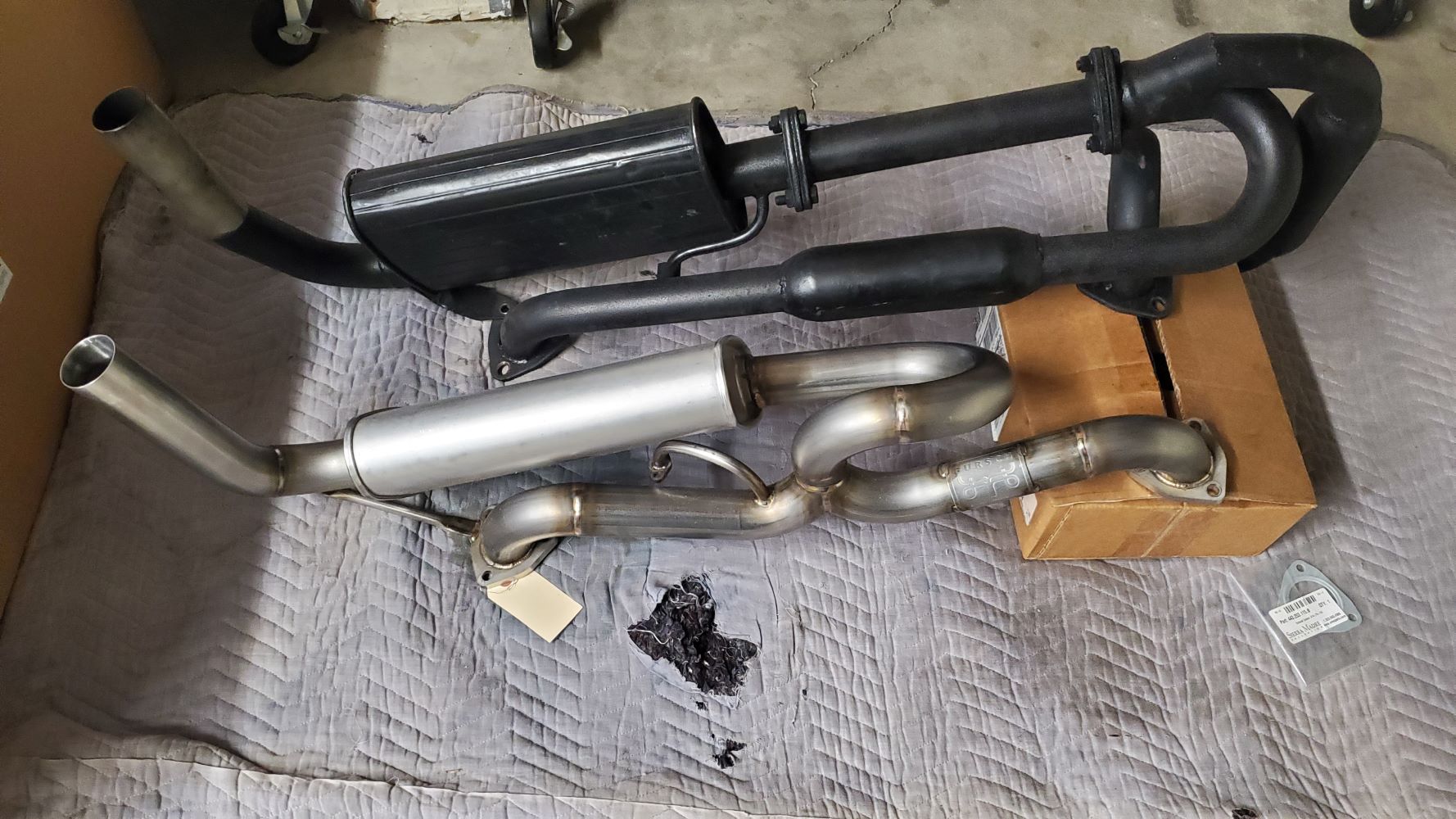

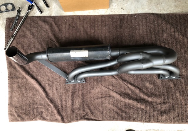

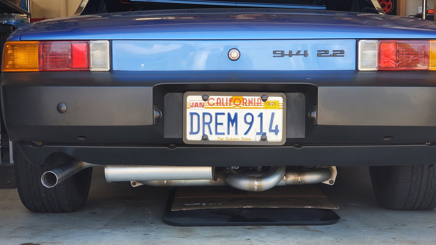

picture of what a new Bursch 75-76 stainless muffler look like.

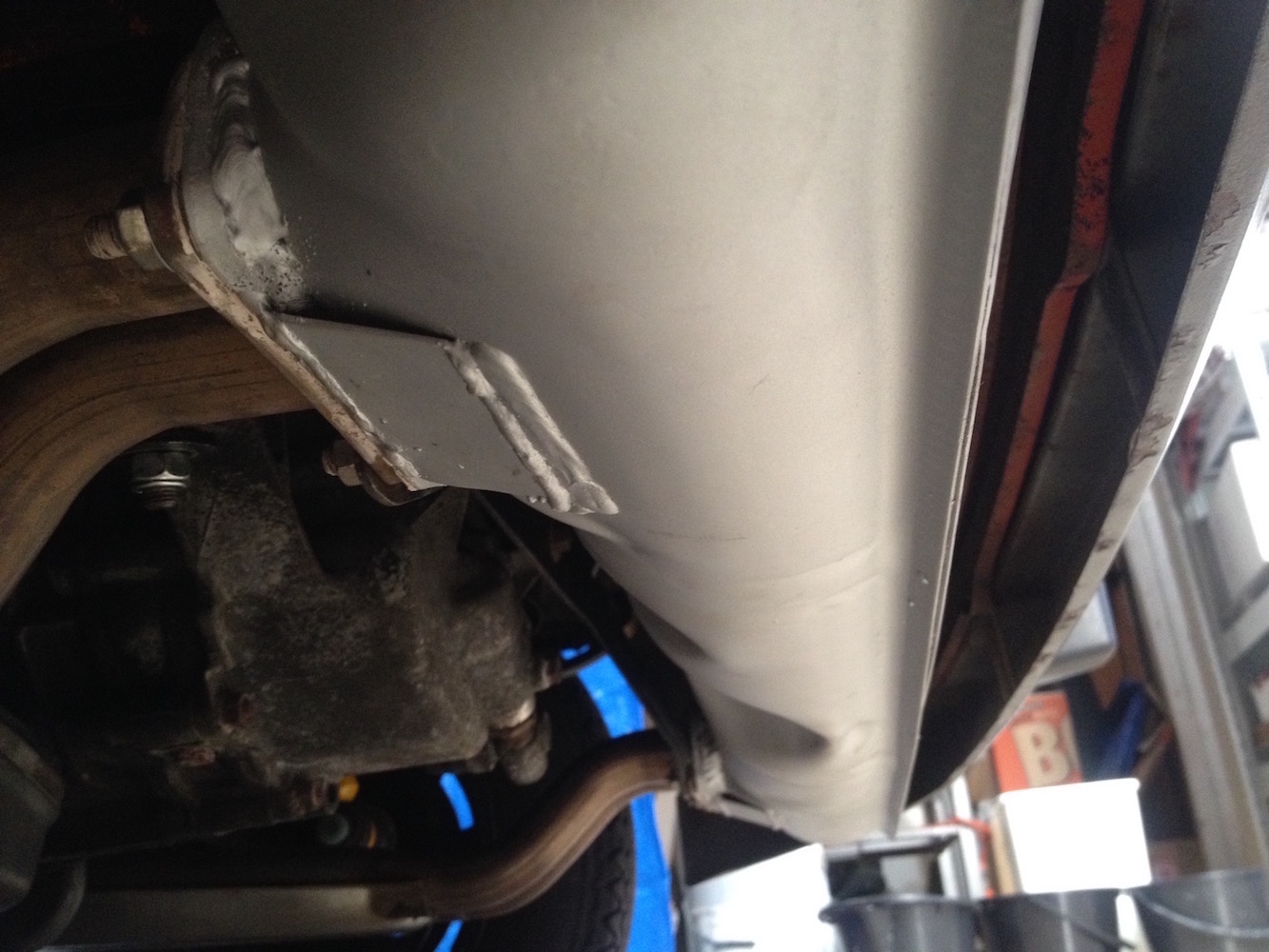

if you are handy with a welder i have a tip for you.
the stock muffler on a 1.8 is in fact a late bus muffler.
except for one thing.
the inlet flanges on the muffler are welded on upside down compared to a 914 muffler.
all the strange dents formed in the 914 muffler that are visible on the bottom face the other way up on the bus and allow the muffler to fit against the bottom of the fan casting and for the dipstick tube to pass above it. was also on the VW 412. right hand side tailpipe.
if you go to VW parts website you will find that dansk bus muffler is about half the $ of the same thing for a 914. blink.gif sad.gif smile.gif
you cut those inlet flanges off and weld them back on upside down.
i was real lucky about 25 years ago. i found a stainless bus muffler here in Aus.
not entirely certain whether it was an Aus parts manufacturer who made it or whether its german and originates from the 70s or 80s. but i did the mod on it and i've got an entire stainless system from heat exchangers through to muffler.
it will outlast me and the next owner.
only disadvantage. it sounds tinny and horrible until it warms up. its very funny how the tone changes for the exhaust note from stone cold start up to fully warmed. biggrin.gif
otherwise. go for that bursch single outlet system you got for free.
those four tip ansas are over the top and look plain silly.
wonkipop

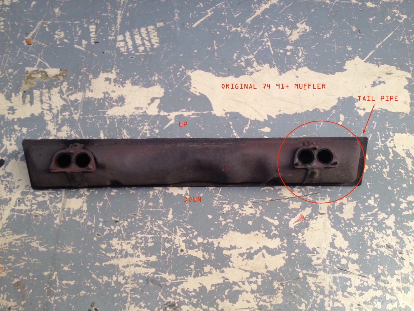

here is what i am talking about @Artfrombama
there is also all sorts of weird versions of this late muffler type.
like super quiet ones for 412s that were a bit more restricted internally etc.
but as far as i can determine, the 914 got the bus one. which was i believe less restricted internally.

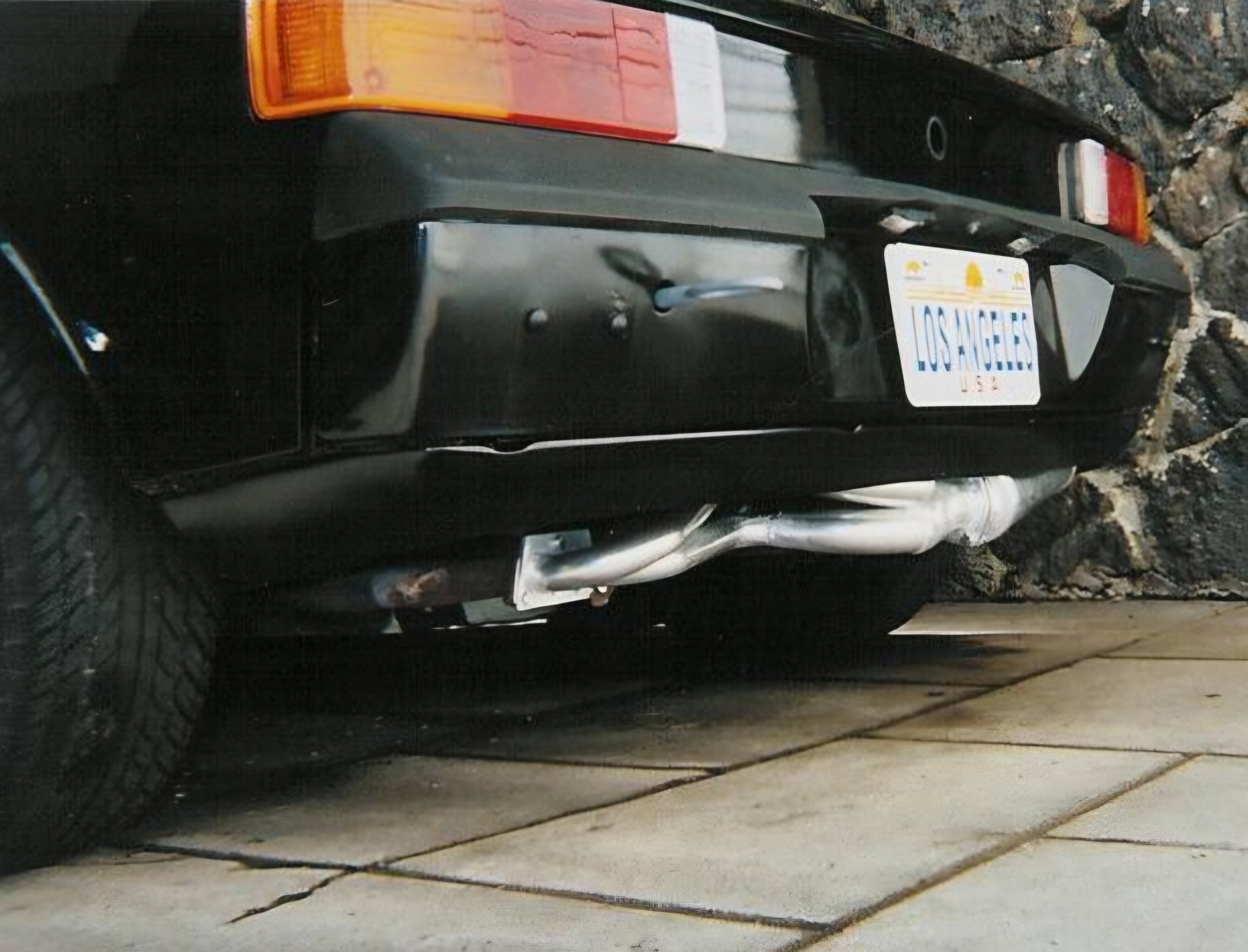

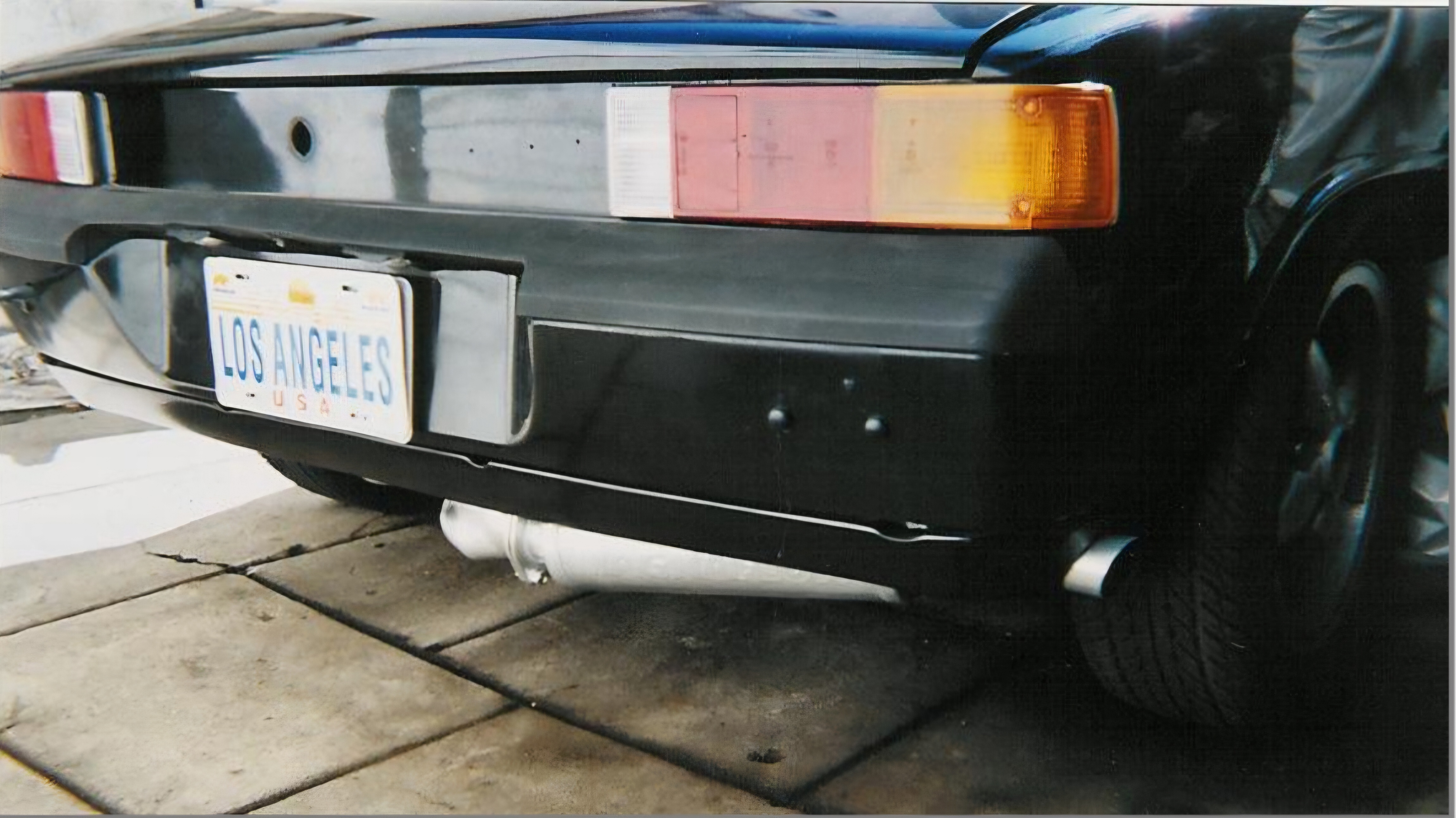

Have your muffler shop add a 2.5" (#f4) flange just after the 4x2x1 merge. Bolt on a 2.25" core magnaflow muffler; then blast and ceramic coat everything. You get a great working/sounding system, not heavy and run a custom (R exit) style valance/ or no valance
Maltese Falcon
If you are handy with a hole saw/ Dremel you can run a (fiberglass) valance creation like this...
windforfun
Nice impostor license plate. You're busted.

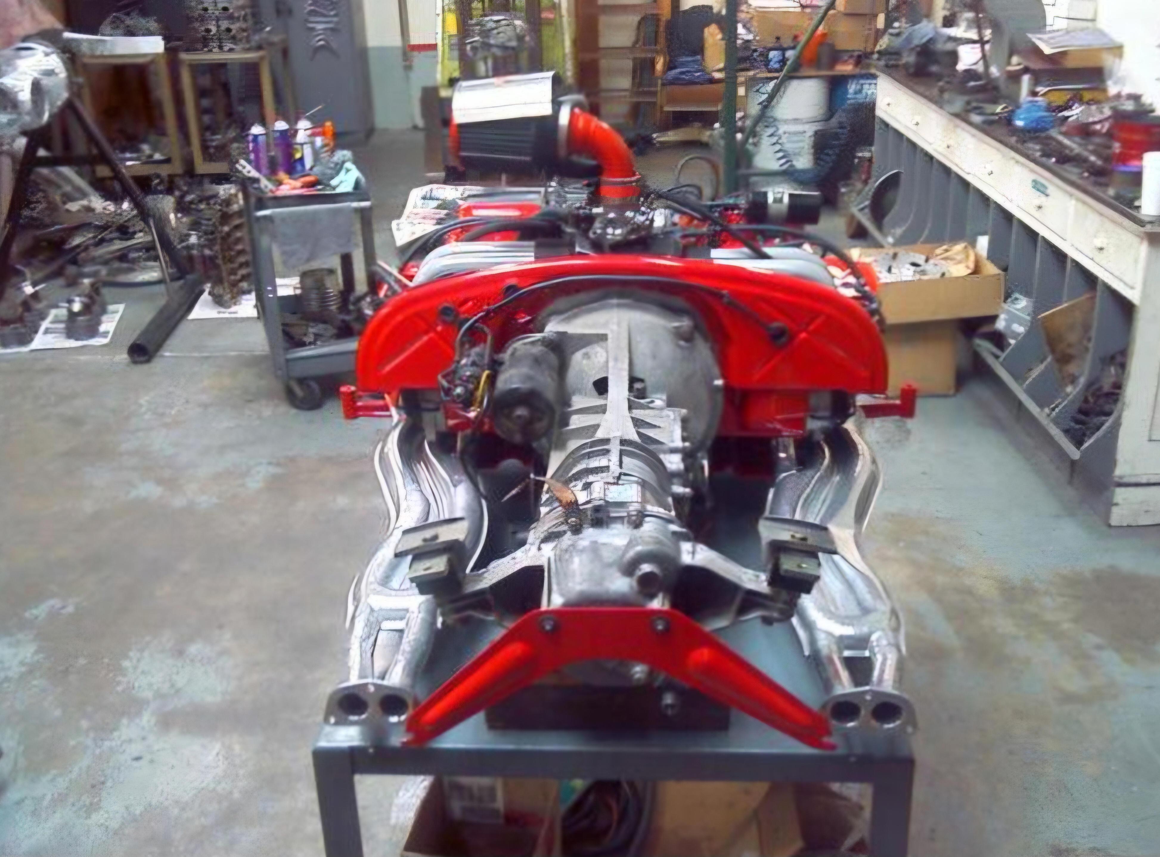

We also had the OE h/b's opened up (inside tube dia.) for more flow 'Extrude Hone process; then ceramic coated with the Bursch/ Magnaflow combo. Shut the engine off after 20 min POC session...it's cool to the touch in 15 min.

QUOTE(drem914 @ May 30 2024, 12:56 PM) *
Definitely the Bursch!
@drem914 The stainless Bursch looks great. How's it sound? Comparable to the old Bursch?

QUOTE(TX914 @ May 31 2024, 07:25 AM) *
@TX914 Marginally louder and a little deeper. The secondary resonators from original design are no longer there and the pipe lengths are shortened also.
