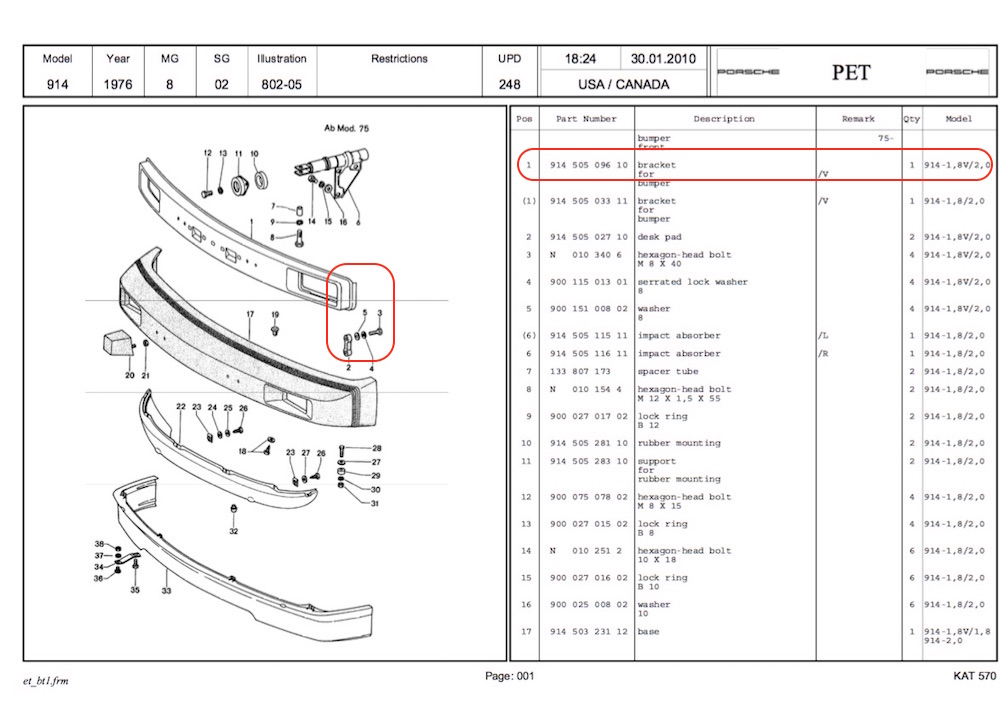

Check out the drawings for the Euro versions. They don’t have the heavy shocks. You could probably copy them or find a used euro one on ebay.
wonkipop
euro bumper internals for a 75.
in terms of understructure the weight saving is purely deletion of shocks.
steel sub frame is marginally heavier for euro - has additional brackets to take dog bone mountings identical to earlier 70-74 models.
not sure what USA bodies are like compared to euro in terms of the mounting holes for dogbones and apertures for shocks. never really looked at one.
a lot of additional weight must be in the outer flexible rubber (urethane?) moulding compared to the earlier cars? but never been up close and personal to a 75 to know. but i'm guessing that outer moulding is not exactly light itself.

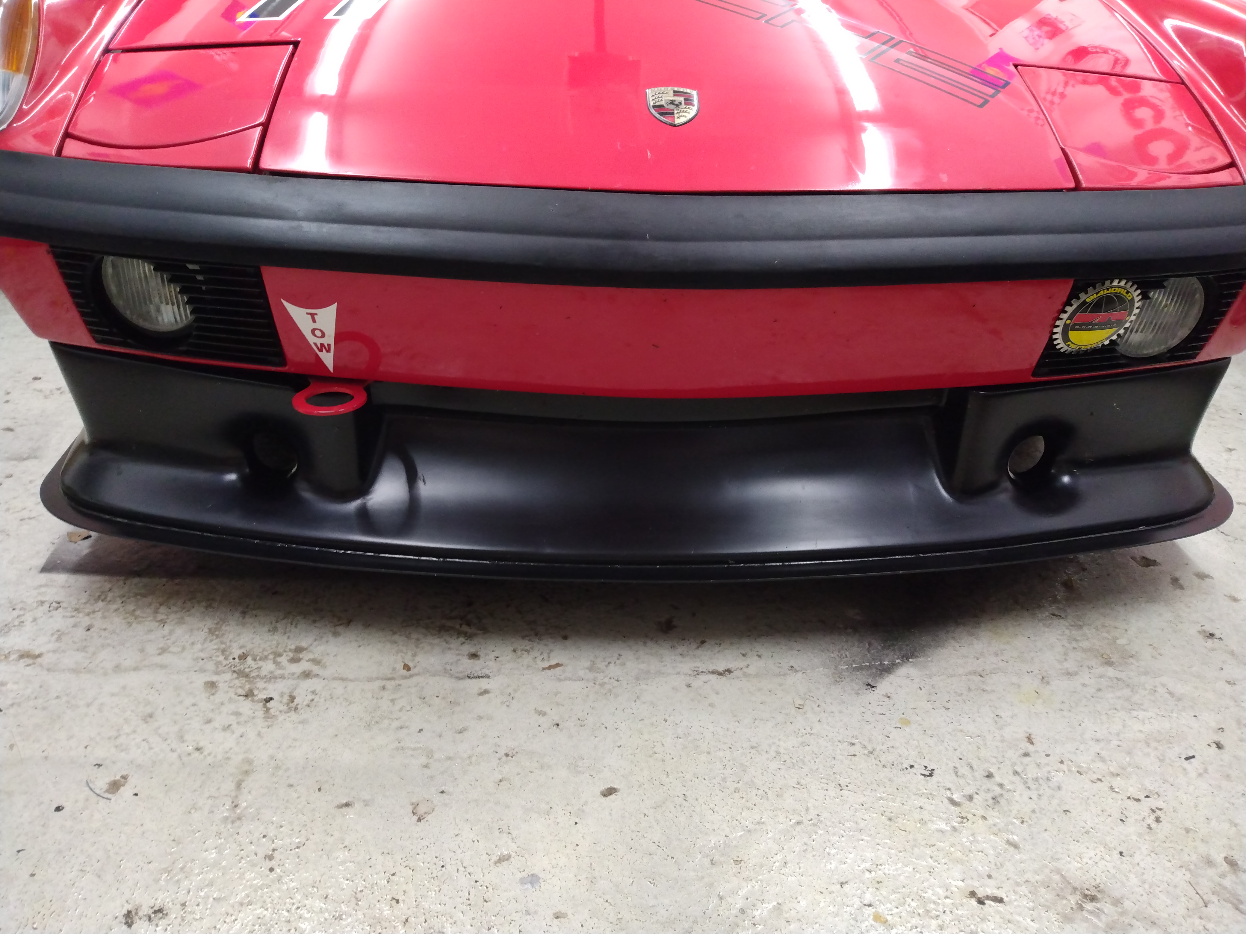

My 75 with backdated bumpers and Sheridan front spoiler.Click to view attachment
