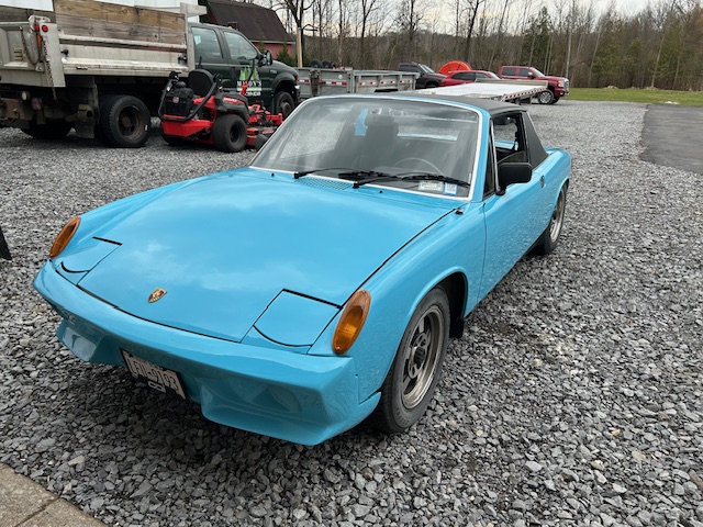

Pretty blue!
Nice looking car!
That nose cap is a reproduction of the 916 nose.
The poor-quality ones change width of the upper surface.
The decent ones (like yours!) do not.
