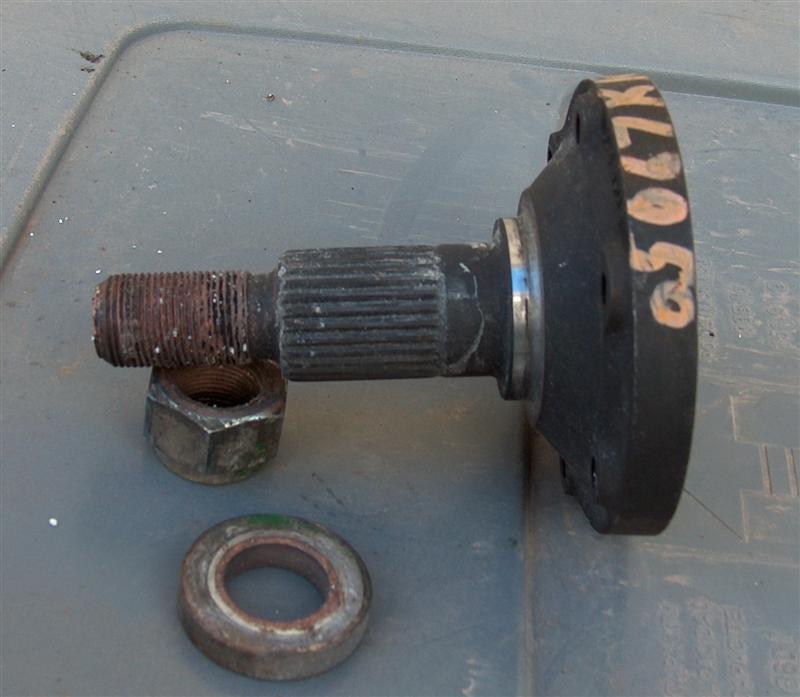

I thought I had (mostly) a good grasp of this "conversion". Except for the spacer part. Can someone elaborate? Or even *GASP* show pics?
ClayPerrine
Same pict I posted before.....
John
Those spacers go between the Wheel Bearing and the stub axle? For which axles?
How thick are those?
I could turn those on my lathe.
Aaron Cox
QUOTE (JOHNMAN @ Sep 20 2005, 12:29 PM)
those take up the dust seal area..... on a 944/951 STUB....
ANDY said 3/16 thick....
i can get some dimensions for you...

Gint
QUOTE (ClayPerrine @ Sep 18 2005, 07:15 AM)
And what about the collar on the shaft that Mueller turned down on his lathe for someone (I forgot who, Sirandy?)?
ClayPerrine
The 914/4 shaft has to have a 1/4 inch turned down behind the splines to allow the 944 CV joint to slide all the way on.
That has nothing to do with the stub axle spacers that are needed for the bearings.
Aaron Cox
QUOTE (ClayPerrine @ Sep 20 2005, 01:11 PM)
Clay - where does this spacer touch the bearing?
and do you have any dimensions for this spacer?
ClayPerrine
It fills the gap between the stub axle and the inner bearing race.
No, I don't have any dimensions. Just pictures.
Aaron Cox
QUOTE (ClayPerrine @ Sep 23 2005, 03:37 PM)
ok. all i needed to know. it rides the bearings inner race.
