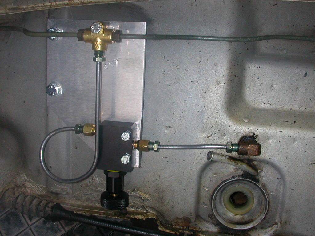

J P Stein
I put an adjustable valve back there. 40-50 bucks.
Not a bad idea JIC there's a brake upgrade in your future.

user posted image
J P Stein
YA gotta reach under there to get at it....this involves laying on mother earth. The tough part is getting up biggrin.gif
Allan
QUOTE (J P Stein @ Nov 12 2005, 09:30 AM)
So how do you determine correct bias? Front lock up first? Seat of the pants? Skid pad?

fronts should lock up right before the rears do IMO
