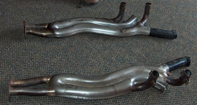

On a stock D-jet 2.0, is there any benefit to going to header instead of the heat exchangers?I have the engine out, the exhaust off, and want to know the score.
I know that will loose cabin heat, but, well, it just aint that kinda car
Do the headers weigh any less then the exchangers?
I have the old, rusty stock exhaust. Can I do better? I have read tht the stockers flow pretty well. But it is heavy as hell.

You can go with SSI (Stainless with H/Es) or Euro Race Header, Tangerine Racing's header...
Mueller
Dec 3 2005, 01:13 AM
your stock system sucks
....worse design out there is the '75/'76 exhaust....'73/'74 2.0 stock or any model SSI would be a big improvement
Headers such as the Eurorace would be better than the h/e's due to better flow and weighing less
top of the line is Tangerine racing
sean_v8_914
Dec 3 2005, 01:19 AM
the stainless HEsw weigh alot less that stock HEs

To gain 6-7hp install the early style 2.0L SSI HE's witha Bursch or Triad muffler.
If you want more install a Tangerine Header and lose the heat.

Unless it's going to be a race car, the SSI exchangers are the way to go - even if you don't need heat, windshield defrost sure is nice!

SSI's have a larger dia. tube, so flow is better with them. also, heat is better/faster ...
i even ran a set of 1.8L SSI's on my warmed over 2056 without trouble ...

I think there are some on their now for about that, probably a little more. IIRC the ID of both 1.8 and 2.0 SSI HE's is the same, so they both flow the same amount, just with the 1.8 you need to run a different muffler (which means no triad b/c they do not make a 1.8 model)
VaccaRabite
Dec 5 2005, 09:04 PM
So, the 1.8 SSI exchangers will fit and work on a 2.0 engine? Am I reading that correctly? The bolt up correctly to the exhaust ports on the 2.0 engine? The are the right length for the muffler?
What would be the point of differentiation then? Are the flanges different for the 1.7/1.8 mufflers then the 2.0?
Zach
Bleyseng
Dec 5 2005, 09:40 PM
There is a bend at the end to locate the muffler flange higher to fit a stock 1.8L muffler. They work fine.

if you are changing over to the 73-74 style HE's you also need new Jtubes, S warmair guides and those tubes that go to the flapper valves to make it work. It can be off any 70-74 early style HE set up it took make it all work.
