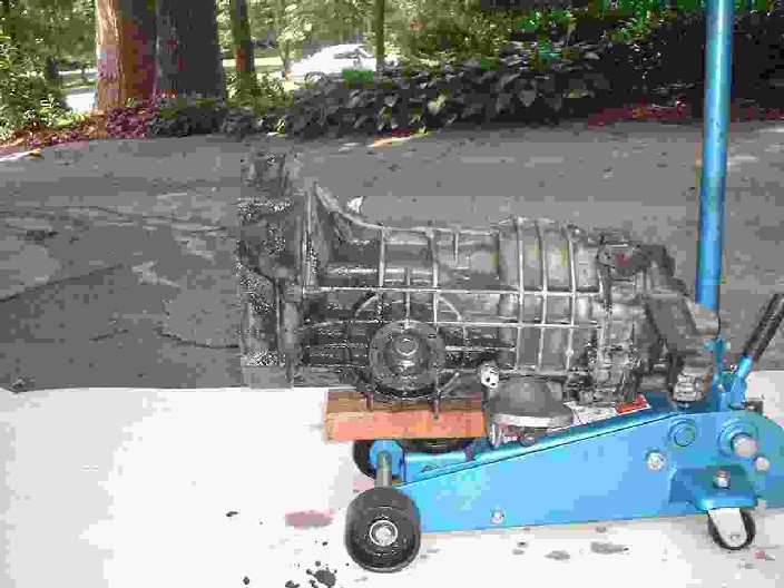

Easy. Support engine from below, remove exhaust, then tranny.
So.Cal.914
No you do not have to drop engine. Renove air box if it is a clearance problem.
Put jack under trans and unbolt lower trans mounts and lower until it is clear to remove. Than
take note how much you will have to block up engine at rear. Jack up engine/trans and
place blocks in front of trans at rear of block to support engine. When you replace
tail cover, replace the gasket. Iam sure you can take it from here. Have fun.

there is a little 'nub' on the sump of the case that works great on a jack or a jackstand....
to me, its easier to drop the whole assebly then just the trans... but we have done it both ways.

I've done this, it was easy lowering the tranny with a floor jack. One person job.
