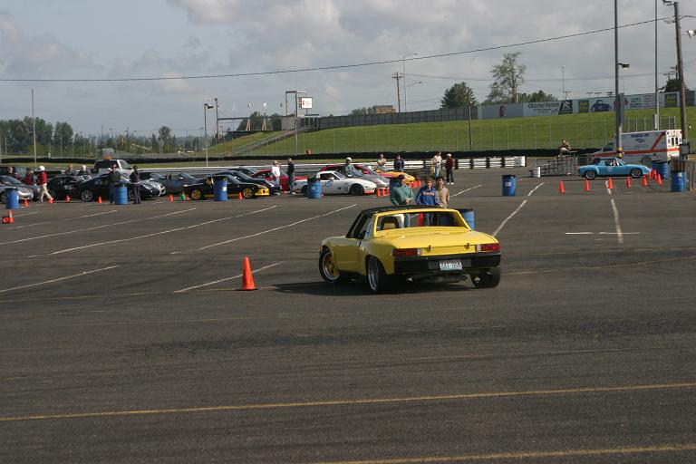

J P Stein
When I put wider rear flares on my car they collected cone guts
like there was no tomorrow. The new width takes some gettin' used to....it's always there, so ya gotta take it into account. I don't think I've hit a cone in 10 passes this year. I even missed this one......we're a bit crossed up.The direction of travel is right to left.....Click to view attachment
