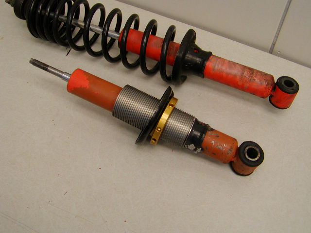

for the rear, the correct method is to use adjustable perches like Andy mentioned....
Koni Yellow and Bilstiens come standard with grooves in the shocks that allow you to move the perch up and down in about .50" to .75" increments with the use of a cir-clip
For fine tuning, threaded collars are sold for the Konis and Bils. or if you are cheap like Mike, you adapt threaded collars to your stock Boge shocks.
IPB Image
