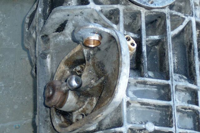

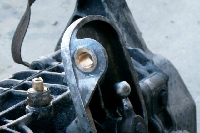

I purchased a similar product from GPR couple years ago and it works just fine:
Click to view attachment Click to view attachment If your side-shift housing is ovaled out (as mine was) from the previous bushing flopping & banging around, you might have to JB Weld it into place to ensure that IT doesn't do the same, causing a sloppy shifter.
