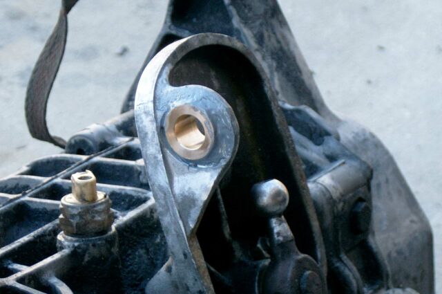

I'm using this one,,
http://cgi.ebay.com/ebaymotors/Porsche-914...sspagenameZWD1V
Is this the bushing you're asking about?
It replaced a plastic one that was shot. It seems like I'll never have to replace this bushing again. It slips right in to the shift housing and is held in with a snap ring. It was really easy to install.

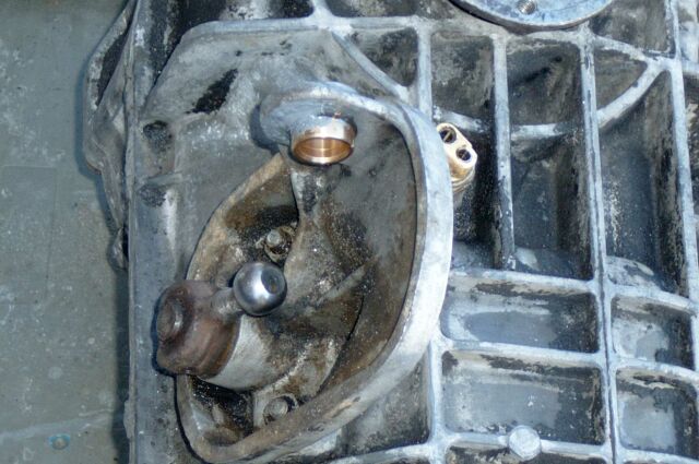

I purchased a similar product from GPR couple years ago and it works just fine:
If your side-shift housing is ovaled out (as mine was) from the previous bushing flopping & banging around, you might have to JB Weld it into place to ensure that IT doesn't do the same, causing a sloppy shifter.

I also made mine out of brass (not bronze). I expect it will wear out and I will repalace it with oilite. I didn't have any on hand earlier. My console was worn out. Looks like this is a very common problem. My solution was to mill the hole oversixe and make an oversize bushing. My bushing uses a "C" clip on the inside to hold it in place.

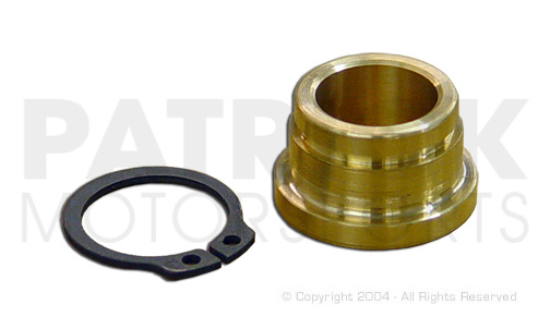

Available from Patrick Motorsports(duck...here comes a Z rant (IMG:style_emoticons/default/biggrin.gif) ) for $38.
I'm getting one for mine as my bushing has popped out twice, even after the JB Weld treatment.
