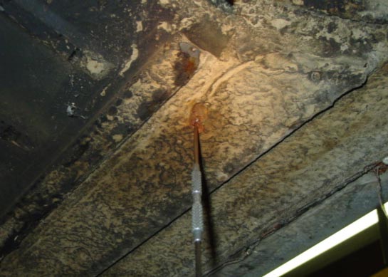

I bought my 75 914 2.0L off E-bay in San Hose CA and dragged it home to Kansas City Missouri (36 hours one way). After I got it home I parked it in the garage for a year.
I didn't get a key, or a battery and have no idea the condition of motor or trans. I was assured it was almost a rust free car when I bought it and it seems to be. I found one hole the size of a dime in the floor pan. Still have some disassembly to do to inspect for rust.

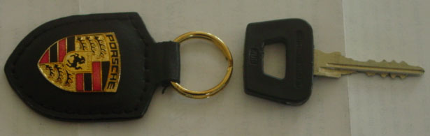

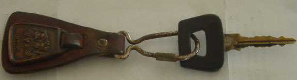

I saved the steering column from the orange porsche to use on this car since it came with no key. I asked my wife to hand me the key and she wouldnt touch it.
yucky key
So using the skills I learned here on the 914club I restored the key and came up with this!
I decided it was too much work to replace the steering colum or ignition switch and I didn't want mismatched door locks, glovebox lock and hood lock. So I decided to cut a key. I had read the pelican article on how to "rekey the lock" but I used that info instead to make a key to work in my lock.
I cut one side of the key myself by...
1. removing and disassembling the RS door lock
2. using a dremel type grinder to shape the key till the tumblers weren't sticking out.
3. Then after "cutting" one side I took it and a blank to a locksmith and he cut the second key off the first key then cut the 2nd side of the first key off the 2nd key. (whew thats a mouthful!)
The whole time I'm thinking.... Hope the ignition is the same as the door lock. Luckily it was.

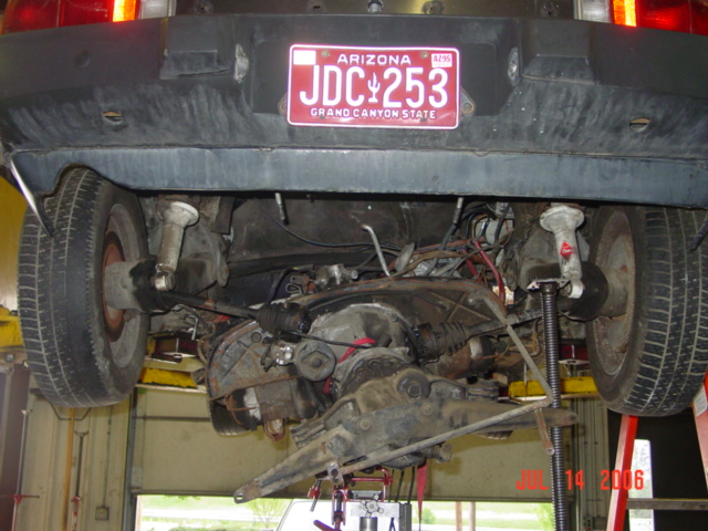

Got engine out. Looks like its about ready to fall but I have it strapped to the jack. I should've pulled the trans first. That thing hard to balance. Any future engine installs or removals the trans seperated in the car.
Here's me pulling engine. Notice the Arizona License plate. (almost no rust!)

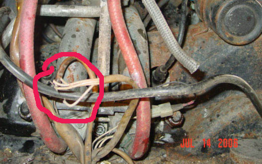

Lots of extra problems noticed. Rats had eaten through the fuel lines and the MPS wires. Good thing someone didn't try to start it. The fuel would've squirted everywhere. Rat $hit was everywhere in the engine compartment. Why do I always have to get the rat infested cars. The orange porsche had dead mice in glovebox and under the seat! My VW Jetta (turbo diesel) had rats nest and associated rat $hit under the back seat. I guess I need to stop buying cars that have sat for ages.
MPS wires. All 4 of them are white. I will solder and heat shrink them back together if someone ohm check a harness and tell me which one goes where.
Pic of MPS problem.
MoveQik
QUOTE(CoolAirVw @ Aug 23 2006, 08:45 PM) *

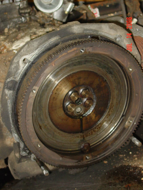

I found the problem that parked the car. Note: While removing the engine I found the clutch cable allready disconnected from the trans and found the shifter link gone. (actually I think that means I didn't find the shifter link) Wonder why someone was working on the shifter and clutch??
Note: Need help with MPS wires pictured above.
mihai914
You can find the correct diagrams HERE thanks to Jeff Bowlsby, he does rebuild and repair these harnesses, I think the only problem he has is that no one complains about his work smile.gif
In a constructive way... why didn't you put a table under the motor and raise the car up, the engine seems really dangerous hanging like that.

My flywheel is all worn out. Not turnable. Anybody got one they would sell. Maybe someone close? (John). Need a flywheel bolt too. What flywheel bolts are you race guys using?
I have access to a flywheel machine to resurface the flywheel so if ya got one that has alot of meat on it but slighty grooved, worn, heat cracked ect I could probably use that one.
Would one work out of a 1.7/1.8 car?
mihai914
All flywheels are the same on 4 cylinder cars. Buy some new bolts, if one broke the other ones can't be that good either. Those bolts are supposed to always be replaced with new ones when servicing the flywheel.
You should post a want ad in the classifieds, plenty of people have good used ones available.

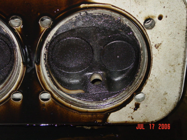

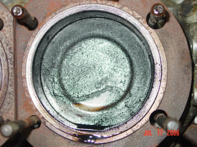

I took some pics of the condition of the motor while it was apart. Pics of the cam and rods with the jugs out were poor quality because of lighting but here's the heads.
And the dished pistons
Since I work in a trans shop we have a "steam cabinet" type parts washer and everything cleaned up nice, more pics to come.
