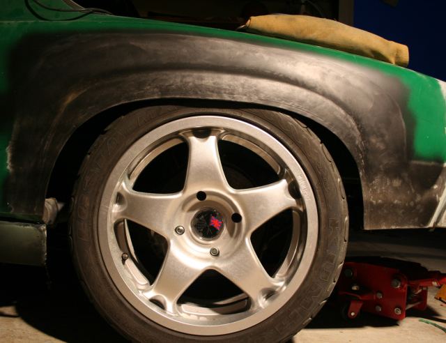

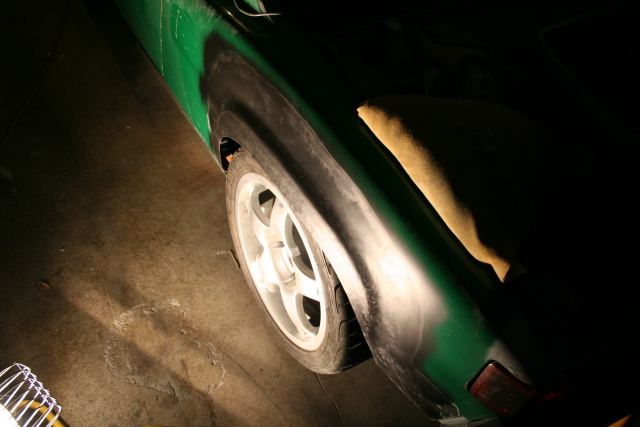

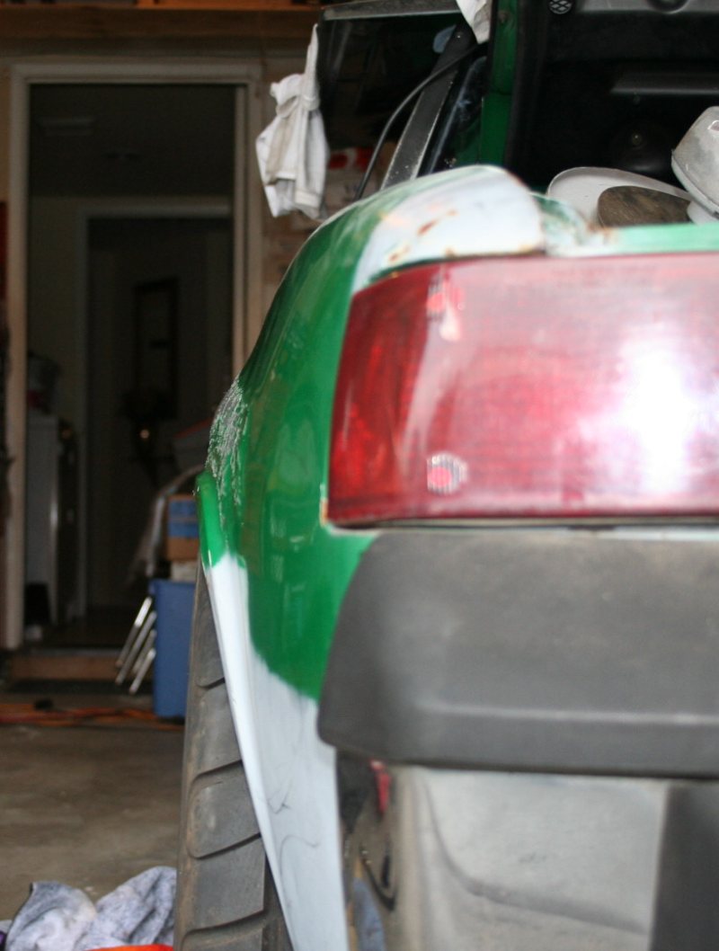

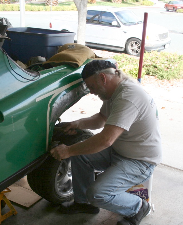

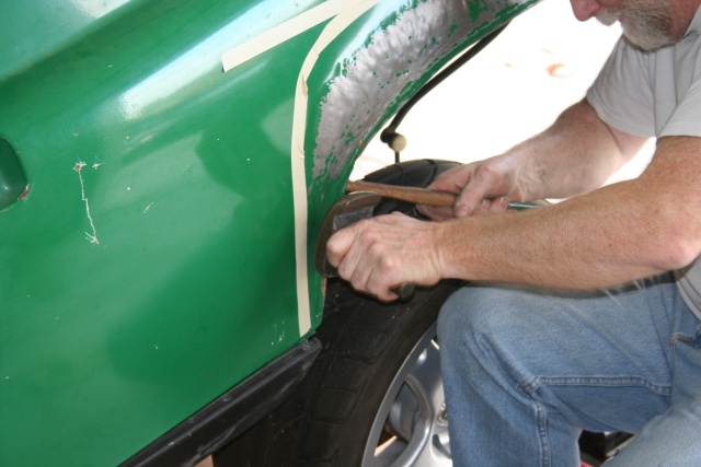

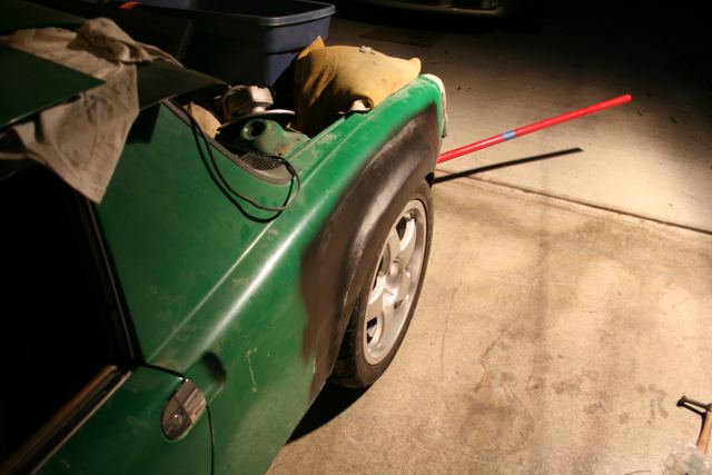

started the drivers side rear qtr panel..this was about 10 minutes worth of work...
...going for a faux GT flare look....
Click to view attachmentClick to view attachmentClick to view attachment

so step 1, palm nailer. step 2 - planishing hammer?
very cool man! does it wake the kids up?

yep, palm nailer...word of warning, don't "test" the palm nailer on your hand...ouch....
kids are at granndpas house with mommy...time for daddy to play

This is really cool. Post a picture of a palm nailer. I think this is THE way to do flairs. John the ghia guy who handformed his (as shown in his avatar- I'm blanking on the screen name though) was having a class in this this past weekend. I would like to learn this. Does it get sofeter as you work it, or do ya just beat the sh!t out of it until it is where you want it? Take some more pictures- difernt angles, etc. Is this the first side?

Mike, I need to have John Kelly make me a pneumatic planishing hammer. It makes quick work of smoothing out the lumpy-ness.
Aaron, without a planishing hammer setup, it's hammer and dolly work to take out the lumps.

The metal is consistant, actually as you go from a flat metal to a rounded metal, the metal becomes stronger, yet ever so slightly thinner.
PanelBilly
Nov 12 2006, 10:21 PM
You can get an optional hard rubber plug that threads onto the palm hammer. We use them at work for pressing in PVC t-mold. The plug has about a 1.25" diameter and the impact is spread out much more than the nail fitting

Way to go Mike! There are a couple of ways to smooth that are faster than hammer and dolly...without a planishing hammer. The first one is a slapper replacing the hammer. It covers more area than a hammer head, so each blow is slightly more effective. The second way is to make a nearly flat die to fit over the bolt in your palmnailer. First use the carriage bolt or my updated tooling (see my album link below) to stretch, then use the nearly flat die (with sand bag on the outside) to go over the area you have stretched. This will do a lot of smoothing for you. Make sure the sand bag is packed really tight with sand. Has your carriage bolt shaft mushroomed yet? I started using a grade eight bolt and homemade dies instead...holds up better. Maybe the rubber die that panel billy mentioned could be used with a piece of hard plastic held on the out side of the fender to smooth after the initial stretching? Depends on how hard, wide, and flat it is.

Nice job at it. do you plan any heat treatement to soften the metal up? Too much streching of the steel might allow it to crack later. Maybe get it hot, then slow cool????

dmenche914, heat is not required. The metal will take a lot of stretching before any failure...especially if you smooth the metal betweeen stretching sessions.

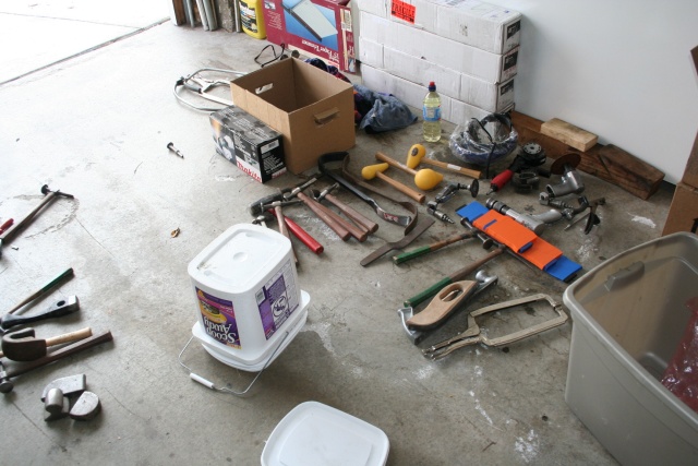

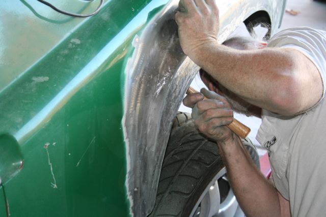

Mueller
Nov 18 2006, 01:26 PM

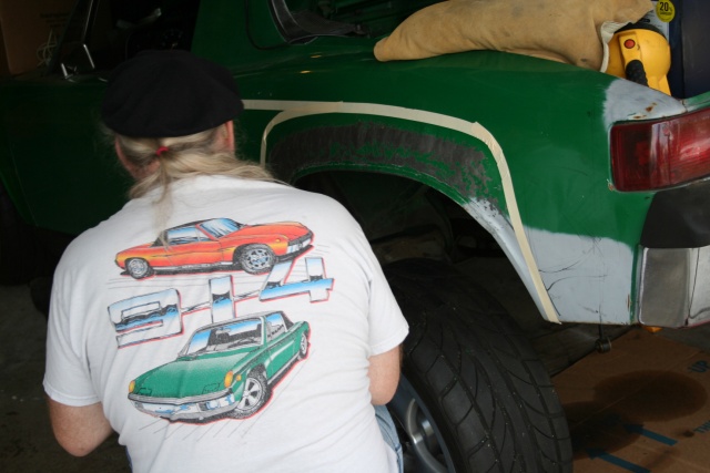

non-club member Jerry McCarthy (sp?) is hammering away as we speak....
Andyrew
Nov 18 2006, 01:27 PM
I have all those tools!!!!
lol
Cool beans!

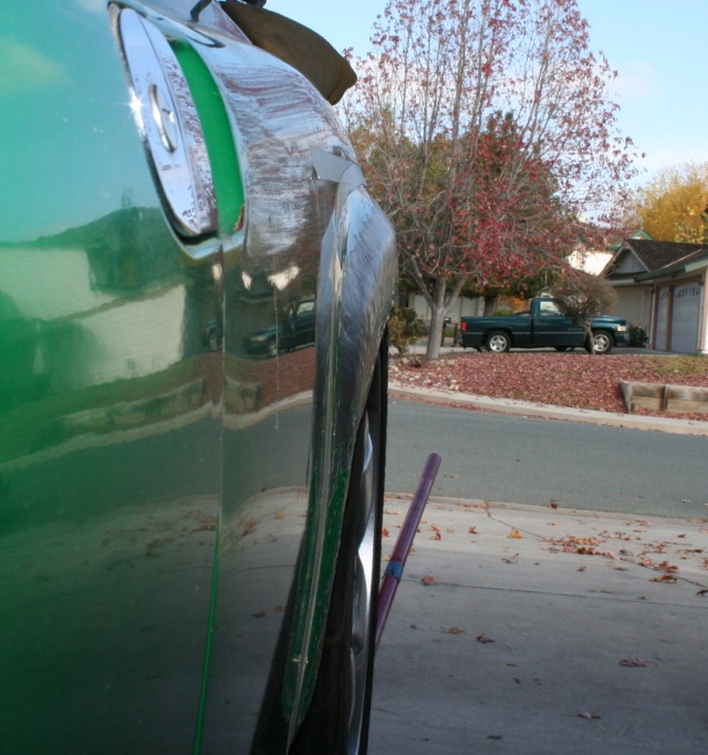

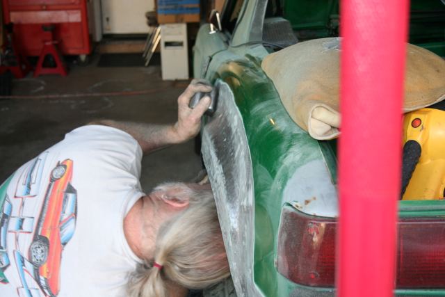

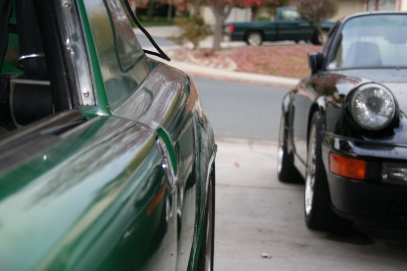

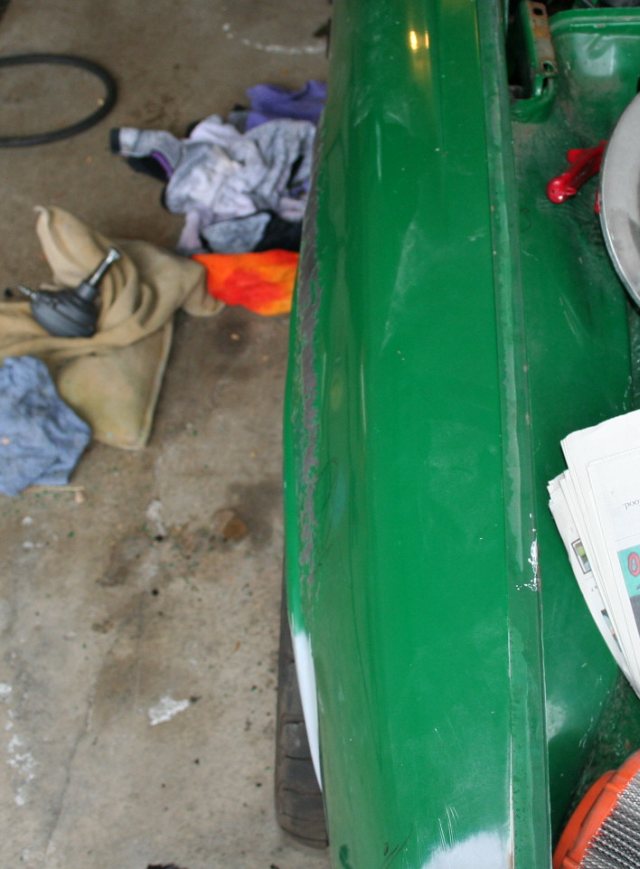

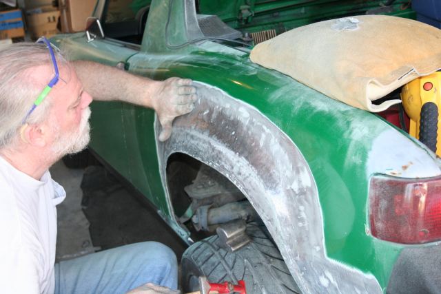

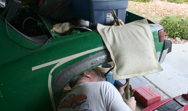

It's not my "thing"....I've learned to have a pro do certain jobs

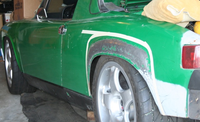

Click to view attachmentClick to view attachmentClick to view attachmentClick to view attachmentClick to view attachmentClick to view attachment
Mueller
Nov 18 2006, 07:39 PM
no body filler....all metal formed....the black is just a guide coat to cut down on the reflections and to see the metal better.....more work on Sunday
