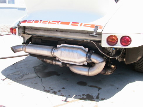

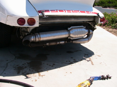

OK...let me esplain this REAL slowly so that the smog exempt weenies can understand.
There's a 3.6 in there....I wanted heat, so I have modified 993 heat exchangers and I had to swing the flanges 90 degrees to fit.....it's an 83 body, it needs to pass smog....so that means a mixing area for the 02 sensor, a CATALYTIC converter, and a muffler AFTER that....in limited space....AND passing the San Diego PCA dbA limits when AX and DE....so.....the Supertrapp brings it down within that limit.
Sucks driving 4 hours and getting black flagged because my pipe is too loud.
Click to view attachmentClick to view attachmentLot of work to be reasonably quiet, smog legal and have heat.....it sucks having 280hp in a 2600lb car.....
