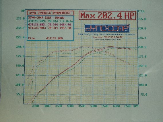

The 'E' Cams are the hot setup for a 3.0 with Webers. Ton's of Tourqe down low. I get 200 HP with as much torque to the rear wheels. The valve clearance is close, I think it still has the CIS pistons.
Here's the dyno at the wheels:

I agree...my engine builder used "E" cams and cosworth pistons. Topped my 3.0L off with some 46 webers. Love it.................. biggrin.gif
