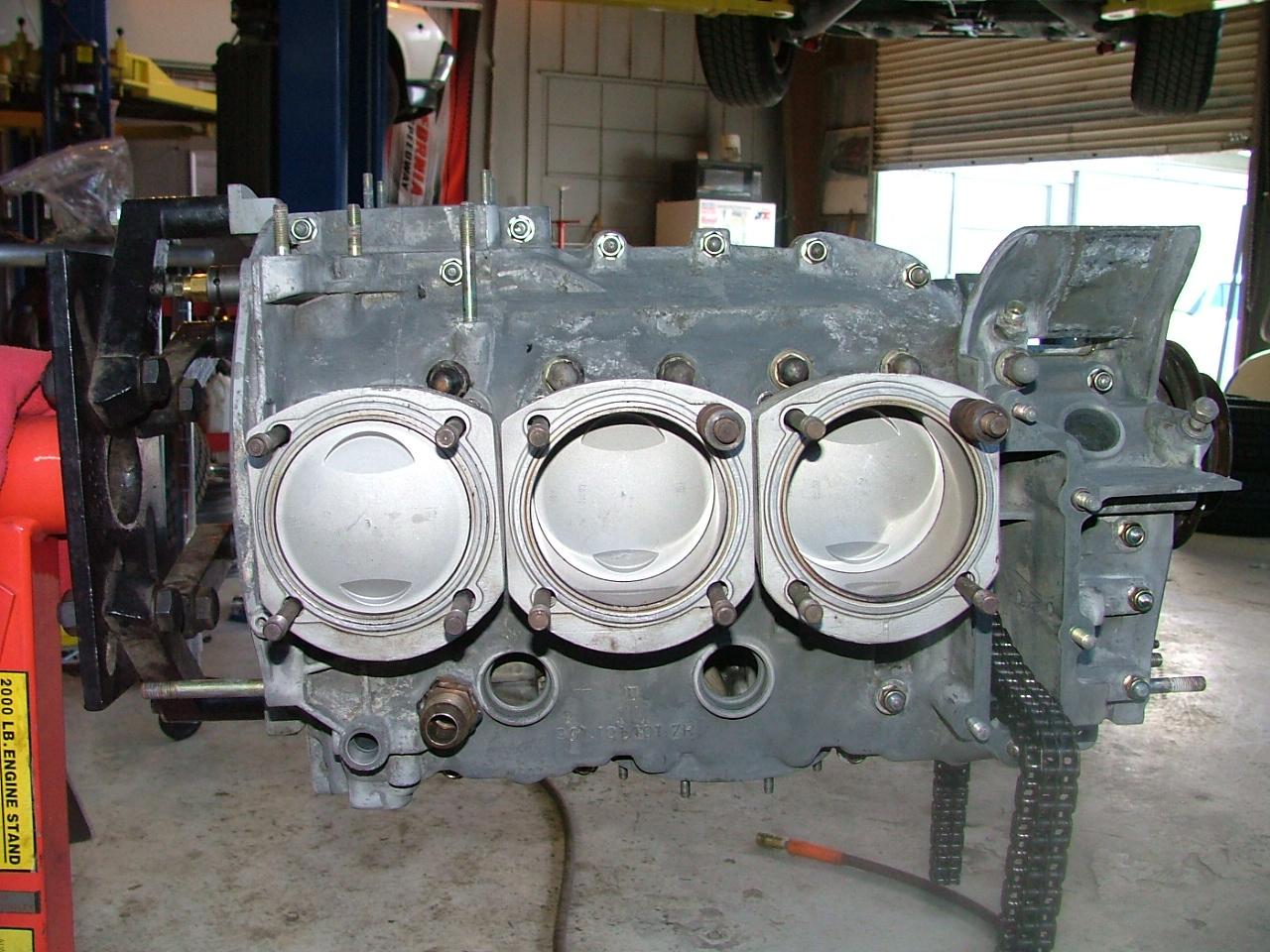

QUOTE(James Adams @ Feb 7 2007, 01:15 PM) *
The problem is that valves will hit the pistons with the more aggressive cam grinds.
So change pistons and cams if you want something like S or Solex profiles
Like these... (IMG:style_emoticons/default/biggrin.gif)
