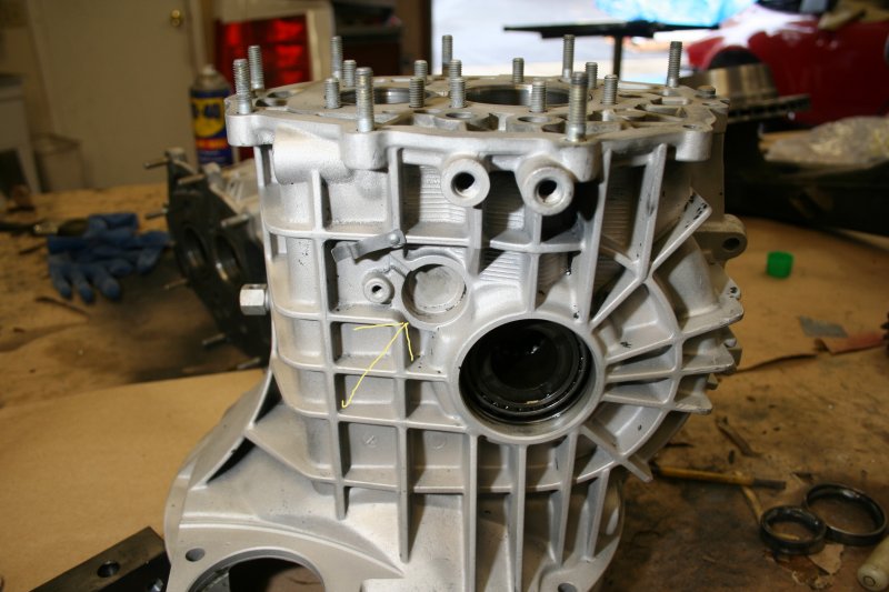

Here is a pic of the ring gear swapped and a stock cover. Note the thrust is now towards the solid part of the case unlike using it in a 911.
Click to view attachmentClick to view attachment

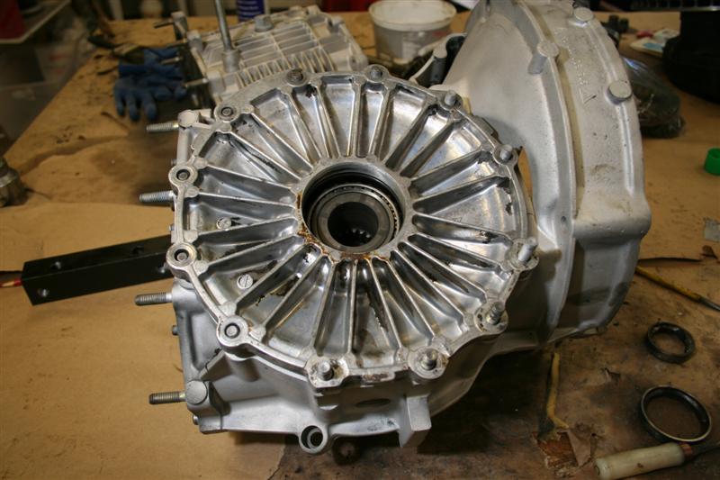

And here is how the speedo pickup is recessed in the case (stock)

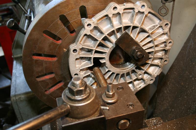

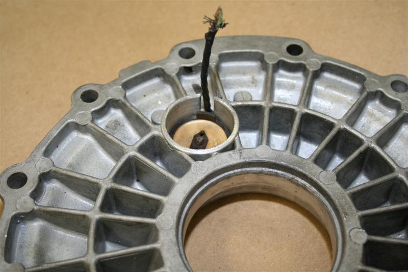

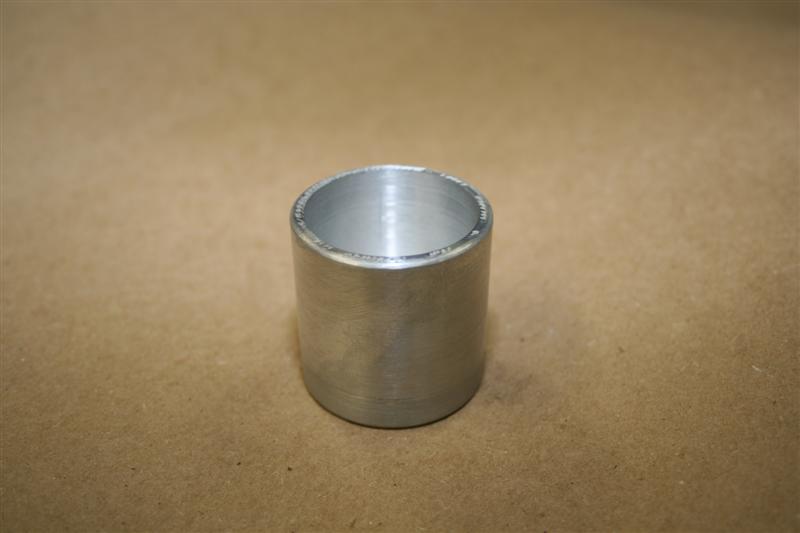

OK, I machined my side cover and pressed in a cup to receive the sensor. It was a lot of work but free....The sensor is now exactly the correct distance from the magnets.
Here are a few pics....
In the lathe
Click to view attachmentCup made with .004 press fit.
Click to view attachmentThe finished product
