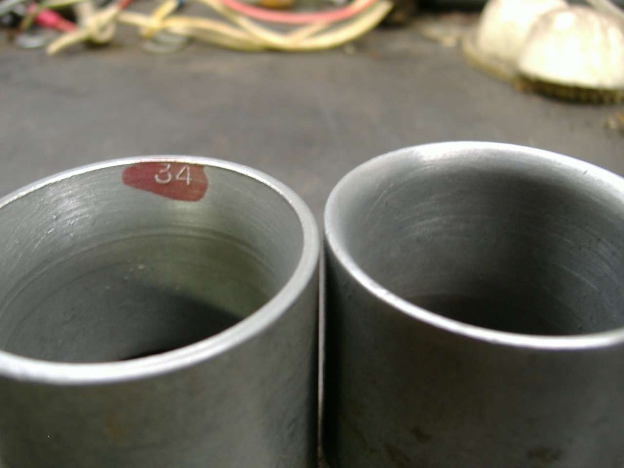

40 Dells were usually equipped with 34mm venturis from the factory (hence the urban legend that 40 Dells flowed like 44 Webers which were also equipped with 34mm vents, but I digress)
The pump jets you have, being 55s, are probably enough to flat drown a 1.8 if you blip the throttle real quick a couple times. Just for reference, I've got 40 Dells on a 2056 with 30mm vents, 125 mains, 60 idles (CA gas, may it reek) and *40* pump jets. I could probably do with 35s just fine, but the 40s work, so they're staying. Your problem, whatever it is, is NOT due to the the size of the pump jets....the pump jets' function is to meter fuel when the accelerator pumps pump. They have nothing at all to do with steady-state running.

The vents for the 36mm Dells also fit the 40s (same carb body), and you can get them down to 28mm at least. Just a thought. Can't say if CB has them, though.
Oh..almost forgot.....if you look down the carb throat at the top edge of the venturi, you'll see a number that indicates the venturi size.
Are you sure, or is it possible to put the in upside down, so that the numbers are at the bottom? I took a flashlight and stared at them for about 5 minutes and couldn't see anything.

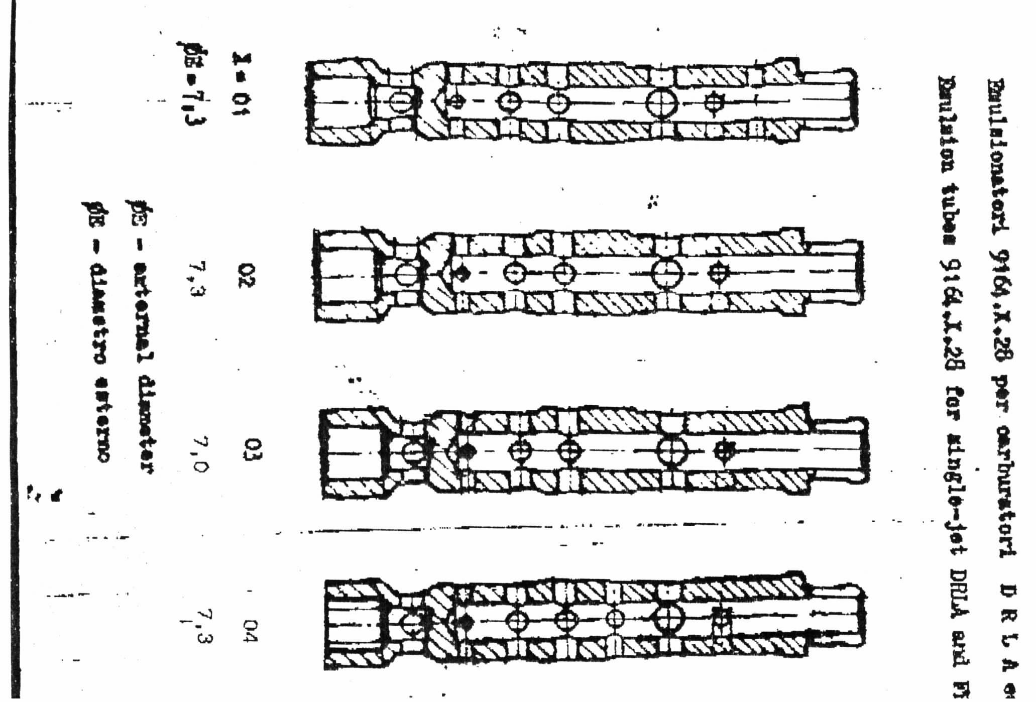

I've ordered some 185 and 200 airs, and have checked the emulsion tube. I have a 9164.1 tube, but the guy that sold them to me said "I drilled them out, so they are they same as the 9164.2". Does that sound right?

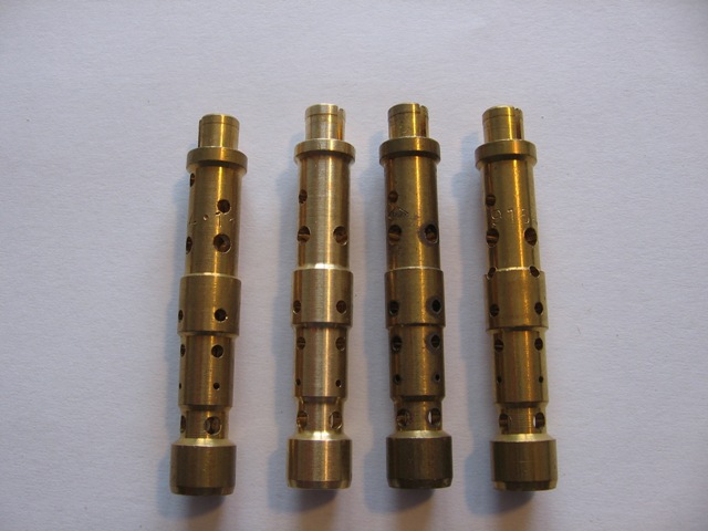

I'm pretty sure the dell manual recommends 180 airs for most applications, you could order the reamer kit and open up your 175s. I'm not entirely sure how the airs come into play in the whole scheme of things, but messing with it may clear up that transistion problem you have.
You can't "drill out" a .1 to a .2. You have to plug certain holes. I went through this ordeal with some poorly modded .1s that were supposed to mimic .2s. There are two upper holes you have to plug in order to get the .1s to be close to .2s. The raised middle band of the .2s is slightly larger than the .1s, but at 20+ dollars a piece, I'm getting by with the plugged .1s.
These pics should give you an idea about what has to be plugged. Hopefully whoever "drilled" them didn't actually drill them!

BxtrBill
Jul 16 2007, 09:47 PM
Hm..hadn't considered someone might put them in upside down, but it's entirely possible to do so. I can't say what to expect from an upside-down venturi, but I'd be fairly certain the carb(s) wouldn't work as designed....I'd guess it would upset airflow by moving the low-pressure area of the venturi lower in the carb, but I never tried it so don't know what to expect. Before you do anything else, it may be worthwhile to check one more time for the numbers.....they're small, but they *should* be there. If they're not, someone has reversed the vents in the carb body, maybe the same guy who "drilled out" the emulsion tubes (hint: don't ever do that) Emulsion tubes, in concert with the air correction and main jets, control mixture in relation to airflow. E-tubes are available to lean or richen the mixture at different spots in the rev range, but generally you're best off with the tubes that came with the carbs. You should be fine with 180 airs, too....you can go to 200s and that will have the effect of leaning the mixture slightly across the range, but to no real advantage.
It's easy to remove, then reinstall the vents correctly. Remove the air cleaners and the top cover of the carburetor. If you're really brave, do this while the carb is still on the engine. I'm not that brave, so I do this on a bench. There is a set screw with locknut at each end of the carb body....loosen the locknut, then the setscrew, and remove the aux (boost) venturis, then the pump jets. If the carbs have been cleaned recently, the main venturis should slide right out...if not, they may take a bit of gentle persuasion. Nothing drastic, please...they're just potmetal. Stick 'em back in with the numbers toward the top side of the carb, and screw everything back together. Or as the Haynes says, "Assembly is the reverse of disassembly"

Here are my etubes, and a shot down the mouth of one of my carbs. Just so that I'm not loosing it, the main venturi is the large sleeve that the red arrows are pointed at right?
terrymason
Jul 17 2007, 12:51 AM
etubes
type11969
Jul 17 2007, 07:22 AM
Looks like at least that one etube had one of the proper holes soldered shut at the top, check to make sure that is the case all around.
Yes, that is your vent.

BxtrBill
Jul 17 2007, 10:04 PM
Click to view attachmentHere's a pic of the venturi out of the carb....the one on the left shows the number (with a bit of highlight...they can be a booger to see) and is "right side up", or the way it would be installed in the carb. The right one is upside down and you can see the fairly pronounced radius on the bottom end. This would be nearest the throttle plates when installed.
Of course it's always possible someone removed the numbers.....there's a fun thought.

Joe Ricard
Jul 18 2007, 06:00 AM
That' odd having the blunt end of the Venturi on the inlet side.
Weber carbs have the taper on top. which makes more aero dynamice sense.

I'm pretty sure that is reversed, I'm almost 100% sure the vents in my dells are installed with the radiused edge pointing up.
BxtrBill
Jul 18 2007, 11:14 PM
QUOTE(type11969 @ Jul 18 2007, 06:03 AM)
Quite right...don't know what I was thinking (or IF I was thinking) about the radiused edge. Turns out *some* OE Dell vents have the number on the radiused edge and some have it on the "straight" end. Checked the ones in the white car (Dell 40s) and they're right up top on the radius.....checked a still-in-the-box set of Weber 44IDFs and they're in the same place. Checked the 40IDFs on the blue car and, sure enough, the number is on the radius. Sorry for the confusion.

well, I've made alot of progress! I have installed new 30 venturis, and re-adjusted the linkage (one side was about vertical, while the other was a an angle). The car no longer backfires, and runs much better, but it does still go lean when switching from idle to main circuit.
I noticed that the auxiliary venturi (the tube over top of the main venturi) don't all match. 3 of them have the number 2 stamped on them, while one has the number 1 on it. I'm assuming that this is a measurement of some sort right? What size should I want? Any idea what this would cause?
Thanks guys! It's great to have my car running again!
terrymason
Aug 2 2007, 02:40 PM
You can actually see the aux venturi below
