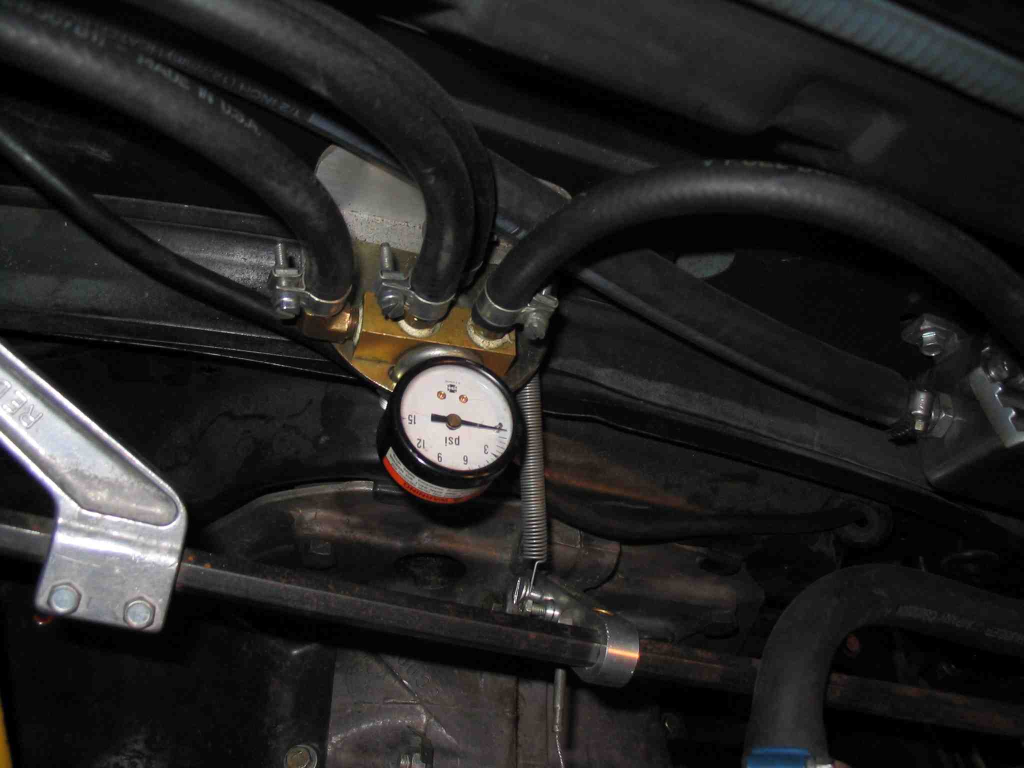

Dual Dellorto carb setup, the carbs tend to snap under load. After tinkering for a while with airflow and linkage and not resolving, I am going to go to basics and check fuel pressure. How do I measure this? Is there an inline guage I can buy?

I am still using D-jet so my gage is different. I got a gage from McMaster Carr and some hose. For FI, a 60 PSI gage is best for measuring in mid range (29PSI). My gage is also filled with fluid so it reacts smoother. You can get gages in all sizes and ranges and from cheap to expensive.

oh yea, and a gauge. mine's pretty lame compared to others trick setups... but it works.

Next, I went to Sears, and bought a cheap made-in-china fuel pressure guage. I'll be returning it, it's crap, but.... I am reading 3 to 3.25 psi before the carb Tee, in the engine bay. The guage is not that fine to read more precisely. It's a very new CB pump, by the way.
