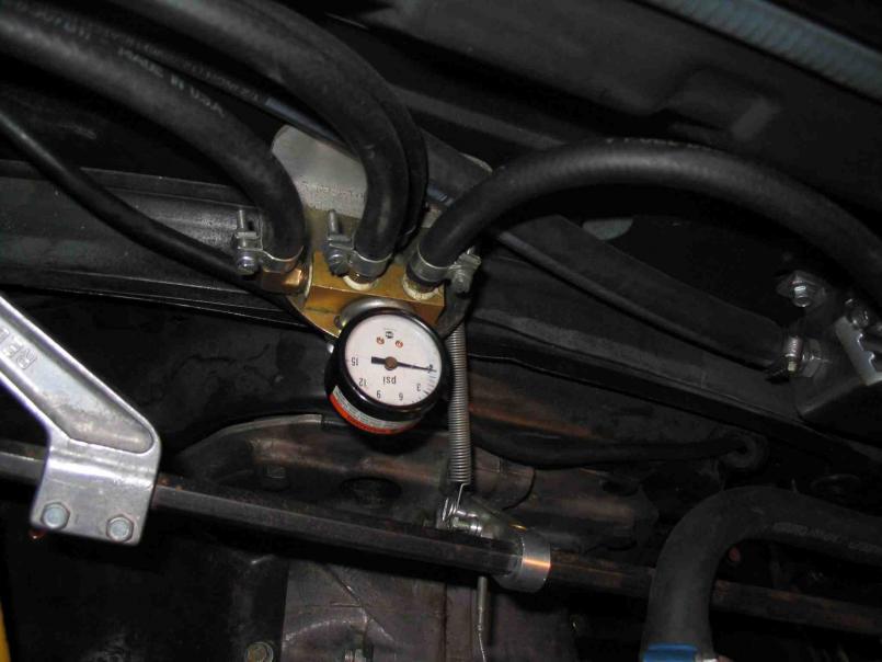

Dual Dellorto carb setup, the carbs tend to snap under load. After tinkering for a while with airflow and linkage and not resolving, I am going to go to basics and check fuel pressure. How do I measure this? Is there an inline guage I can buy?

rhodyguy   confirm valve adj and timing first thomas. what pr...   Nov 3 2007, 10:20 AM
thomasotten   confirm valve adj and timing first thomas. what p...   Nov 3 2007, 10:49 AM
Bartlett 914   Dual Dellorto carb setup, the carbs tend to snap ...   Nov 3 2007, 10:23 AM
lotus_65   you have a return setup still, right? you HAVE to ...   Nov 3 2007, 12:55 PM
McMark   :agree: and you've got a quality pump, so get ...   Nov 3 2007, 12:56 PM
lotus_65   oh yea, and a gauge. mine's pretty lame compar...   Nov 3 2007, 01:09 PM
rhodyguy   the cb pump he's running does not have a retur...   Nov 3 2007, 01:32 PM

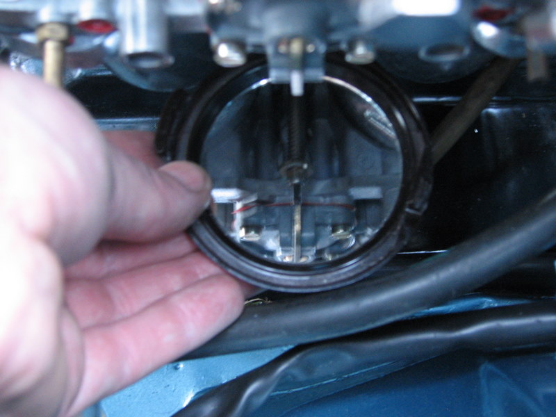

thomasotten   Well, I took the carbs off, and made sure the acce...   Nov 9 2007, 04:19 PM
type11969   Did you clean out the acc pump circuits? Did you v...   Nov 9 2007, 04:32 PM
