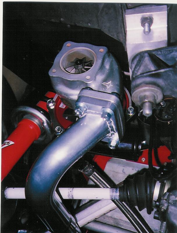

Feb 19 2008, 08:57 PM
Click to view attachmentQUOTE(dr914@autoatlanta.com @ Feb 1 2008, 06:39 AM)
Kerry is out of the header business. MSDS took his and improved upon it It is really fabulous. $548.00. You listening Marty?
Sure I'm listening George, but I've been under a certain car stuffing 2 of these under it ! You have been selling the 2.0 headers at a decent pace...I hope to keep up with your demand. BTW, if anyone needs a set...these are exclusively available from Auto Atlanta.
Marty
