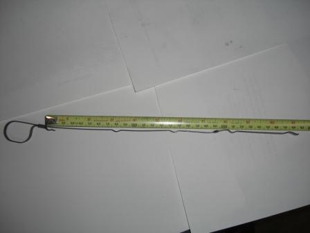

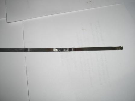

Changed the oil last week in my recently aquired 914-6, and consistent with other experiences on this car, something isn't quite right. this is an original 914-6 and still has the original oil tank, but it looks like someone made the dipstick by cut and weld from another car. Can someone tell me what the dimensions are from the top of the dipstick, where it nests in the oil tank, down to the 'full' and 'add' marks should be?

Jeffs9146
Here is a photo of mine!

Thanks Jeff.
That's strange, looks like mine is very similar to the original but with addt'l length added on. Anybody have ideas why someone would do that? I know the car spent time at DE days and autocrossing. Is it typical to run them low in high g situations? I've heard of running the 911s on the low side of full, but not enough that you would need to extend the dipstick.

IronHillRestorations
Then I'd go with 165mm from the clip.
6freak
QUOTE(plays with cars @ Oct 8 2008, 08:40 AM) *
Click to view attachment Click to view attachment
That one looks like mine more then the other one does .they crack and break thats prolly why its welded.Mines been welded ! I dont keep mine in the filler tube for fear that piece will break and be gone forever...I only install mine when im checking the oil...JMO

degreeoff
For what it is worth mine is exactly the same as phoenix 914-6's is on the link above AND has only one mark @ roughly 7" (a dot punched in it). For waht it is worth I have been able to put 15 qts in and not get a reading on my dipstick....? BUT next time I'll go more (yes with engine runiing @ idle etc!) I have AN 12 lines and a smaller than stock front oil oil cooler too.

Jeffs9146
Here is the part number
901.107.770.40
AA Parts List
You can get one at AA
