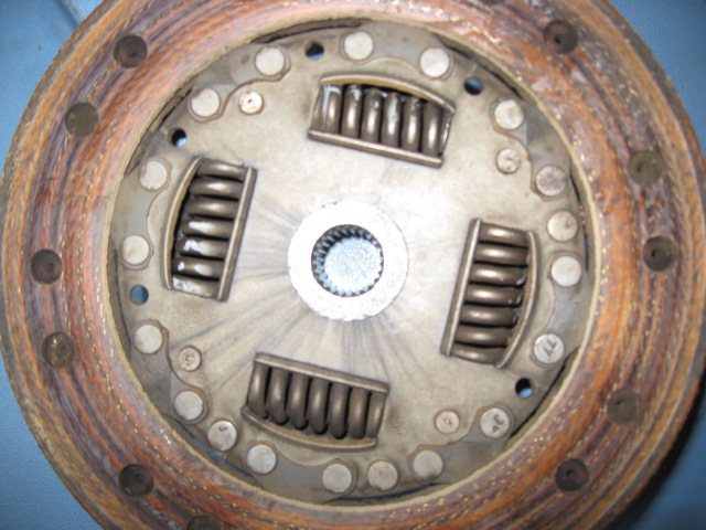

OK, now what? While in the process of removing the tranny I discovered there was no linkage bushing in the firewall, not even any crumbs! Figured I had found the problem. Went ahead and dropped trans as it needed a new input seal. I had already replaced the two forward bushings and had been waiting to replace rear two until I got to the seal job. With tranny on the floor I turned the mainshaft by hand in all 6 gears, very smooth, no noise. Now I'm sure it was the bushing. New seal in, new bushings in, linkage adjusted, fired it up with great confidence........noise still there!
I can select all gears with ease. The noise starts as soon as the clutch begins to engage, just like before. This time I set the e brake and began to engage clutch. A growling noise in all gears just as I begin to load the engine. Seems like the problem is not in the tranny as nothing is turning in there.
Clutch? Throwout bearing was smooth, clutch fork plastic bush was fine. I did not remove the p. plate. I had expected it to be oily and when it was dry I left it alone.
So, trans is coming out again and clutch will come out this time. Any guesses as to what I will find? Or am I looking in the wrong place?

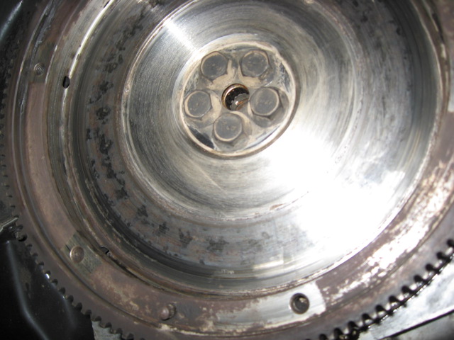

Jim also brought by his clutch and it didn't look too shiney. He said the flywheel looked worse. The noise seemed to be a rotational sound but he said the clutch wasn't slipping.

Porsche Rescue
Jul 10 2009, 01:08 PM
Pilot bearing feels good to the pinky finger, looks good. Main shaft smooth on bearing surface.

Flywheel has a deep groove at outer circumference. It will be turned and clutch replaced in the next week.

Here are some pics. One theory is that the center spline in the disc is turning in the disc. Unable to duplicate by hand with disc in a vise and a mainshaft in the spline. The spline does feel a bit loose in the disc however.
Click to view attachmentClick to view attachment
Katmanken
Jul 12 2009, 11:22 AM
Looks glazed to me. The clutch disk is a two piecer design that is designed to move a little to absorb shocks when it becomes engaged. Take the 4 springs out that surround the splined hub and the splined disk should rotate relative to the other disk with the clutch material riveted to it. Put them back in, and the springs absorb shocks when engaging. Don't take the springs out please. The description was meant to be educational.
