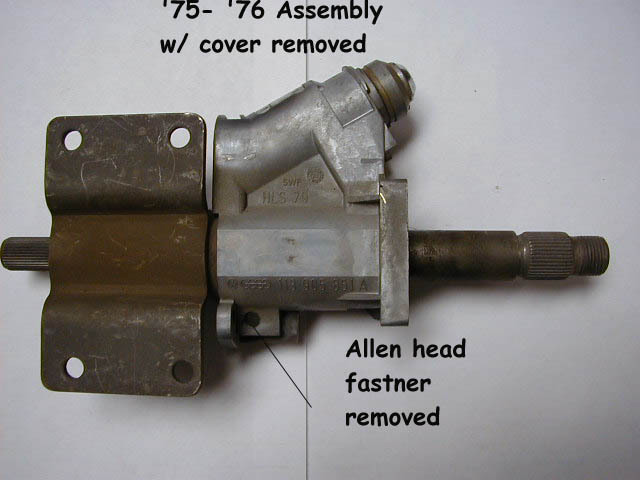

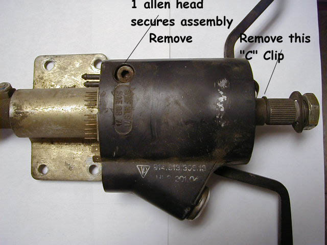

Step 1: Fastner and �C� clip removal

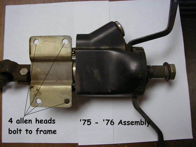

Disconnect negative terminal of battery prior to procedure. To get the steering locking pawl to release, the key needs to be inserted and turned. After removal of the steering wheel, the assembly looks like this.

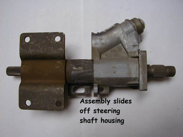

Step 2: Slide assembly off steering column

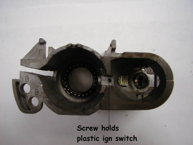

Slide the assembly towards the rear of the car. This may take some effort, but it will come off. The images show the decorative cover off. Once the assembly is off the steering column, the decorative cover can be pushed off to the rear (not neccessary). Also, the wires and washer hoses are long enough to not have to disconnect them to slide the assembly off the housing. Once you have exposed the rear of the housing simply pull the ignition connector off the switch. The screw that holds the plastic part can now be removed and the plastic part removed and replaced.
Now just reassemble in reverse order. Do not forget to replace the "C" clip. You can also order and replace the steering wheel bushing if you have play in your steering column.
