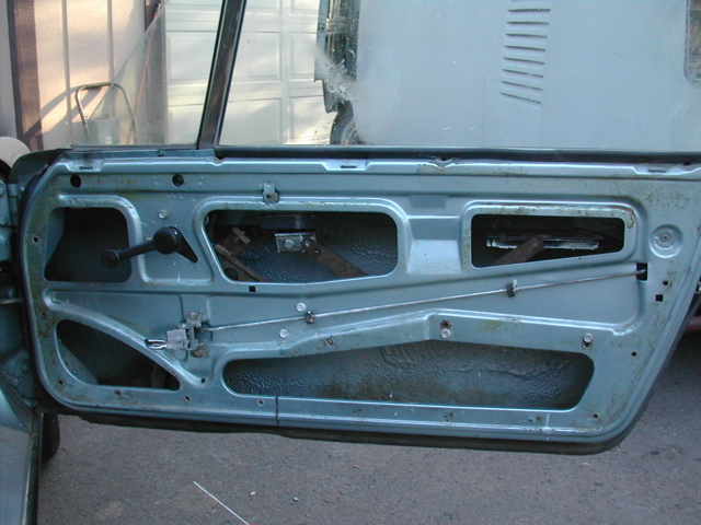

Start by taking off the door panel.
Next remove the interior door handle by unscrewing the two bolts with a 10 mm
socket. Unclip the rod by pulling the tab off the rod end and moving it out
of the way.

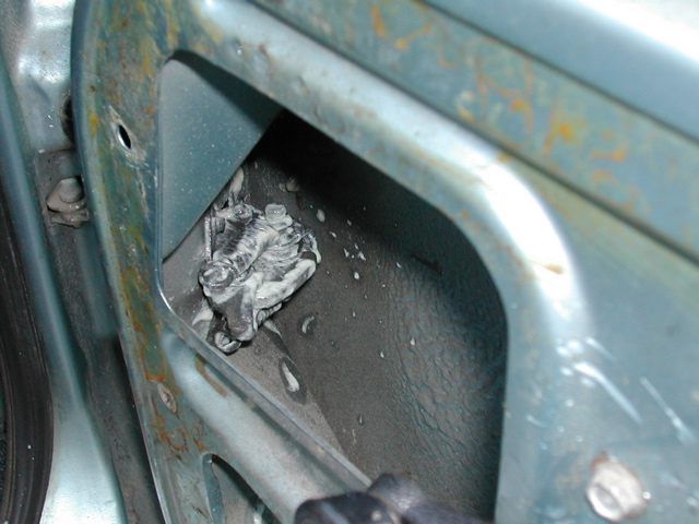

Once you have the interior handle free, clean off all the old grease with
the brake cleaner and the brush. Apply a liberal amount of white lithium
grease to all moving parts and reinstall.

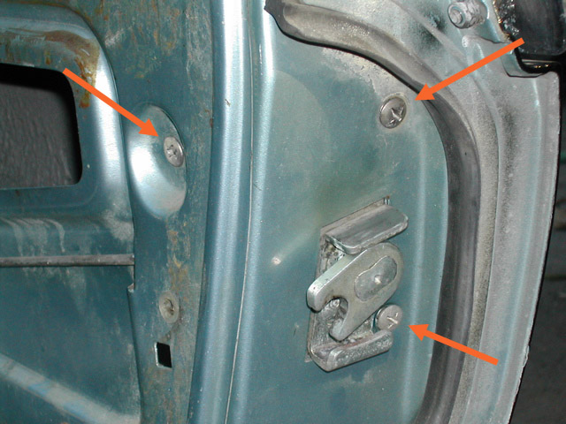

Remove the exterior door handle by removing the nut that hides behind
the handle flap on the outside edge of the door and using your 5 mm
allen tool to remove the bolt inside the door cavity.
Set the door handle aside for now. Remove the door latching mechanism
by first turning the actual latch so that it is straight up and down.
If you don't do this it won't fit through the rectangular hole in the
door and you'll wonder why you can't get it out. Remove the clip from
the rod that goes to the interior door handle. It's the same style of
clip as before. Remove the three phillips head bolts that hold the
mechanism in place.

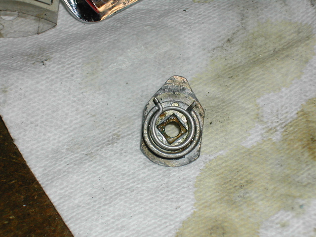

Now for the most complicated piece. On a clean work area with plenty of
good bright light place some white paper towels. Remove the phillips bolt
from the back of the latch and remove the cam. Be careful because
there is a spring back there. It probably won't go flying across the
room, but be careful anyway. Once the cam is off, put your key into
the lock cylinder and pull the cylinder out of the handle. Set the

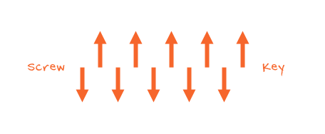

You'll notice that there are 10 plates in all, 5 on each side of the
cylinder. You'll also notice that the plates are off set, one side is
closer to the keyhole. This is important to remember so that you
don't forget which plate goes in where. If you put the plates in the
wrong holes, you won't be able to put the cylinder back into the
handle and you'll have to fiddle around with it for a lot longer
time. Print out the image below and use it to help you keep track of
the plates. Put the plates themselves at the end of each arrow. That
way when you put it back together there's no chance of confusion.

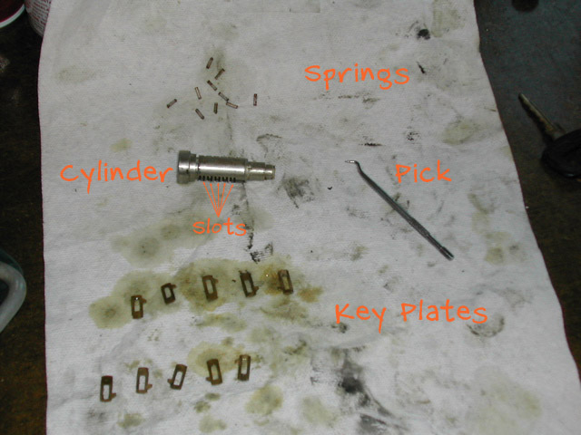

Carefully pull out the lock plates one by one and place them on their
appropriate places on the paper. Be extra careful of the small springs under
the plates. Sometimes the springs will stick to the plates and try to come out
at the same time. If they come out it's okay, just set them to the side,
just be careful not to loose them. Once you have all the plates out
use a pick to remove all the springs from their bores. You don't have
to keep the springs in order, they're all the same.
Carefully clean the old grease off the springs and lock plates with
brake cleaner. Be very careful with the springs. They're easy to drop
and hard to find. Once the plates and springs are clean, then clean
out the cylinder itself. When everything is clean, apply a liberal
amount of lithium grease to the cylinder and carefully place the
spring back into the bores on one side. You can use the pick again if
you have fat fingers. Place the appropriate plates into the slots.

cylinder over 180 degrees and try again. Install the spring as
pictured and screw the cam back onto the back of the cylinder and
reinstall the handle.

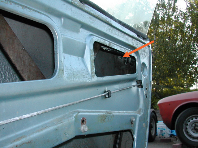

Take this opportunity to lube with window mechanisms. I'll explain the
late style (mid 73 and later). There are two sliders, one just below the
window glass and one bolted to the back of the door bracing that you
can't see. There is a ball joint under the window glass, the gear
that operates the mechanism is hard to see, but you can spray it with
the lithium. And finally there's a pivot point where the arms come
together. Spray everything that moves.
