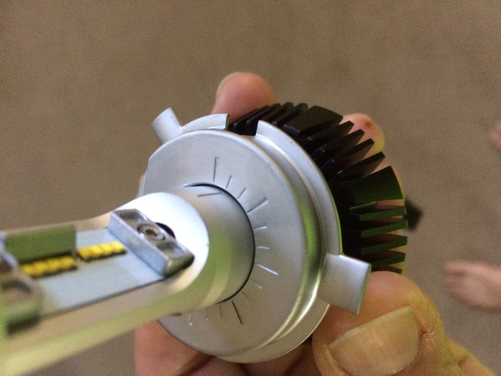

I have Hella H4s in my -6 and wanted to stay with a stock look yet upgrade my headlights to the same Kelvin color range as the Euro LED turn signal package I got from Spoke a while back (very nice, BTW). I wanted the white of the headlights to match the running lights in the bottom of the front markers. A color of about 6000K was what I was looking for.
After some research and reading some on the board here, I contacted VintagecarLEDs.com and told Thomas what I was looking for. Since I had the H4s with the glass lenses (and I really wanted to stay with them), he suggested that I look at his VC4000s and that if those sounded like what I wanted, he could sell me just the bulbs. Sounded good so I ordered a set.

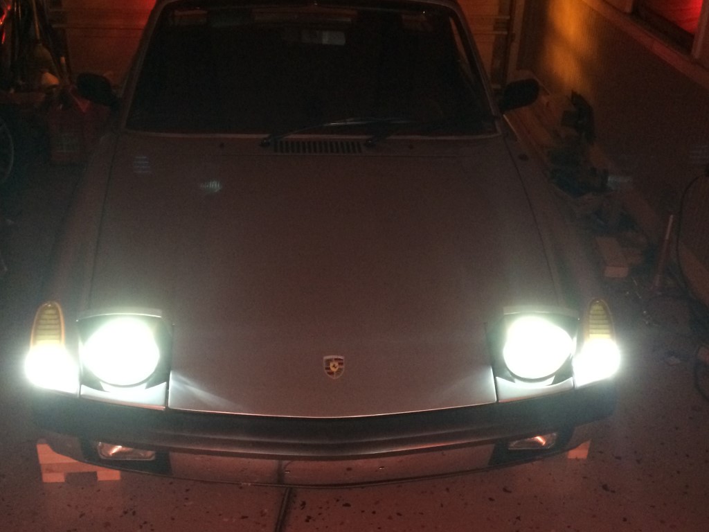

They shipped quickly and I got them installed before my trip up to the Okteenerfest. They went in easy (not any more than changing an H4 bulb besides the mounting of the small black box with the electronics) and plugged into the stock headlight wiring so no "difficult to undo" mod required. Additionally, the bulbs have an adjustable ring that changes the orientation of the bulb in the housing so when I was installing mine, I looked carefully at the stock H4 bulb and noted the orientation of the bulb element to the three -prong mounting ring that goes into the back of the housing. I then loosened the tiny allen set screw and adjusted the LED bulb to a similar "1 o'clock" position and installed them. The resulting beam had the same pattern as with the original bulbs - no need to even adjust the headlights.
Wow, what a difference. I agree with others on the board here. They work great and really improve night vision as well as lessening the load on the electrical system. I had several guys at Okteenerfest ask me about them so I contacted Thomas and he graciously agreed to offer 10% discount to all 914World member who order from 9/30/16 - 10/14/16. If you want to take advantage, just go to

Post pics of the beam pattern at night. There is no way for the LED bulbs to keep the same focal point as a filament. Might be ok, might actually be a downgrade aside from the color and lumens.
I put HID retrofit bulbs in H4 housings in a OHV. The filament shape changes from a grain of rice to a pea, but made no noticeable change to the light pattern.
You can buy 5-6000k color regular bulbs in 55w, 80w and 100w that will work as the housing was designed.

The VC4000s are a glass lens, Hella H4 copy that comes with the LED bulbs for those with sealed beam headlights now, according to Thomas. These are $209 minus the 10%.
As I said, if you already have H$ headlights, then you can email or call Thomas and he will sell you the LED bulbs to use in your housings for $149 minus 10%. This is what I bought.

Our replacement VC4000 bulbs (if you check the photos on the website) the CSP LED's are laid out inside the bulb at the same focal point as the old H4 Halogen filaments.
(exactly why the base is adjustable because regular H4 bulbs have a slight tilt to them.)
I could take some comparison photos tonight of our VC4000 LED compared to a H4 Halogen for yall.
It's pretty spot on.
