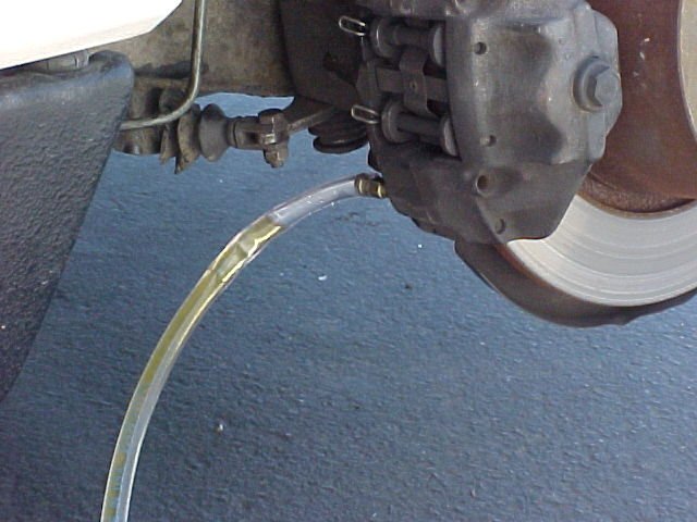

Here it is, the moment you've been waiting for.
You'll spend more time taking the wheels off and on, if you do this!
Install Speedbleeders.
Put 10' long clear vinyl tube over the bottom bleeder on the right rear.
Drape hose into brake reservoir after flushing system and secure with a zip tie.
Crack Speedbleeder 1/4 turn and pump until you see the bubles stop going by.
Tighten speed bleeder and move to upper bleeder.
Fold hose over on itself and secure with a clamp between calipers to keep the prime in the hose and avoid making a mess.
Repeat for left rear, right front and left front.
This is *TOO* easy.
KT

Aaron Cox   ummm... why are you using the BOTTOM bleeder... a...   Jun 24 2005, 02:56 PM
Part Pricer   http://www.914world.com/bbs2/h...   Jun 24 2005, 02:59 PM
trekkor   After the fluid starts going into the reservoir, s...   Jun 24 2005, 03:01 PM
trekkor   The long hose will reach all valves and pass by th...   Jun 24 2005, 03:08 PM
trekkor   Clamp it! When you are all done, just throw ...   Jun 24 2005, 03:12 PM

McMark   BLEED ALL NIPPLES. As Trekkor said, skipping some...   Jun 24 2005, 03:57 PM
trekkor   All done. Easy. Perfect. The first time. If you b...   Jun 24 2005, 08:09 PM
Travis Neff   Nice writeup and process there Trekkor. Next time...   Jun 24 2005, 08:13 PM
TimT   Trekkors method is a good one, as a nother example...   Jun 24 2005, 08:15 PM

qa1142   You really don't want to do it this way 1) moi...   Jun 25 2005, 08:07 AM
jim912928   I'm also not sure you want to do this. Alot o...   Jun 25 2005, 08:14 AM

trekkor   I have seen the fluid...Read "my fluid" at Streets...   Jun 25 2005, 09:51 AM
