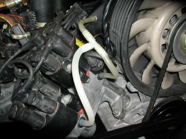

QUOTE(John @ May 31 2007, 10:47 PM) *
What's up with that fuel hose that clearly states:
NOT FOR FUEL INJECTION?
:BUSTED:
it's the wrong hose ...
(IMG:style_emoticons/default/rolleyes.gif) Andy

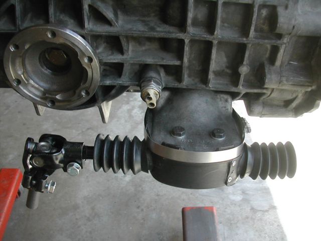

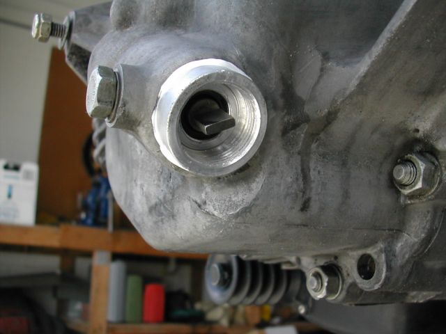

tranny cleanup is DONE ... (IMG:style_emoticons/default/piratenanner.gif)
- cleaned off all oil/grime
- new output flange seals
- new shifter console seals
- new speedo angle drive o-ring and seal
- new main shaft seal
- re-greased throwout bearing
- added JWest shifter kit
(IMG:style_emoticons/default/stirthepot.gif) Andy

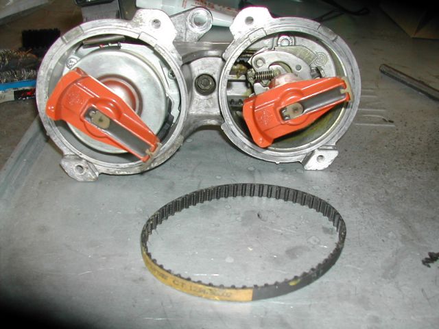

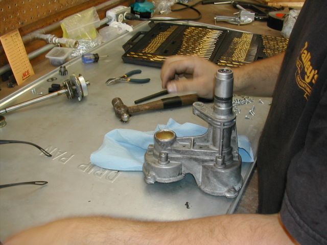

replaced the drive-belt in the twin-plug distributor. those are wear-items and should be replaced on a regular bases.
the ozon created by the spark eats away the rubber of the belt. belt failure can be catastrophic for your engine. (just ask Bill P. (IMG:style_emoticons/default/icon8.gif) )
i also added a additional vent-kit for the second dizzy. cheap insurance ..
(IMG:style_emoticons/default/smash.gif) Andy
McMark taking it apart:
done, with old belt as reference:
second vent-kit installed:

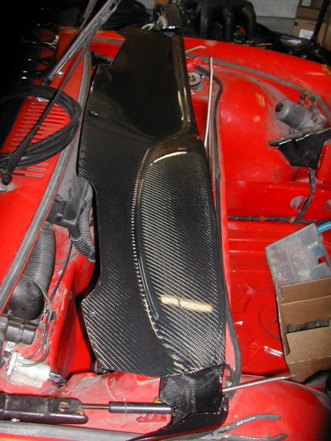

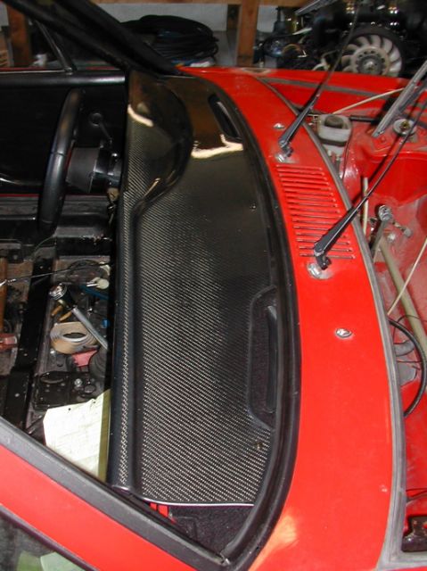

the 911 dash turned out really nice. the picture doesn't do it much justice ...
i wet-sanded the top to get it really smooth and then brandon from altissimo put a few coats of clear on it.
it turned out schweet and the CF has a really nice 3D texture to it ...
(IMG:style_emoticons/default/smilie_pokal.gif) Andy

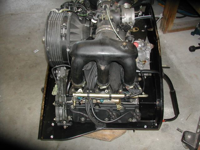

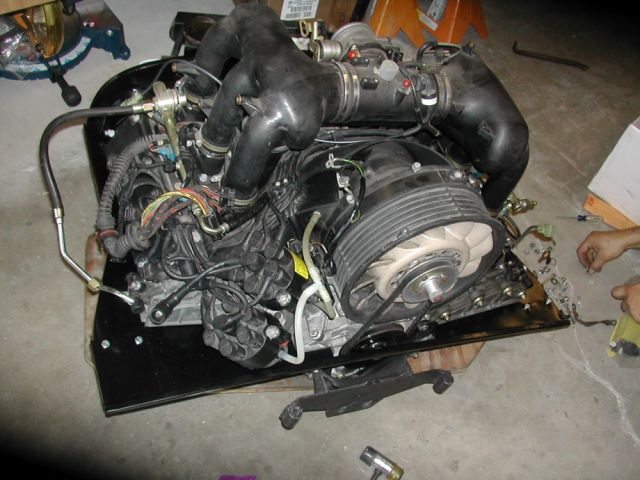

and the last for today, McMark powdercoated the engine tin and i put it on the motor ...
it looks VERY nice!
(IMG:style_emoticons/default/beerchug.gif) Andy

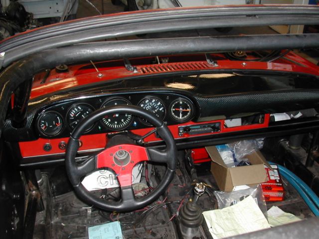

more updates ... (IMG:style_emoticons/default/drunk.gif)
- JWest shifter kit install, separate threads can be found here:
Part 1
Part 2
- freshly redone CF dash installed
- new windshield installed
- brakes bled
- fixed faulty adapter harness between the stock harness and the 3.6L engine
- reinstalled seatbelts and seats.
- worked out additional wiring issues (3.6L related)
- re-torqued all suspension components
- cleaned and sealed gas-tank
(IMG:style_emoticons/default/w00t2.gif) Andy

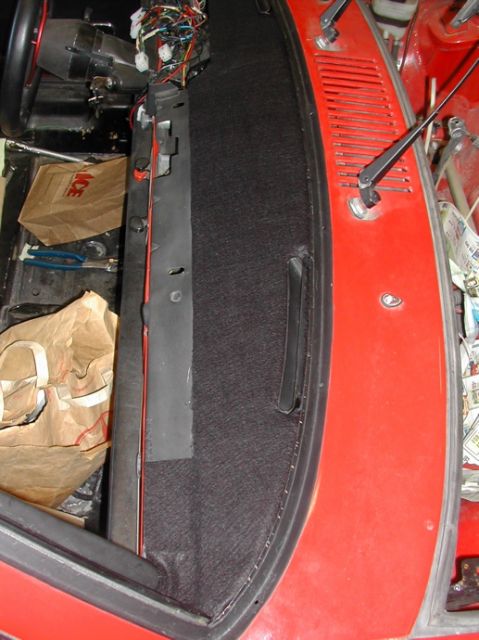

felt added to the dashframe to clean up the areas where the CF dash had to be cut for the rollcage ...
dash installed!
gauges installed!

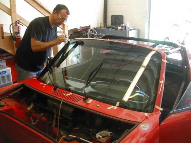

tim, the glass guy, installing the windshield:
beau-ti-ful (IMG:style_emoticons/default/wub.gif)
i went for the black rubber trim. here you can see it taped down until the gooy stuff has dried ...
prevents them edges from peeling off later.
