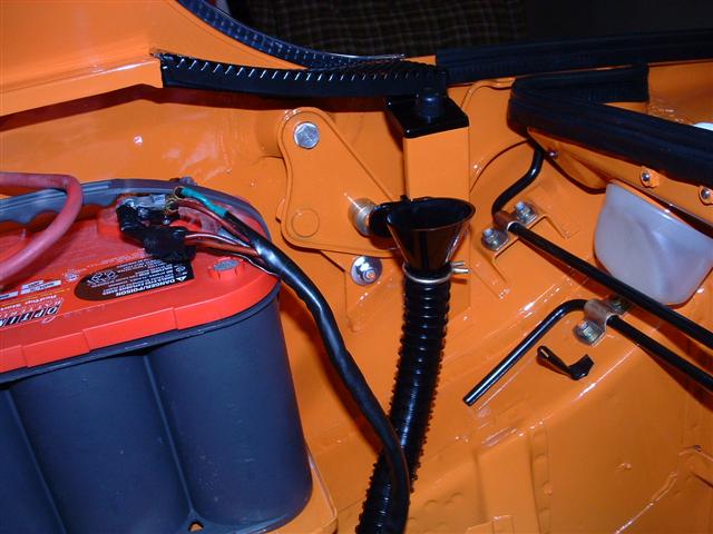

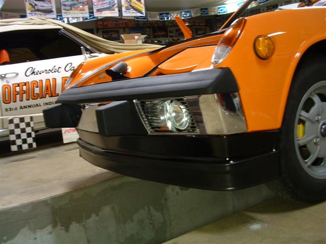

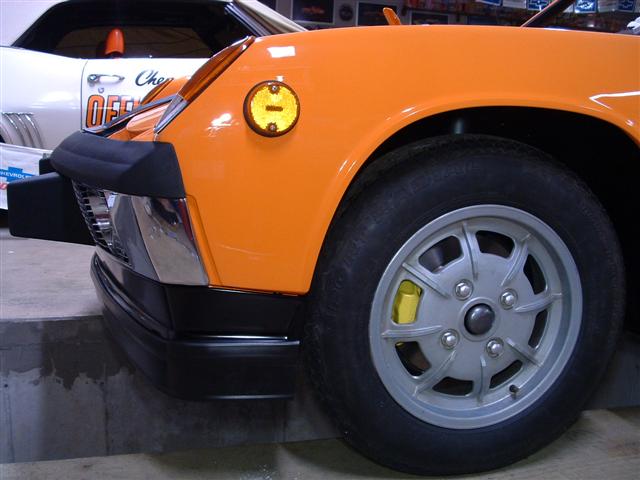

Not a tremendous amount of progress tonight, but significant progress. The front bumper is done, fog lights are aligned and done and the flex dam is completely fastened. Feels great to have these parts done!!!!!
Little bit by little bit....
I thought about not using the rubber spacer that goes between the fender and the front valence. The car that I took the flex dam off of didn't have it and it seemed to look just fine without it. But, I had to see what it looked like done the right way. I'm glad I did. it looks better with the rubber spacer in place! Plus it is done more right (IMG:http://www.914world.com/bbs2/html/emoticons/biggrin.gif)

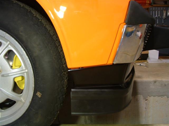

Pass side -nice lines (IMG:http://www.914world.com/bbs2/html/emoticons/laugh.gif)

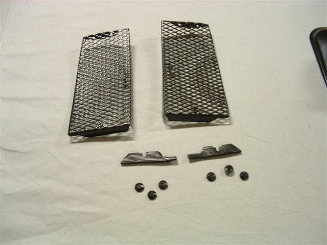

Back to car progress stuff...

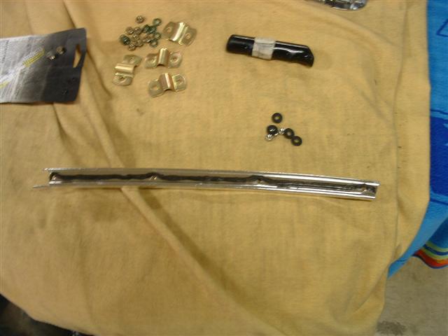

Here are the small side grills, seals and fasteners

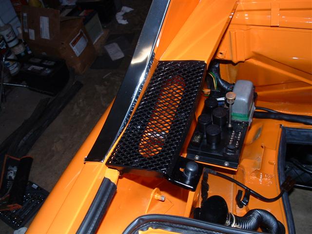

Member No.: 261
installed

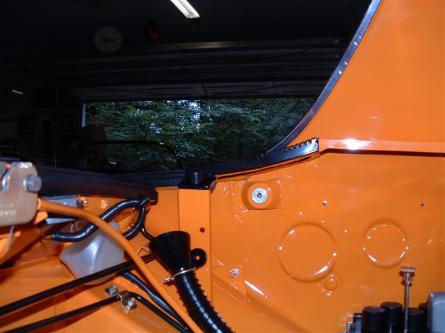

Member No.: 261

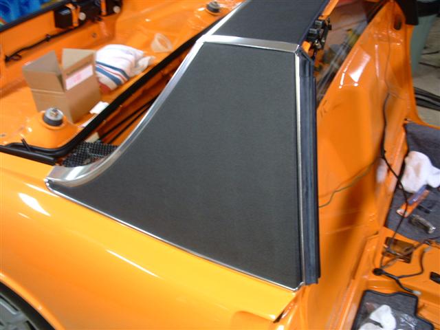

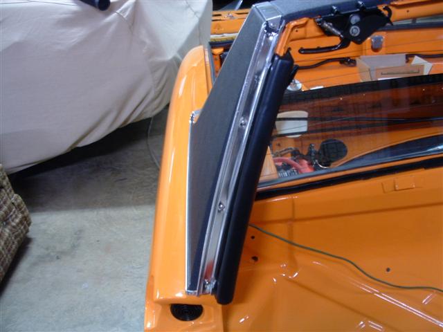

I finished up the trim around the sail panels. I used the black butyl material that is used for windshield installation to create the seal on the back side of the AL trim pieces.
Doug Leggins
post Sep 21 2005, 04:50 PM
Post #53
Posts: 1,358
Joined: 6-February 03
From: Nashville, Indiana
Member No.: 261
AL strip installed
Doug Leggins
post Sep 21 2005, 04:51 PM
Post #54
Posts: 1,358
Member No.: 261
Sail panel trim complete (IMG:http://www.914world.com/bbs2/html/emoticons/biggrin.gif)

Member No.: 261

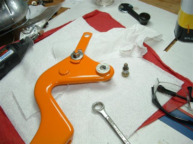

I'm cleaning up every part.
Left before, right after... (IMG:http://www.914world.com/bbs2/html/emoticons/wacko.gif)

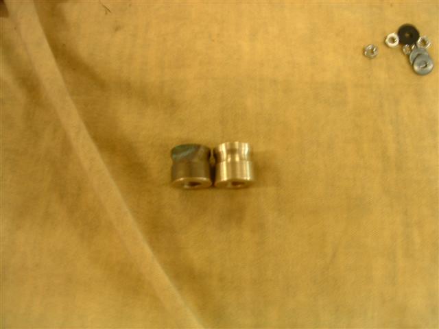

Member No.: 261

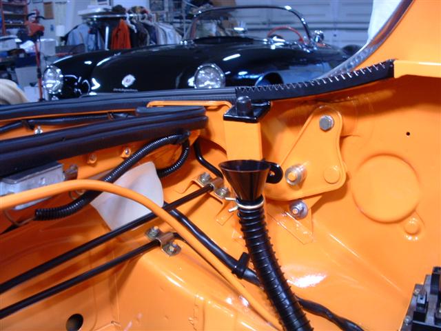

I removed the paint from the rear trunk hinge pivot points and lubed them up well.
Doug Leggins
post Sep 21 2005, 04:58 PM
Post #57
Posts: 1,358
Member No.: 261
pivot point, paint removed and lubed
Doug Leggins
post Sep 21 2005, 05:00 PM
Post #58
Posts: 1,358
Member No.: 261

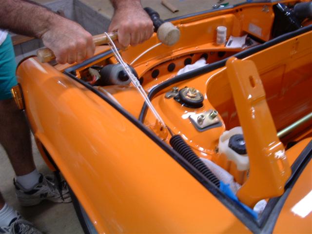

Hinge installed.
Getting the torsion bars in place looks to be just about impossible (IMG:http://www.914world.com/bbs2/html/emoticons/confused24.gif)
Let me know if you have a good method for hooking them behind the rollers.
Member No.: 261
Installed the driver's side front trunk hinge. Fairly easy when using this set up. I did have a helper press the spring hook down into position when I had it stretched to the right place.
