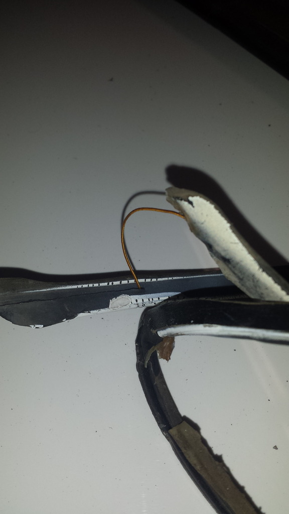

Interesting. Many sites say go with or offer 3/8s-9.5mm butyl tape but it seems the factory used 8mm or closer to 5/16. I just used the widely recommended 3/8s and it seems too thick to me. I could not get it to spread as far as the original had as evidenced by some residual staining on the window sill. I could barely get the glass to sit on the rubber setting blocks as the butyl was so thick it left little room even with the small relief channel built into the bottom of the window frame for the adhesive.
I used a heat gun to make sure it was pliable but I couldn't compress it enough to get the glass to remate up with the lower outside rubber strip. It left more of a gap than I would have liked on the outside, filled of course with butyl. Measuring the original gasket I removed, it was compressed about 2,5 to maybe 3mm. Using a 9.5mm tape that many recommend, even if you could compress it by half, your still way above the original spec. Doing it again I would use 5/16s for sure

You can stretch it to make desired thickness, so the difference between 8.5 and 9mm is easily accommodated.

I hear you, but if too much, it has to go somewhere and when pushing on it through glass, not the easiest thing. Would have liked at shot at running voltage through the original to get it nice and pliable!
