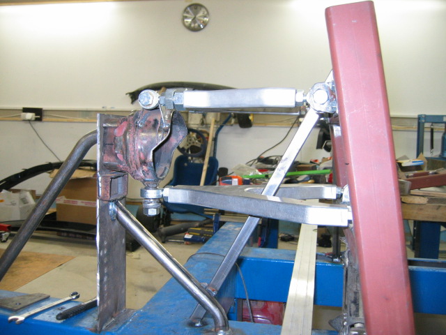

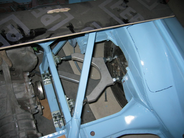

I'm thinking something along these lines:

Where are those photos from?

Wow, somebody did it! (or at least started doing it)
I'm skeptical that by the time you make the compromises necessary to get it into the available space you would have any measurable performance benefit. Of course if you go mega-widebody anything is possible (IMG:style_emoticons/default/smile.gif)

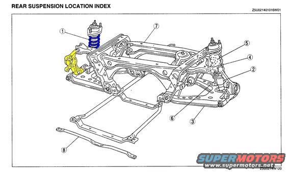

I've thought of just grabbing one of these, some 1" 16 gauge and a welder. Move everything that's in the way and stick it in:
(IMG:http://www.914world.com/bbs2/uploads_offsite/www.supermotors.net-9685-1304736318.1.jpg)
It's a touch wider than stock track but should fit nicely under flares. $300 at the local pick and pull. Maybe after the engine conversion is done.

So what is that suspension from? I cant really tell if it has provisions for the CV Shafts or what? But Im old and blind too....

Looks like a Miata rear suspension

Yup, Miata. It's been a while since I worked on 'em, but from memory they should come pretty close to fitting around the 901 tranny. The locost guys have been working with miata rear suspension and worked up their own rear framing diagrams. I'll see if I can't find them.
Hubs might get a bit sketchy...
I have accurate drawings of the Miata front and rear suspensions in the drawings section of my website.

QUOTE(Chris Hamilton @ May 6 2011, 06:00 PM) *
Think I got them from this site some time ago?
I'm trying to look at other cars to figure out how to design it...trying to find software online that is cheap and free with no/minimal luck. Theres Wingeo3 but susprog3 but they are not free/cheap.
Basically plan so far is to modify the trailing arm as in the pics and figure out suspension geometry from there...legth/angle of upper and lower control arms in order to get good handling. Was hoping someone may have gone this route and have some data.
Those pics are from member Slugmika's build of his 914 race car. The thread is here: slugmika build
Has some interesting fabrication and suspension stuff on that car.
