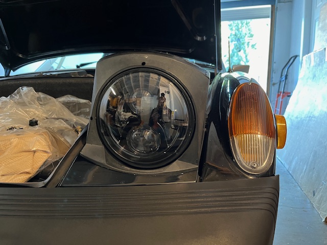

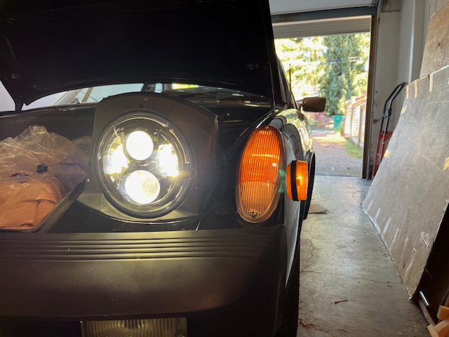

Install of the JW Speaker 0554941 headlights complete.
I had to enlarge the opening of the back of the bucket that the headlight sits in a bit to all the headlight to sit flush, but other than that it fits great. Headlights are also made in the US.
