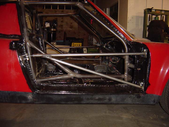

cheers found what i wanted ( pic below ) i did a search under door brace but found nothing ? i must be doing the search wrong.
Andy ; this layout is exactly what i had drawn to build , so good to know someone has already done it.

I think going to the seat belt anchor up higher is a stronger solution and allows less flex in the door opening.

No pics but the ones i have used go from the upper front door mount to the door latch and from the upper front door mount to the upper seatbelt mounting in the rollbar.
That makes for a nice triangle while leaving enough room to work on the longs or floors.
If your car is very rusted, you can also add a X brace between the front targa top latch mounts and the rear targa top latch mounts.
If possible, make the braces adjustable so you can expand/contract them if needed.

That was just for welding the cage.
On a rotisserie, do that plus go from the upper front mount to the top seatbelt mount on the targa bar.
