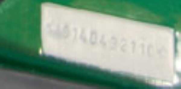

VIN is:

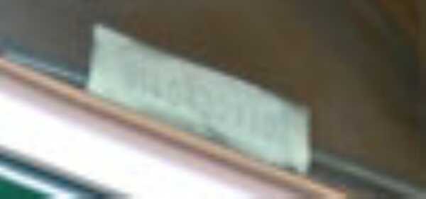

windshield tag

QUOTE(gms @ Feb 27 2012, 07:18 PM) *
VIN is:
914.043.2110
http://www.914club.com/bbs2/index.php?showtopic=66486

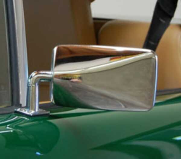

late model mirror

Other early/late inconsistencies, looks like a late non folding parking brake and the rear view mirror should be the thin early one.
