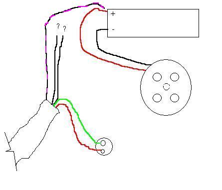

ok so know it should look like this. but were dose the black wires go? i now know that the 16 ga is for the tach but were does it conect to. Please forgive me for being an idiot. And sorry about the crude drawing….

By the looks of the drawing the car should run. Petronics red + black - Oil idiot light green red stripe. the picture indicated oil pressure/idiot light sending unit. Does the pressure gauge work?
Other than that I can tell you the tach won't work, one of the 2 black wires goes to the tach. I sugest once you get it to start and run touch either of the black wires tothe negative of the coil see which one activates the tach. The other black wires is something left over in the harness from the fuel injection.

The other wire should/could be for the thermotime sensor mounted just under the plenum (controls cold start valve).

I have a 72 with carbs and a pertronix. I also have a MSD and tach adapter, so they are wired in also.
The black wire with purple stripe is for the tach signal and goes to the negative side of the coil.
I have 4 wires coming out of the harness.
1- blk/pu - If i didn't have the tach adapter and MSD, I would have this running to the negative side of the coil
2- wht not hooked up to anything
3- green with red stripe to oil pressure switch
4- black with red stripe - If I didn't have the tach adapter and MSD, I would have this one running to the positive side of the coil.
Pertronix - red goes to coil positive, black goes to coil negative.
