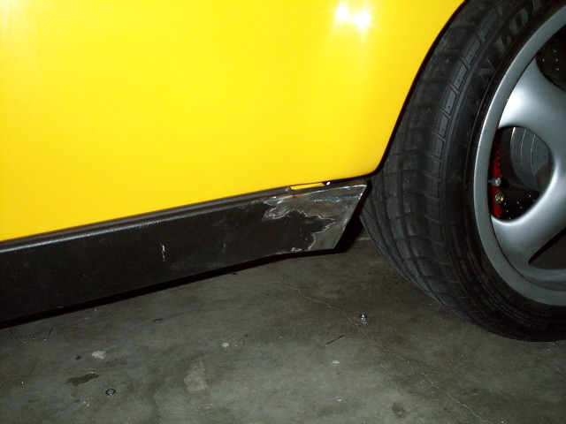

Here's a pretty simple way to flare your steel rockers. They come out pretty nice.
13 pictures to follow:

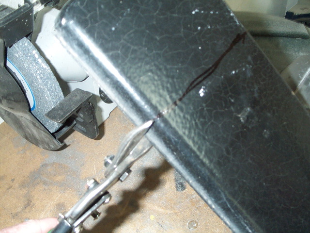

Start by marking a line on the rockers that matches the flare on the car:

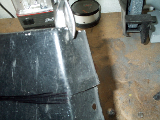

snip the top and bottom lips:

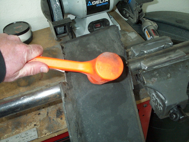

Bend along the lines:

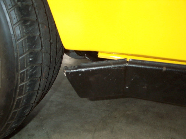

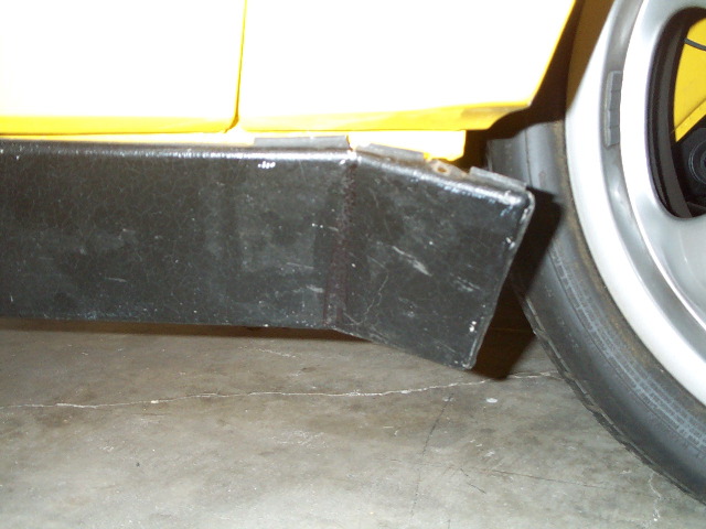

Bending the rocker outward creates a gap at the top:

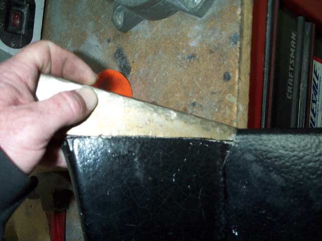

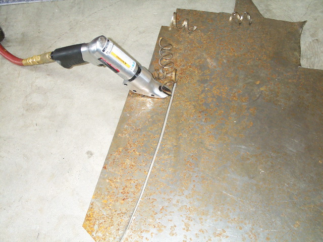

Cut some metal and put a 90 degree lip in it:

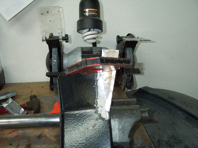

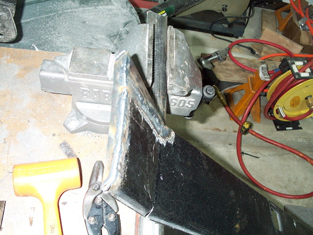

Prep for welding:

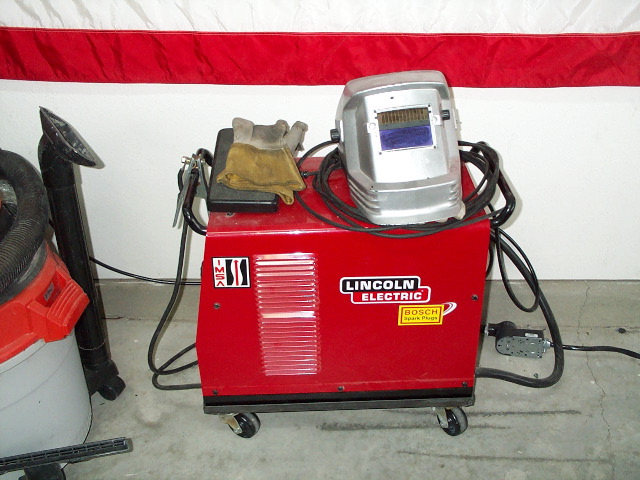

Say hello to my little friend:

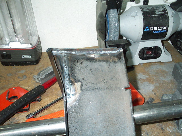

Last one.
Cut out some metal to make an end cap and weld it up:
The body man will give them a little beating to soften the bend.

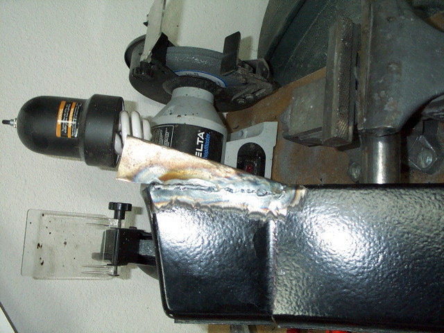

The V cut at the bottom is welded now as well.
The real last one:

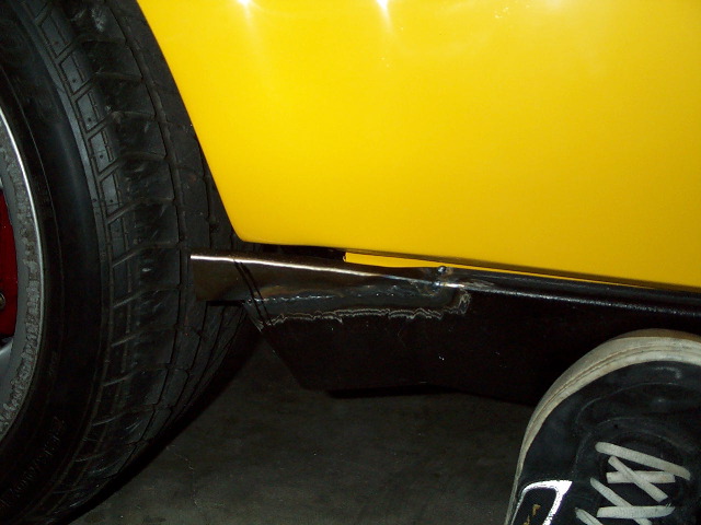

Third last one.
Here's the DS rear on the car, basically finished:

Nice job

This is EXACTLY why I'm making up steel rocker panel shapes with blank ends. $45.00 each side.

Thanks for going to all the trouble to write this up. Ill start on mine next week.
I see a classic thread in the making.

Joe, Good job. Your car looks great and is coming along very nicely.

Really nice Joe.
