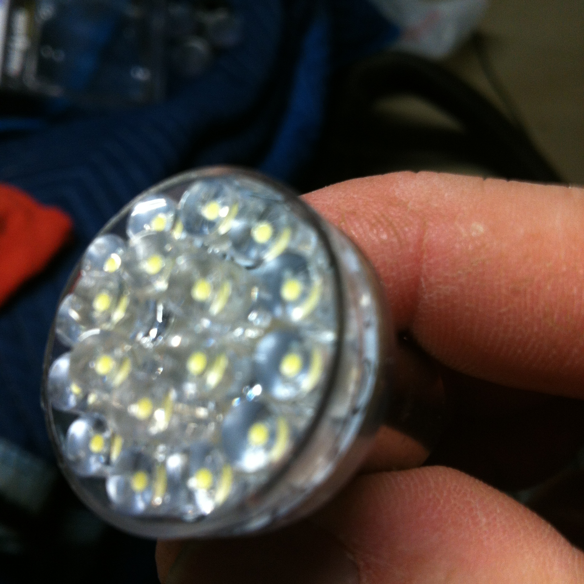

(2) Reverse Light bulbs – 1156 Cool White 100 degree [1156-W24-WV] $6.95
https://www.superbrightleds.com/moreinfo/s-.../#/attributes/1
Left side is the old bulb, new LED on right

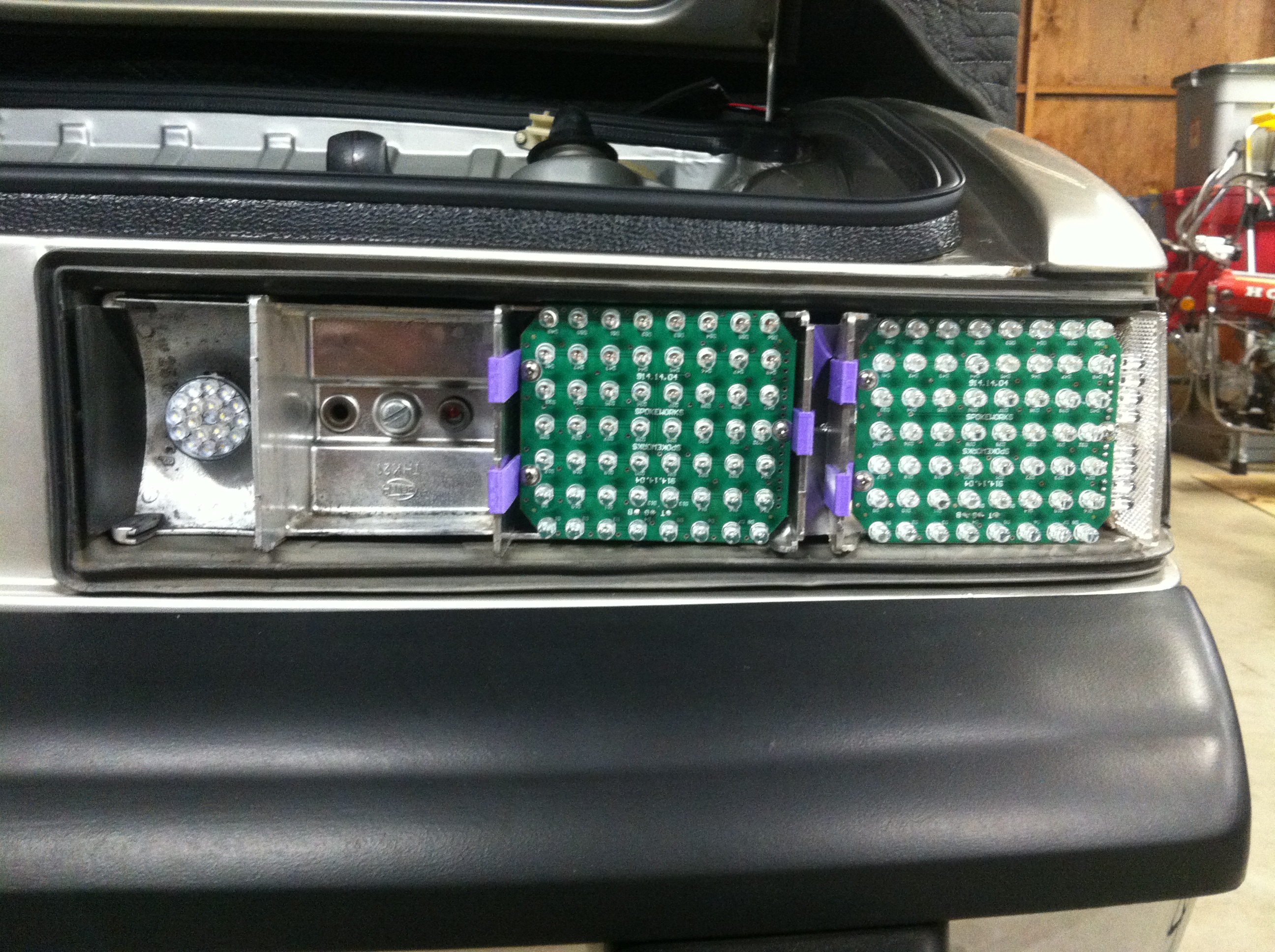

Front complete with Spoke's LED boards:
Attached ImageAttached Image

Rear of car complete:
(IMG:style_emoticons/default/aktion035.gif)
The pictures don't do them justice, they're very bright and clear, great upgrade and overall it took maybe an hour to complete! (IMG:style_emoticons/default/beer3.gif)
