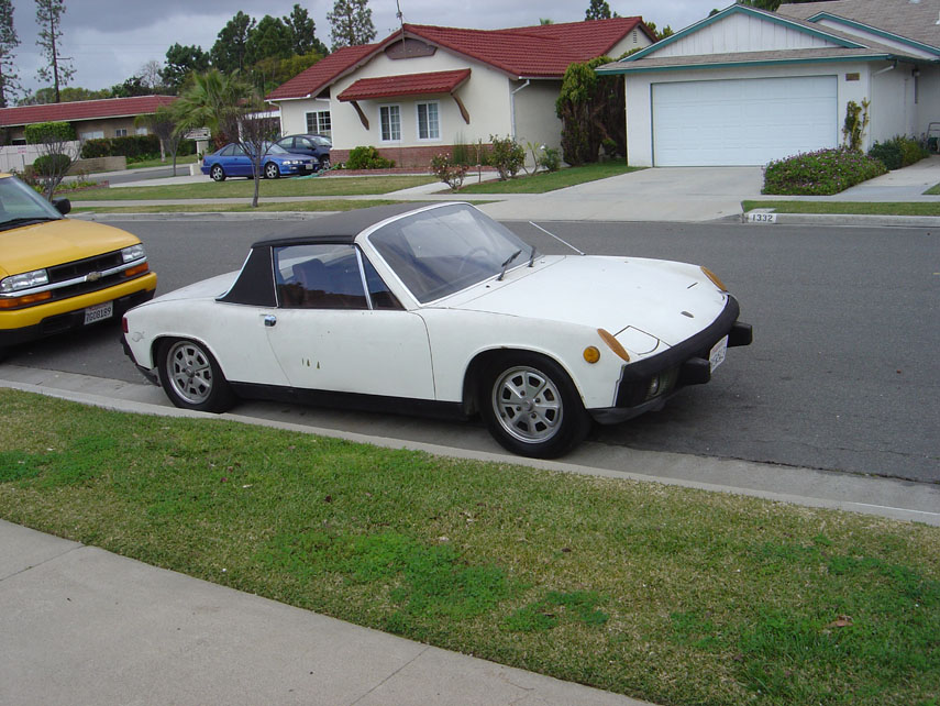

Oh, This is what the car looks like now, I am starting on it tongiht.
