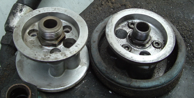

sixnotfour
post Sep 5 2005, 12:56 PM
Posts: 10,906
Joined: 12-September 04
Member No.: 2,744
Left OC-54 Right OC-61
